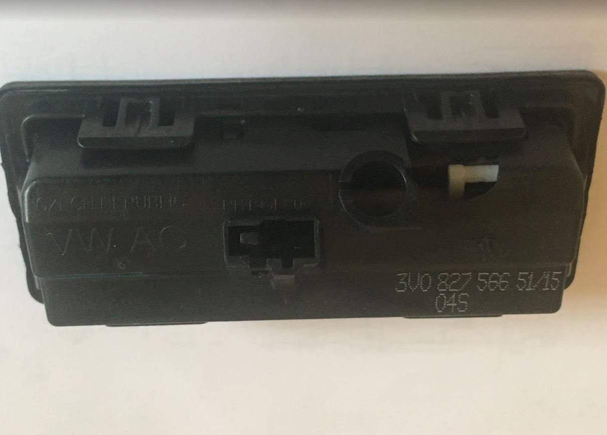

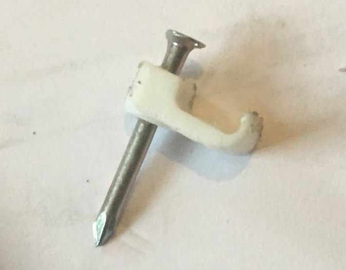

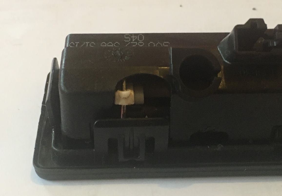

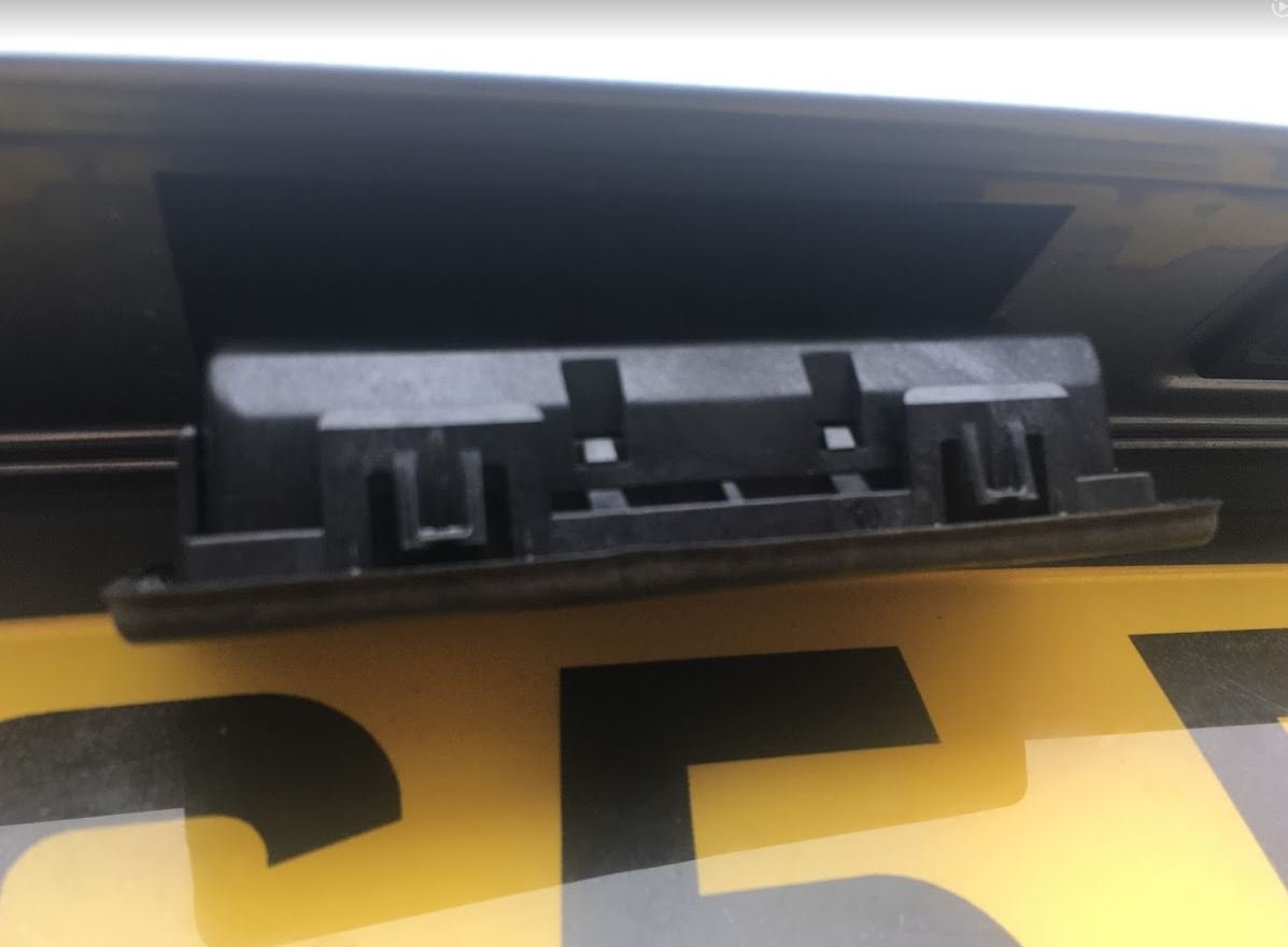

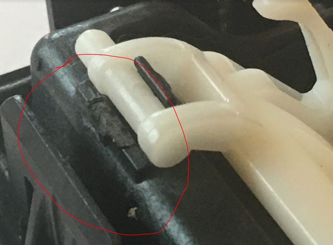

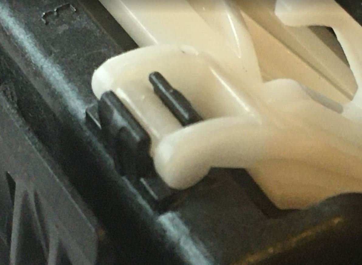

Quick update. The main dealer quoted me over £100 for a new part - couldn't accept that. I believe there are cheaper parts on Ebay for around £40. I went for a bodge. Don't know how long it will last but this is what I did:- 1. Button assembly removed from tailgate by prising away from panel with a screwdriver. 2. Connector unclipped to allow assembly to be completely removed. 3. Button package dis-assembled (not easy, did break a few retaining clips along the way but not enough to cause a problem) 4. Believe the failure was caused by broken plastic around the white hinge (see photo). This causes the button not to spring back properly after being pressed. 5. Microswitch itself tested and found to be fine. 6. Fashioned a new hinge housing using a cable clip (nail bent to force cable clip in position between housing and white hinge). 7. Reassembled and switch springs back properly after being pressed. 8. Tested on car and works fine after about 100 cycles.

Hi, I was referring to the button on the tailgate itself. I don't have a TAILGATE OPEN button on the centre console - just a CENTRAL LOCKING LOCK/UNLOCK button. The car is a hatchback and have been driven a 2-3 days per week over the last few months. I am sure the battery is healthy. From my limited diagnostics skills, I believe the locking and unlocking function is working fine. I believe the tailgate release mechanism is OK. It is just the tailgate release button on the tailgate handle that is faulty. I was a bit worried as I am going on holiday next week with alot of luggage. However, the tailgate open button on the key fob does release the tailgate so I can still use the boot. I will update this post if I manage to fix it. Slightly disappointed as I would expect this sort of fault on a 10+ year old car, not a 4 year old one. That and the chrome strip coming off the window after a few years does grate a bit. Maybe the Quality department need to take note.
