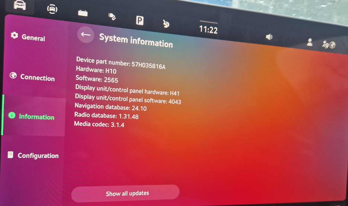

  9. No, as far as I know this is all quite obscure. Going back over posts on this forum, it appears that the dealer software updates don't change the software version you see on your display. That software version seems 'locked' to the car and related to the production date, is my guess. Having said this, I was getting all the assist errors just after the car was delivered by the dealer (early December). They then did a reset -not sure what that was- and since then no errors. So the reset seems to have done the job.
  10. If the error is 'front sensor obscured', it was probably a genuine error: I've had it the past weeks a few times when it has been cold and there is frost blocking the sensor windows. For me, the error went away when I cleaned the sensor area at the top of the windscreen and on the front grille (radar box cover/grille camera). Hope it helps. (Outside these genuine error messages, I have not had the assist errors in the last ~3 months - software appears stable since my dealer did an update mid December. The update did not change the software version though - same as others are reporting. I am on 'still' on 2565).
