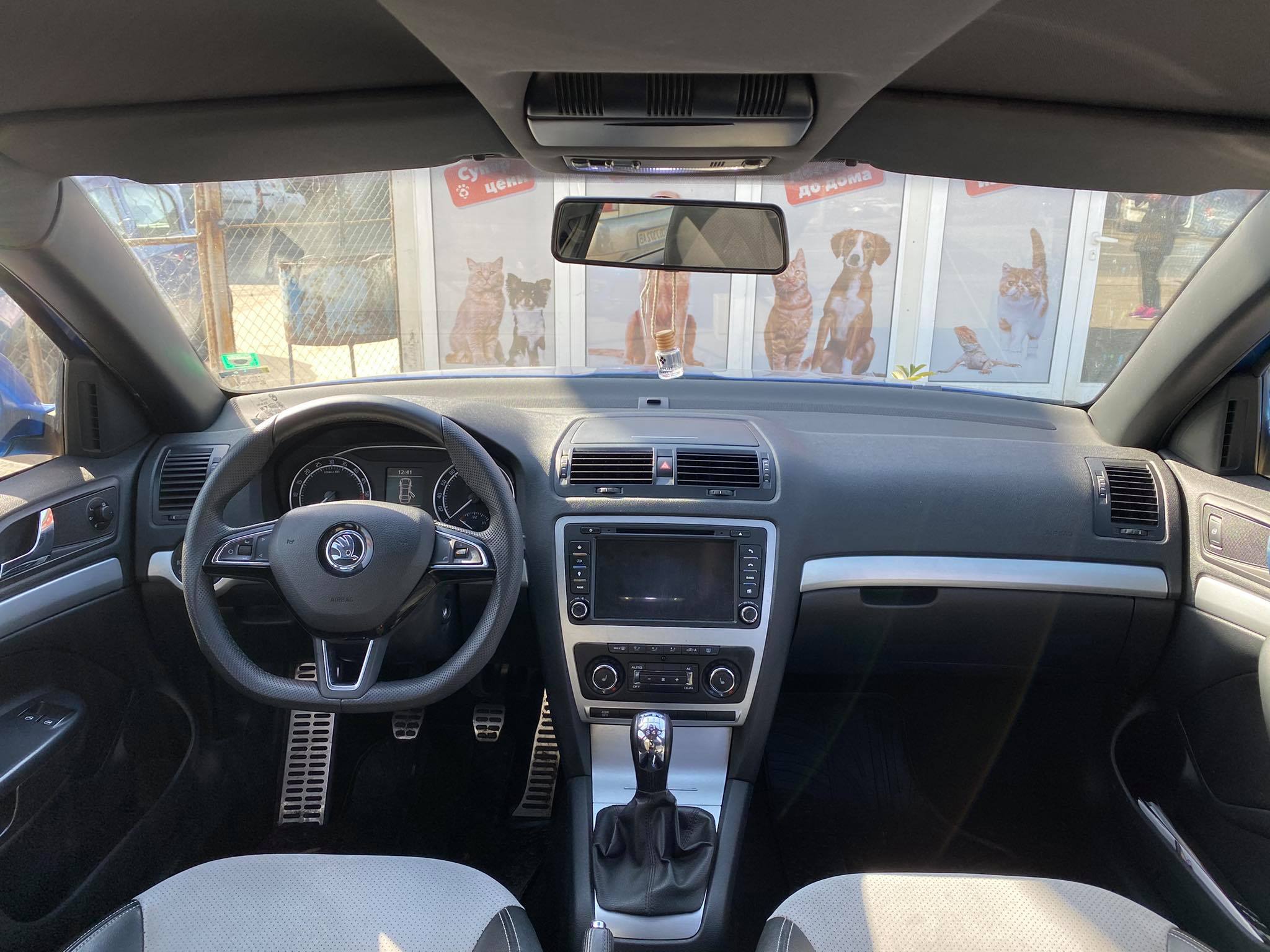

  6. Retrofit flat bottom steering wheel on Octavia 2 FL vRS: - steering wheel from Citigo - buttons and airbag from Superb 2 FL - control module for MSW Superb 2 FL is the ultimate donor for Octavia 2. Everething works: backlight, buttons.
