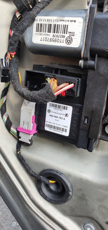

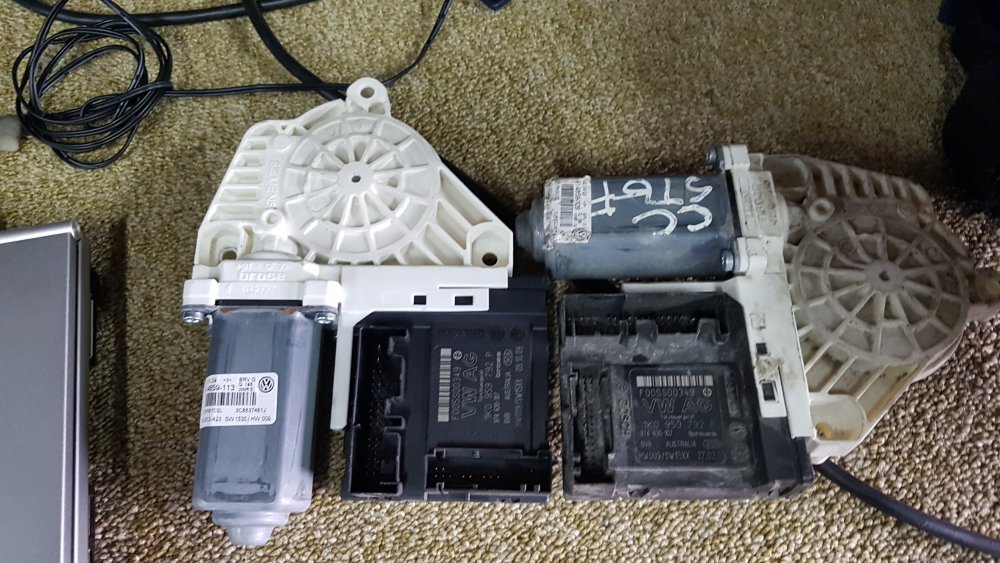

  • If anyone is looking to do this mod I have just fitted folding mirrors to my FL VRS and used the following door modules   Drivers - 1T0959701N Passengers - 1T0959702N
  • Look at address 42 and 52:   Address 42: Door Elect, Driver        Labels: 1K0-959-701-MAX3.lbl    Part No SW: 1T0 959 701 AA    HW: 1T0 959 701 AA    Component: Tuer-SG         009 2120

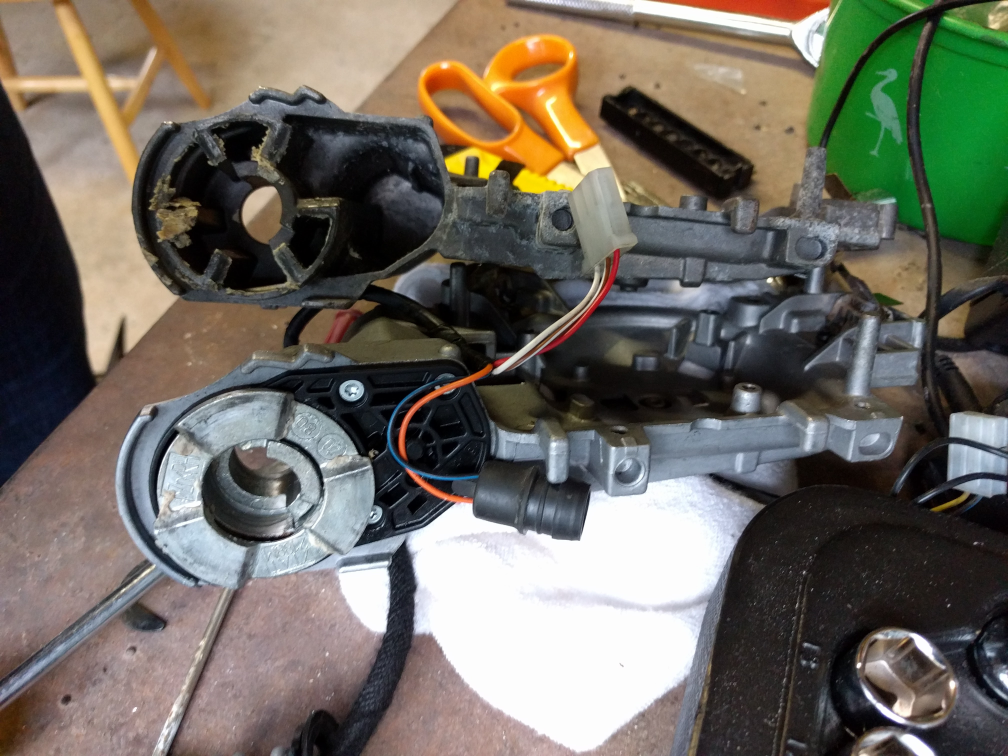

You probably would have noticed the motors when you fitted them, they really aren't discrete once the cover is off.

For proper reverse dip, it's a different mirror motor in the wing mirror. It has 7 pins rather than 3 if I remember correctly. If you have the modules mentioned in the first post it'll work :)

It's 7 wires on the multiplug that connects to the mirror motor in the wing mirror.
At a guess it'll be between 9 and 11 on the multiplug to the door controller - 7 for the mirror motor, 2 for the puddle light, 2 for the indicator, they might share grounds.

if the mirror glass motor has a blue plug the you have a motor for mirror dip

I have a 2012 VRS I'd like to add this too. I think I have the base door modules, do the powerfold modules plug straight in (plus coding of course) without the need for additional wiring?
Yup, no extra wiring required.

I second this, used the exact same door controllers / modules in my FL VRS and sourced the door mirrors from ebay that already were folding mirrors. It was a straight swap no wiring or modifications required to the driver side mirror. Once fitted coded the mirrors and worked perfectly.
Is there an easy way to check module part numbers via VCDS?  For furture reference I'd like to know if I could do this mod without having to pull the door cards off unnecessarily.
Address 52: Door Elect, Pass.        Labels: 1K0-959-702-MAX3.lbl
   Part No SW: 1T0 959 702 S    HW: 1T0 959 702 S
