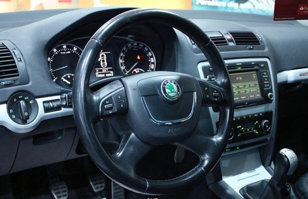

OK, here's the story...
My wife has been looking at a few different cars but she has decided on the Octavia SCOUT Mk-2 (2010-2013) 1Z
but she says that the steering wheel is so very ugly and wonders if it can be exchanged for something nicer.

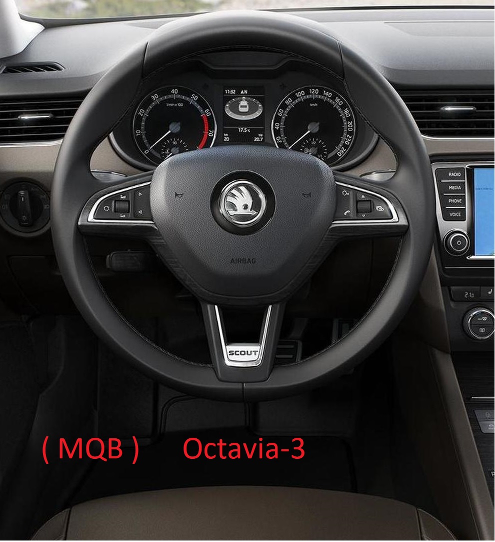

:thumbdown: Sounds way too complicated to take the wheel of a MQB-based vehicles such as Octavia Mk-3  :thumbdown:

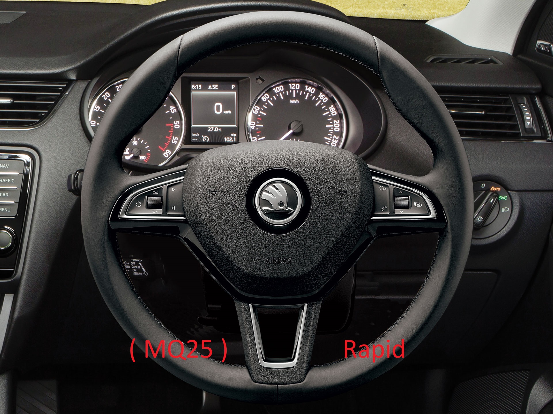

One of these two steering wheels below is the one she wants in her car.
Which of them is easiest to adapt so that everything works together with the PQ35 platform ?

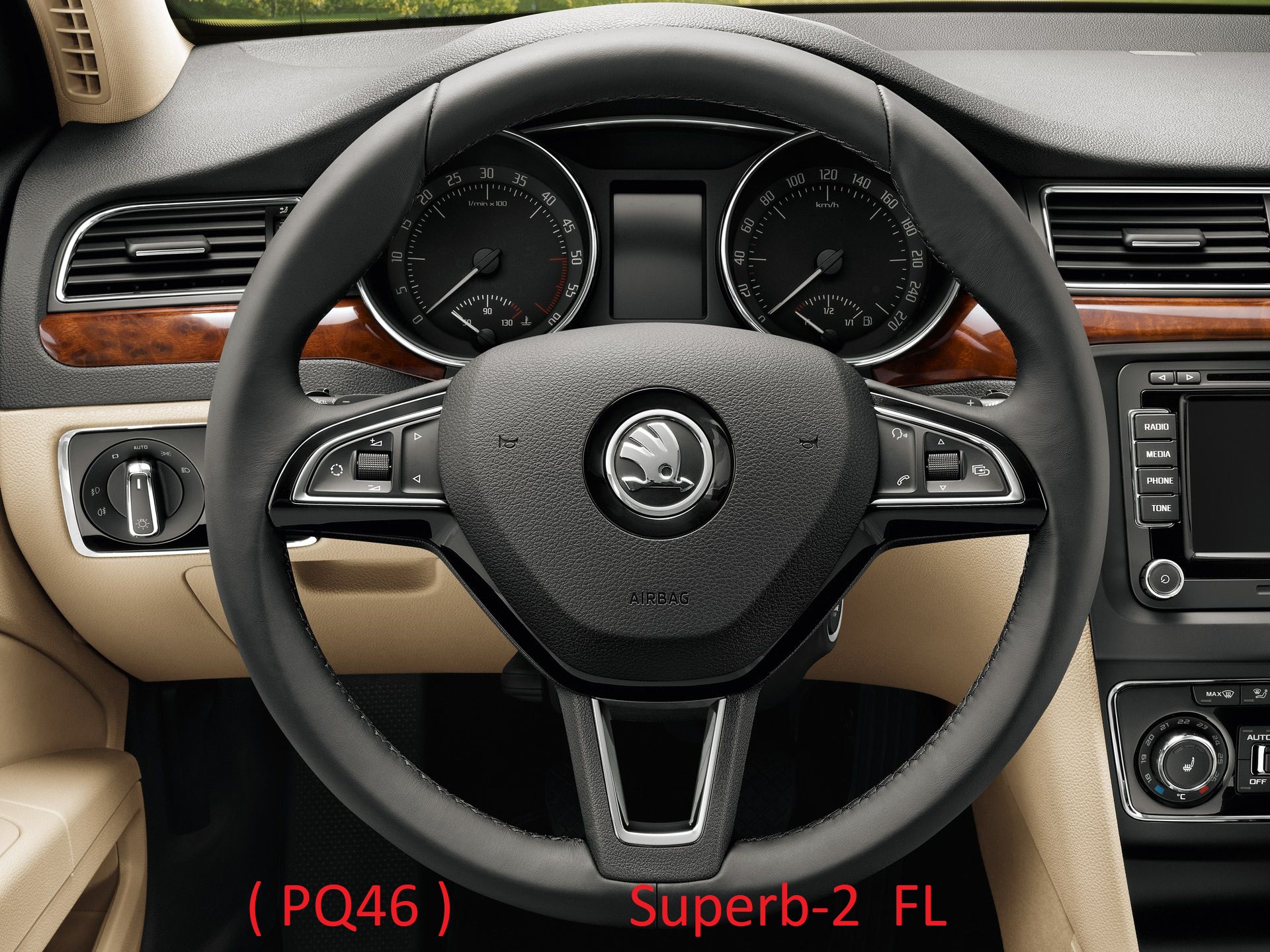

So if the steering wheel below fits straight on ( Plug-N-Play ) and all the features are the same what needs to be done in detail to convert ?
Is the diameter of the Superb-2 FL steering wheel the same as the Octavia-2 FL steering wheel ?

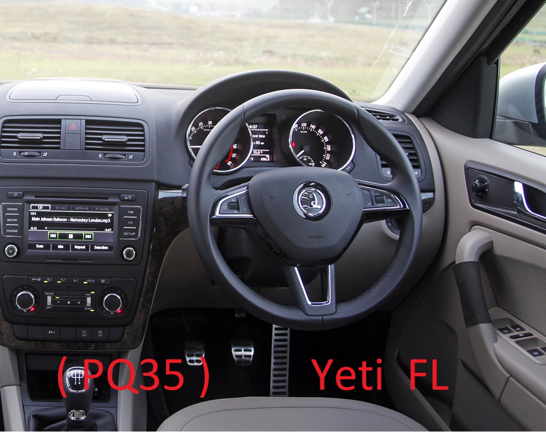

:thinking:  Since it appears that the YETI is also a PQ35 based car,
perhaps it's the best chance that the YETI steering wheel fits the Octavia-2 FL with as little modification as possible.........
:thinking:  Or ?  :thinking:
:thinking:  Are they ( Yeti FL <---> Octavia-2 FL ) also based on the same structure of the electrical systems ?  :thinking:
( electrical architecture )
A MK2 FL Octavia, MK2 FL Superb and FL Yeti are  very similar electronically.
The steering wheel from either the MK2 FL Superb or FL Yeti should be fine in a MK2 FL Octavia.
No idea about the diameter, it didn't feel noticeably larger or smaller to me.

:thumbup: Ok, then it's decided that I'm going to try to convert a steering wheel from YETI FL to my wife's Octavia-2 FL.
....This is because YETI seems to be the closest relative to Octavia-2,  which should mean the least problems ( I hope ) :cool:
:beer: It would really be good/nice if you could explain in detail step by step what needs to be done and what needs to be obtained.  :thinking:
I have my own VCDS if something needs to be coded )
