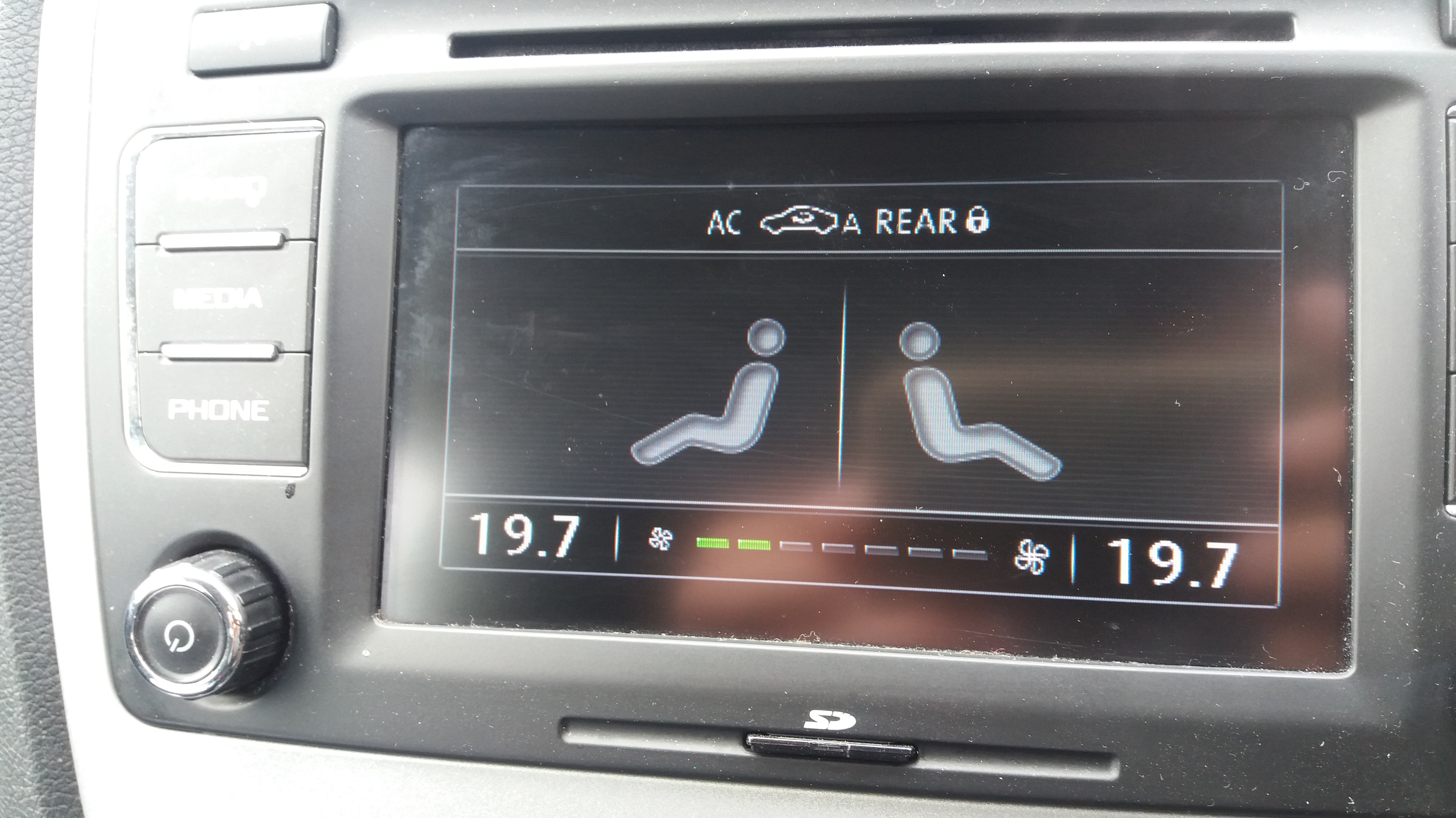

More Extra info climatronic
harryrope replied to harryrope's topic in Skoda Octavia Mk II (2004 - 2013)
Also just to add, you might notice the temperature on the photo is 19.7 I dont think you usually see the .7 bit. And the photi relates to rear...ahain not usual I believe. -
Hold the AC and the screen buttons you get the self check flash similar to holding Ac and front vents... However this screen is not standard and appears to show temperature options and rear vents locked or no lock. -
By pressing the AC and Screen button I get an extra screen in the info. Seems to give temperature reading and also relates to rear. Anyone know what can be done with this setting or what it actually is.
