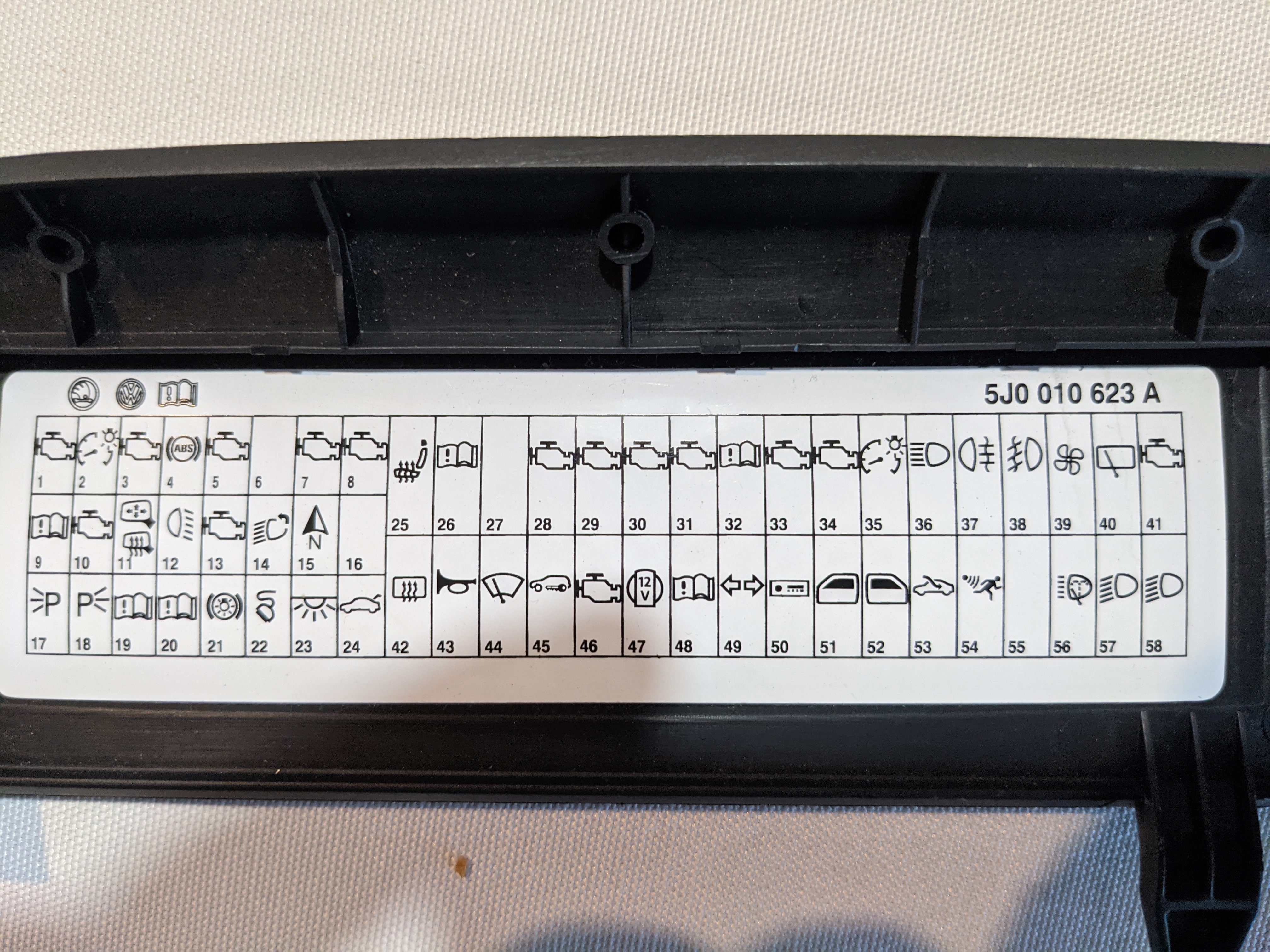

  8. I think you best bet is to try another battery. although they are saying its fine it needs to be ruled out. Volts and Amps load test. I was getting strange things happen like the trip resetting and electric windows hunting for position although it would start ok. And then My battery died recently, i could leave the car for a couple of days and then it would be flat. we tested to see if anything was drawing power and it wasnt so fitted a new battery from my local trusted group and havent had a problem since. now have left it for a couple of weeks and no problem.
  9. I just put everything away for the ight and noticed that the right rear parking lights are now not working. still got indicators.
  10. Firstly I cant seem to find a fuse for these lights after looking at haynes manual and online fuse layouts and posts on here. Bulbs are good, doesn't seem to be power at the lights. Rear Fog, reverse, brake, indicators and numberplate lights all work. 1 of the parking lights is out the other 3 are working. The Rear parking sensors are not functioning. All front lights working, horn works, interior lights work. I recently fitted a aftermarket JVC radio and tapped into live wires. Only had the dash apart. A year or more ago i found broken wires in the tailgte loom and fixed. Had a problem with car not locking and alarm going off, which turned out to be the drivers side electric window motor.
