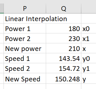

  2. Agreed. (Just re-read the second line in your post, and that is a factor I had tried to account for my using all DSG vehicles in my calculations, but it's a good point. Might explain the difference between the 150PS TDI & TSI numbers, though the weight is also likely a factor.) 👍 Also, even around these very close numbers, either side of 150MPH, replacing the 220PS with the 230PS figures changes the calculated top speed result for a 210PS car. Though there may be changes between the 220PS and 230PS vehicles which change the aerodynamics or weight of the vehicle slightly, changing the final top speed. Different tyres between the vehicles would also be a factor in the top speed. (If they were different.) And as @Roottoot just posted in his linked video, even different runs will yield different results. I'm just trying to extrapolate from the manufacturers figures for fun.

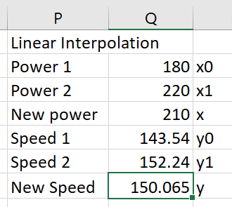

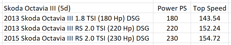

  4. Claimed top speed of my 190 is 147MPH, which I reckon is rounded one way or another. Here are the MKIII pre facelift numbers I have. (The additional accuracy is presumably because the original source was in KMH. So these may be more accurate than the MPH numbers quoted in the UK, and I may need to revisit my MPH figures for the FL *assuming* the original data was in KMH and there are rounding errors in the conversion to MPH for the UK. But I digress) So this is ideal. And the numbers look like this. On the pre-FL MKIII, 210PS should be enough to crack 150MPH. The formula I'm using is (Note that cell Q2 is Power 1 and cell Q6 is speed 2.)
  5. The pre FL model isn't a problem as the old 220PS MKIII was rated at an unlimited 154MPH, so could be used to accurately linearly interpolate. (Which I might do in a bit. How did you measure your 150MPH?) However the FL MkIII has different front end (as well as other things I expect), which I can't rely on not to have affected the aerodynamics, which will in turn affect the top speed, especially at those speeds.

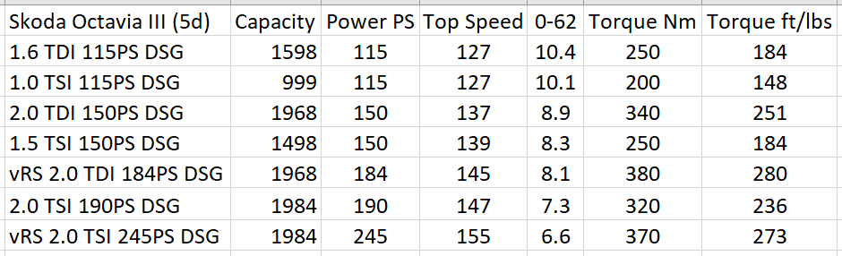

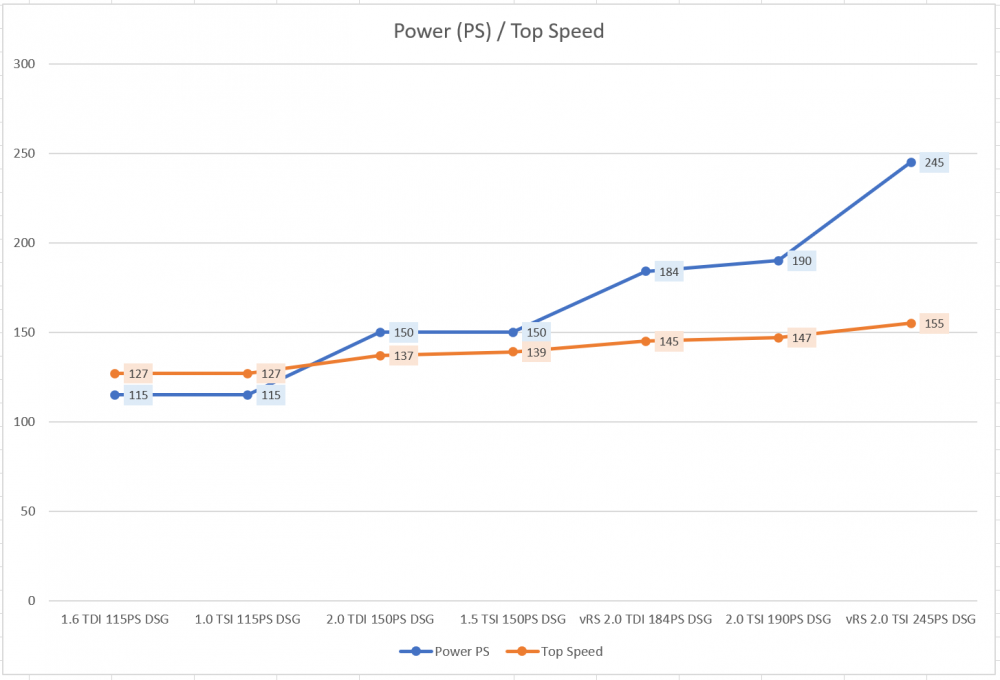

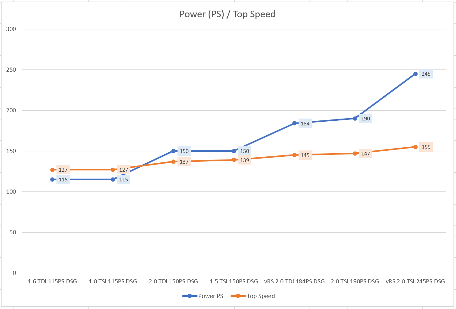

  10. I like to fool around with data and produce graphs to see if anything interesting catches my eye, and I was doing this with some recent DSG Octavias. As you can see, there's a discrepancy for the 245PS vRS's top speed because of the 155MPH speed limiter. Does anyone know what the top speed of a 245PS vRS is *without* the speed limiter? Any guesses?
