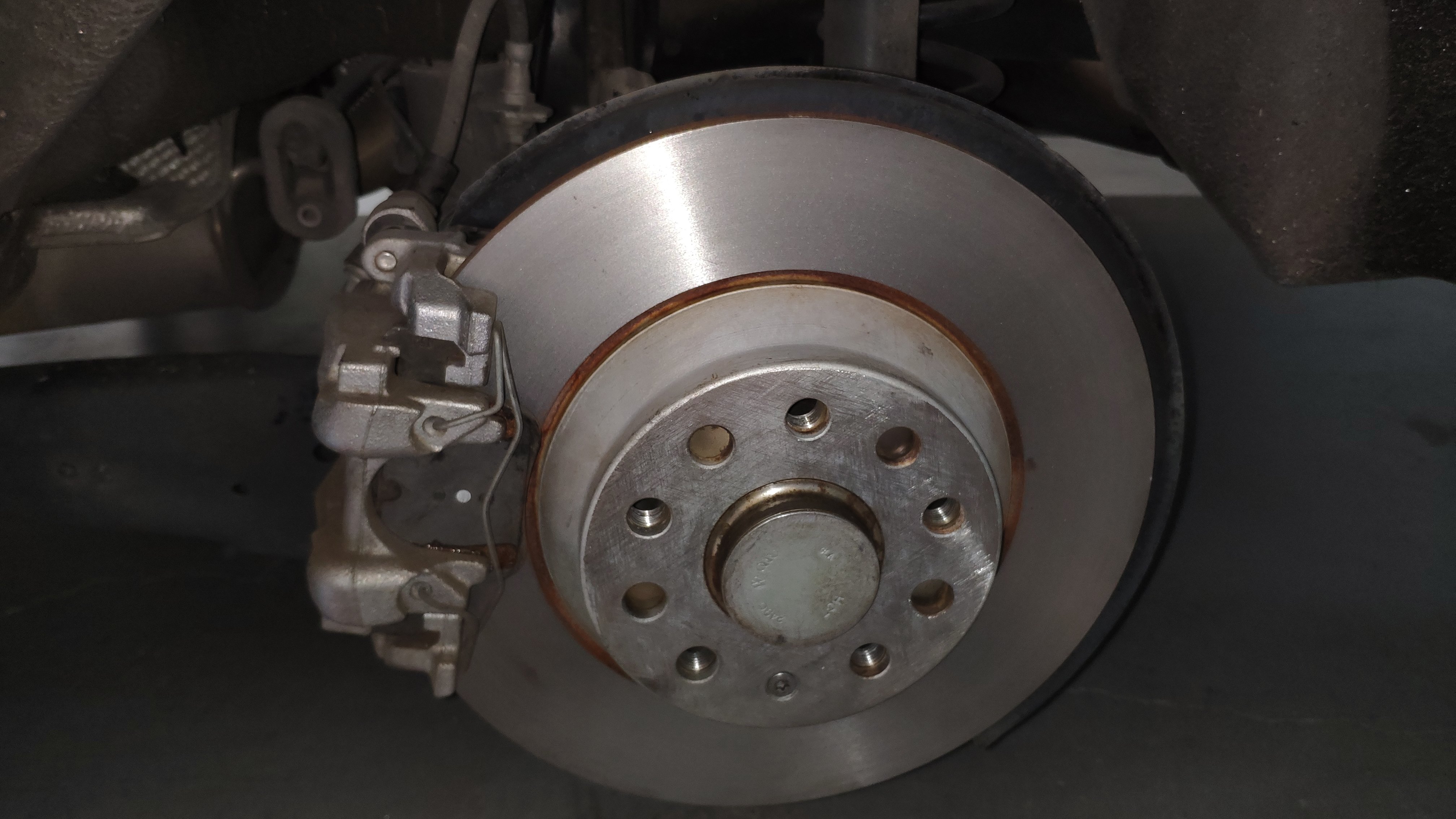

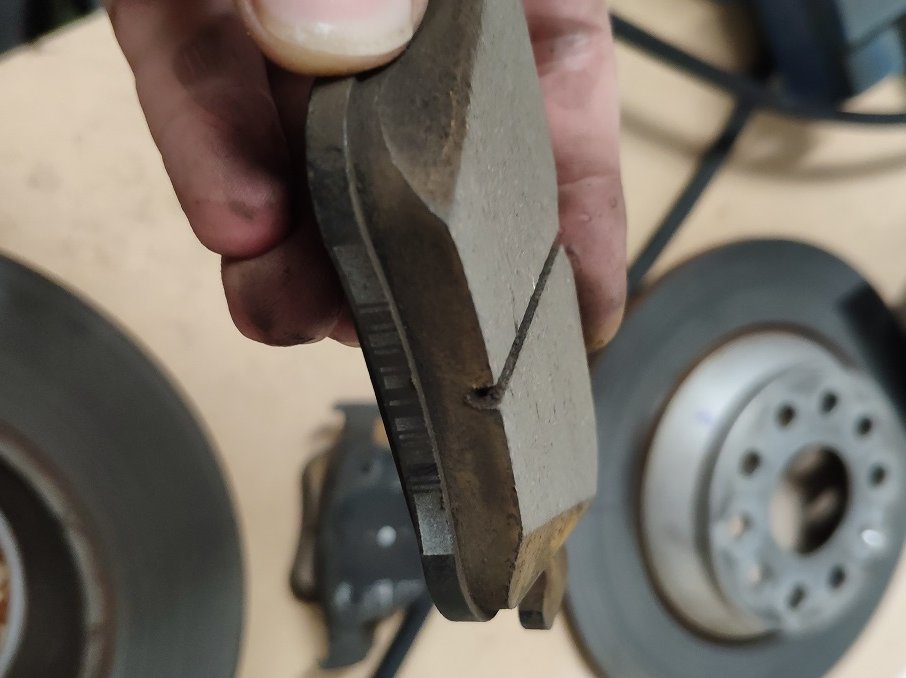

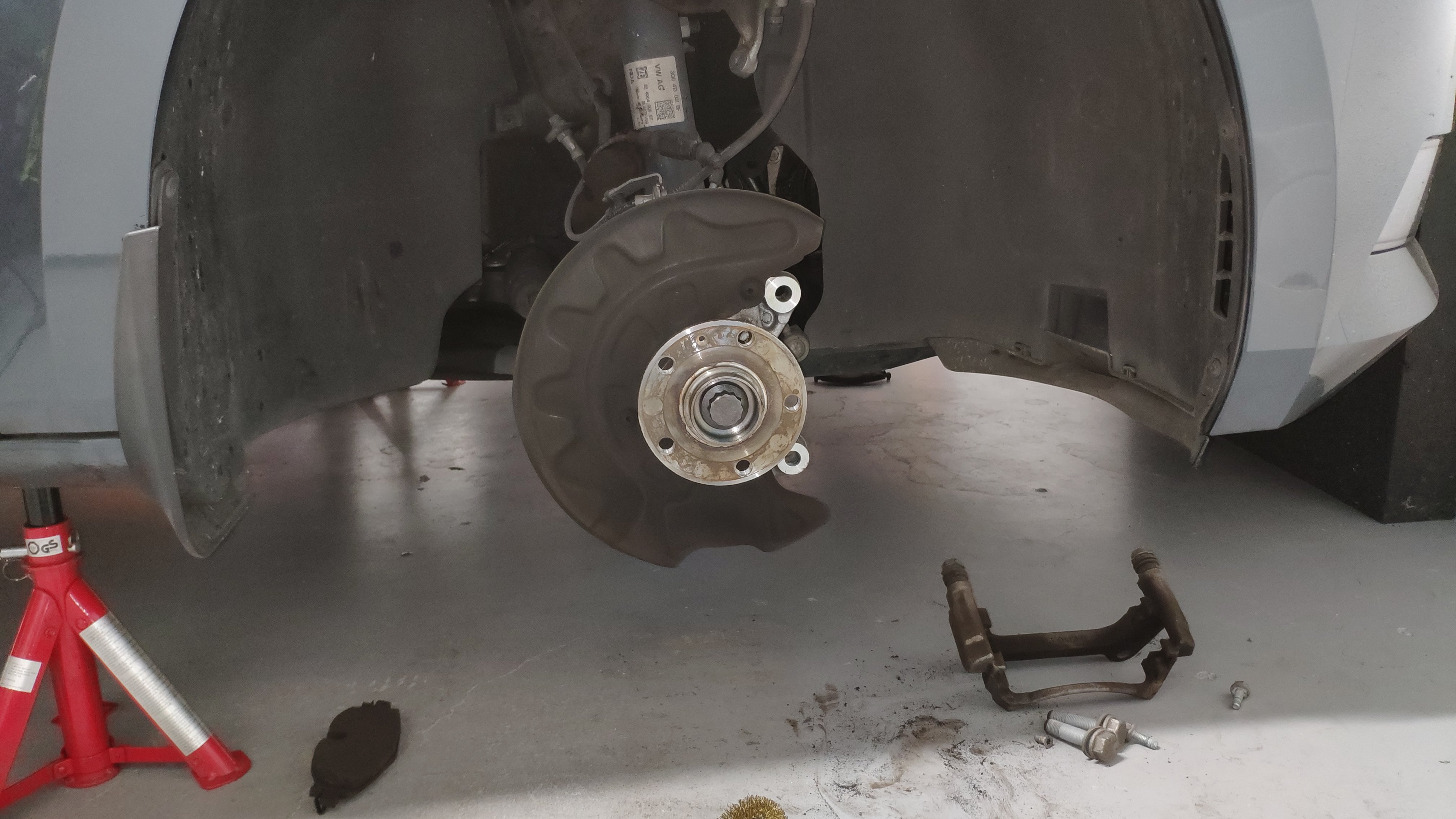

This week I decided to attack a small shudder when braking, likely caused by slight disc warping (the back was doing it for a little while but did not bother me that much; then I started getting some steering vibration after a wheel service where they left some nuts super loose other super tight.... sad...). All 4 discs were almost new, despite the 73k Km, so I went with resurfacing. Took out rears and had them machined at a specialist shop, all back with no problems. Yesterday did the fronts and them nuts holding the calliper carriers were tight as hell, but my trusty breaker bar did it's job. Reassembled last night (all nuts torqued to spec) and took it for a spin. Other than some initial scraping noise from the pads against the rougher metal, it seems good. The pads were also almost like new, so I just ran them a couple of times over fine sandpaper and refitted them. Let's see how it drives after they bed in completely. I hope I don't have problems in the wheel hubs themselves in the front, the idiocy done when tightening those wheels was nothing short of epic. -
