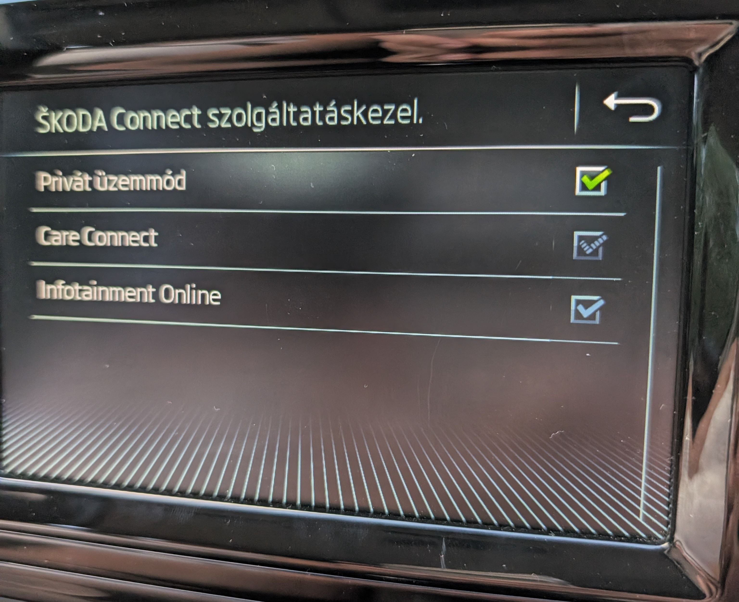

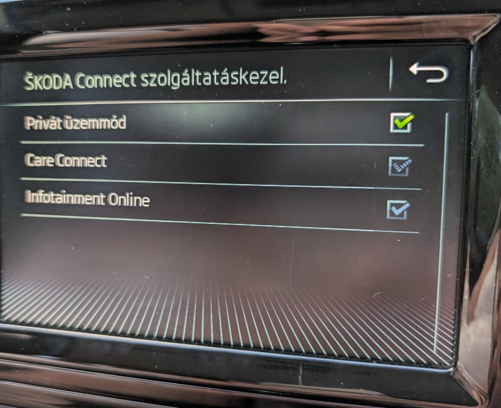

Skoda Rapid Private Mode
Hi team, hope you can help me please. I just activated Infotainment online and care connect, but the app and the car are not communicating due to the car being in " Private Mode" The app is showing that this Private Mode should be deactivated first in the car. So I went to Settings, found the Private Mode Menu, but however I click on it, it's jist stuck and I am unable to deactivate it. Tried to touch the green tick, the name, everything. None worked. Any idea please?

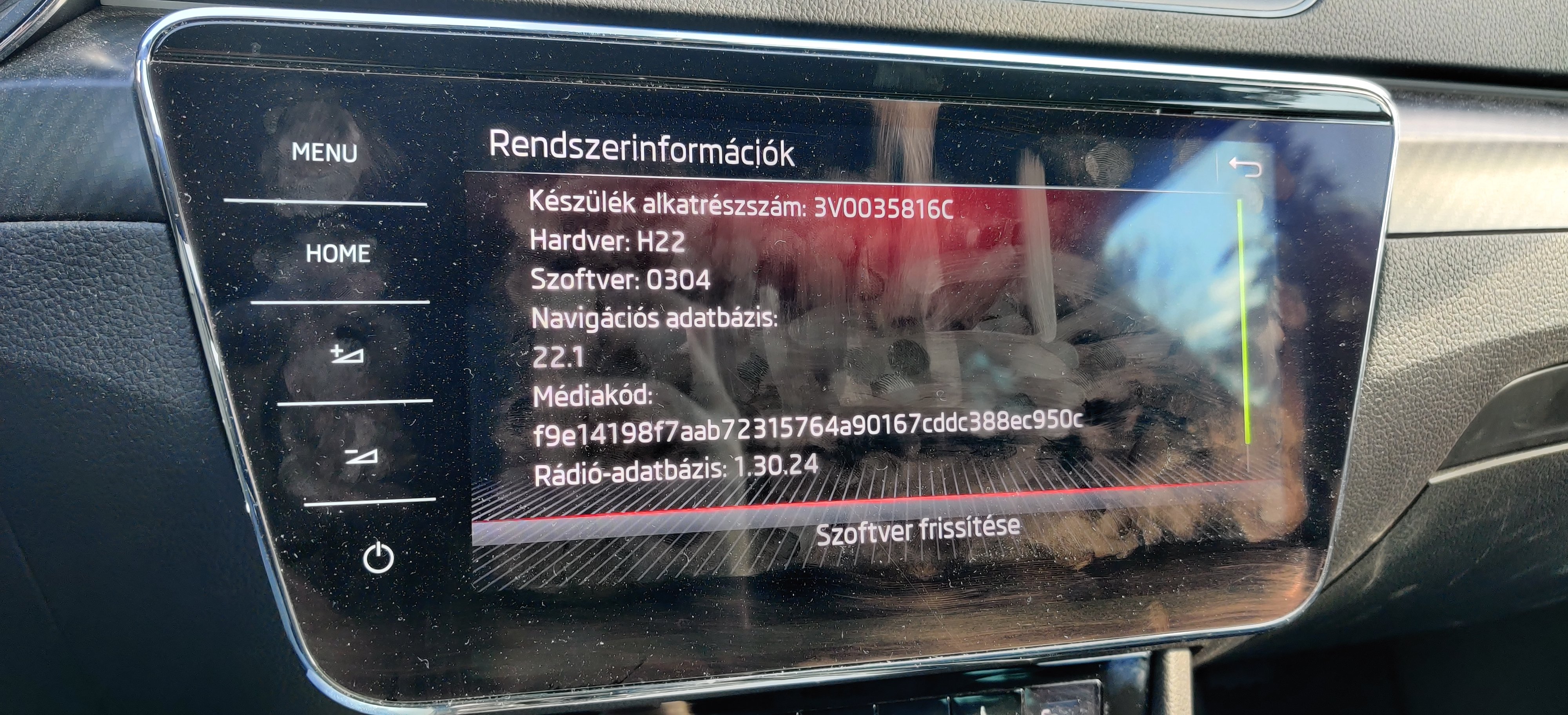

Superb iV software version & update
SW 304 with this the USB-C update finally works with maps...downloaded the latest from Skoda Update, plugged in and voila...22.1 version

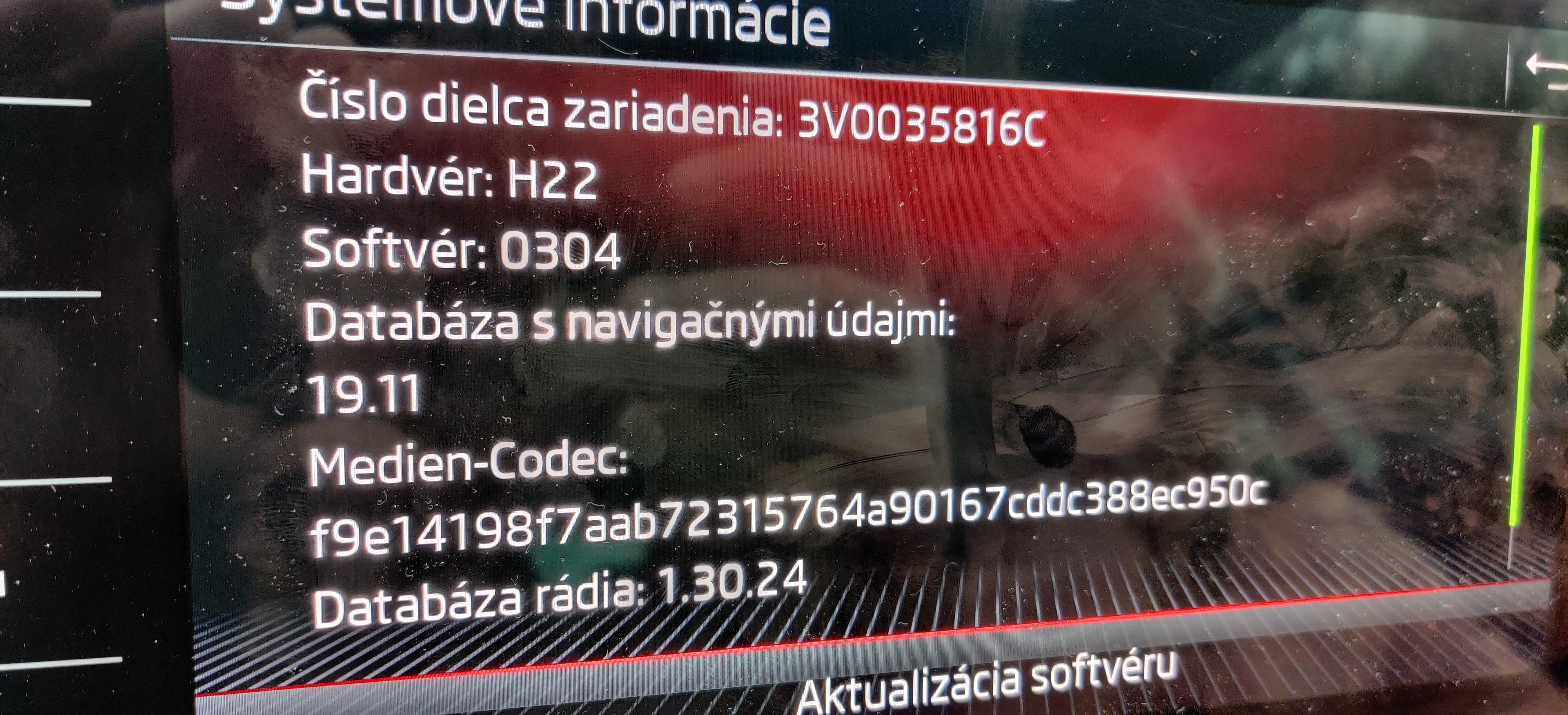

Thanks Farfar, would you mind taking a picture of the system information page? Would like to use it if my dealer says there are no available updates 😉
