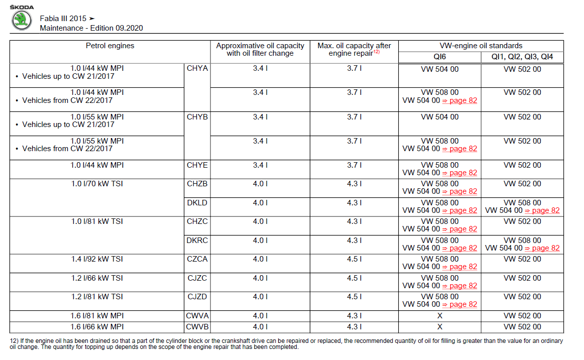

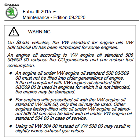

  6. This table tells the story for model years up to 2020 (there's a separate table for later years). Use the engine code (see the sticker at the bottom of the driver's B-pillar) and model year. The QI6 column is for variable service-intervals, the Q1-Q4 column is for fixed. The notes on page 82 are:

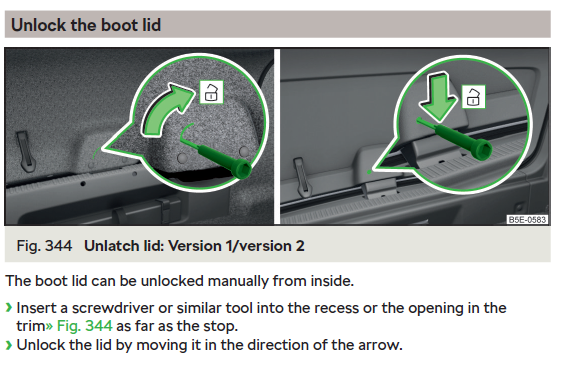

  9. Haven't tried this myself, but this extract from the manual might help.
