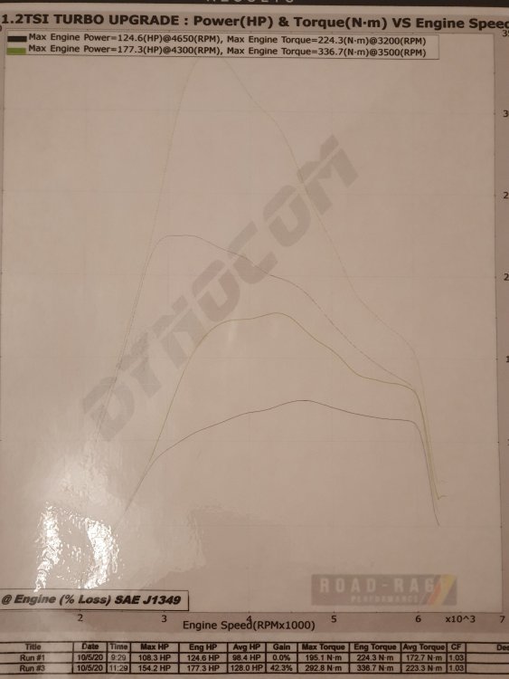

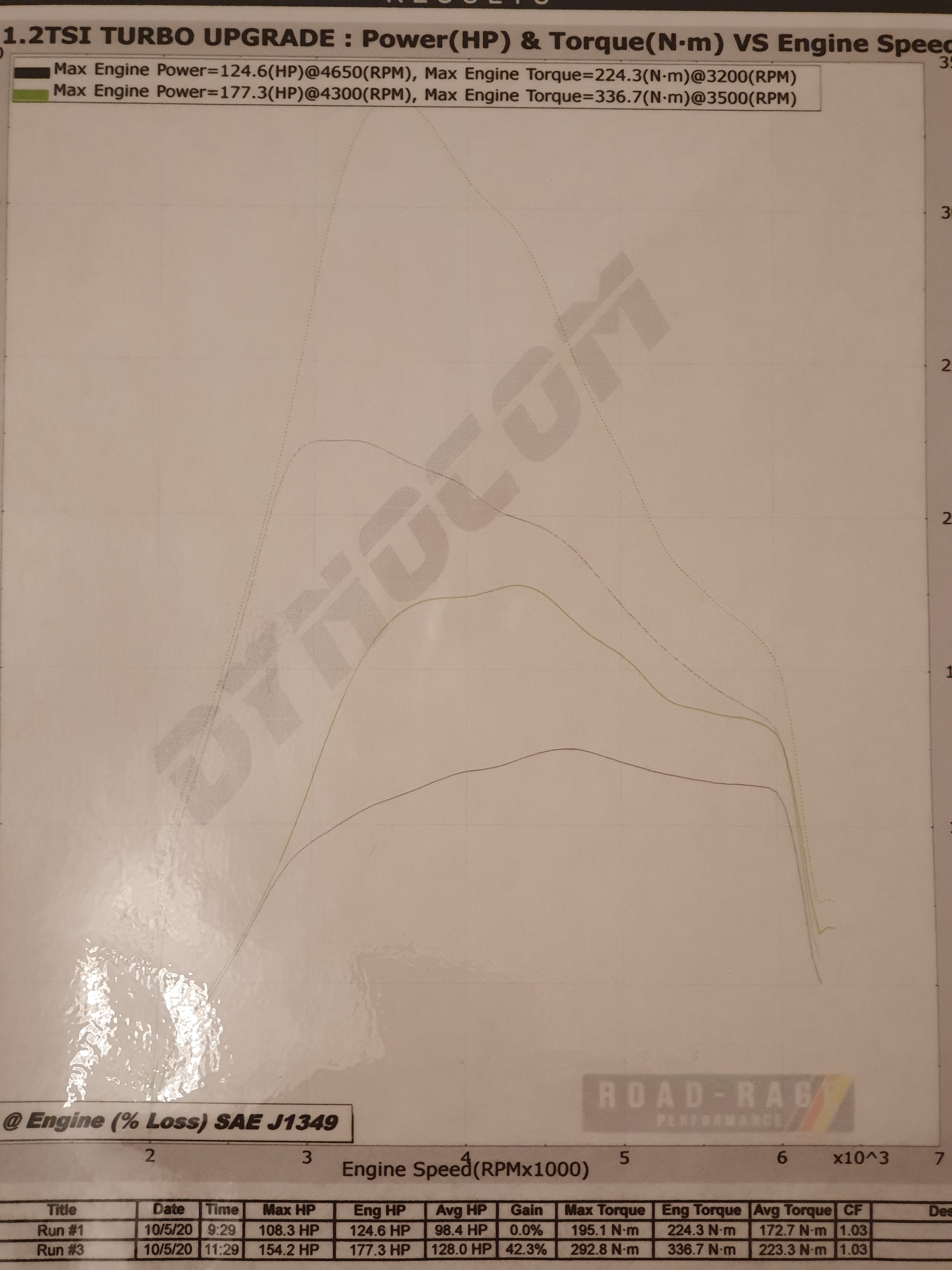

  15. Update- On my way to pick her up, headlines are; Stock 124Bhp 224nm - Tuned 177Bhp 336Nm. DSG shift speed upped and clutch clamp pressures and launch mode added 😎

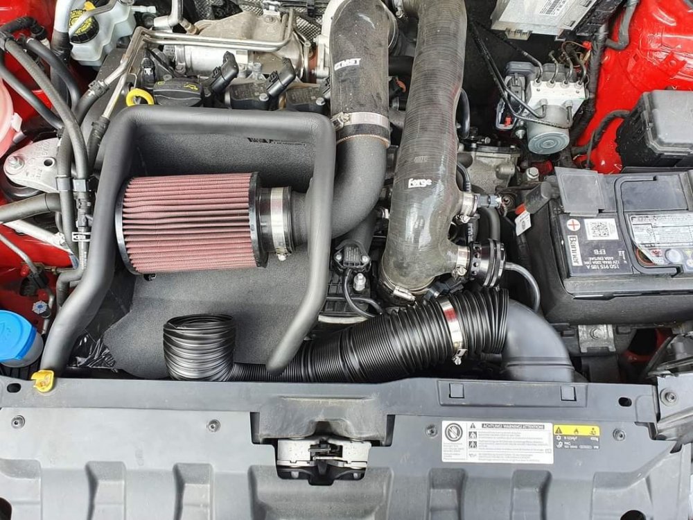

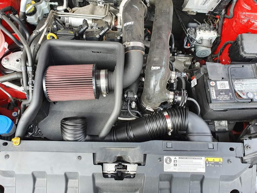

  16. Update on 1.2tsi turbo swap to the 1.4 unit and remap - full update at the end of the day. Just dropped my car off at Roadrageperformance.co.uk for them to work on today. 1st run result with no optimisation was 126bhp, mods are MST intake, forge BOV, APR coil packs, NGK platinum plugs and of course the turbo upgrade.

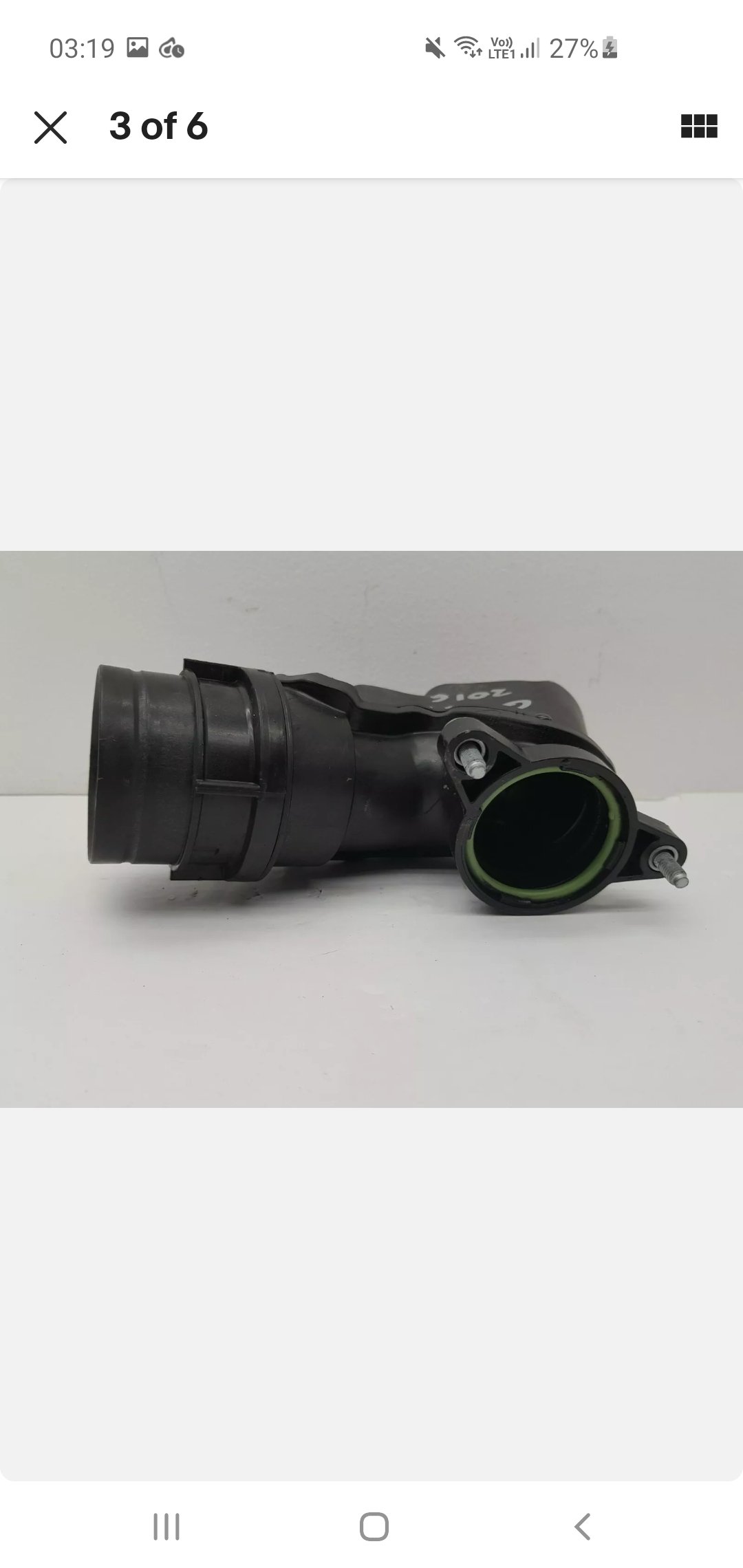

  17. Any idea where I could get an adaptor to do that. I have a silicone hose on my air intake and it connects to the factory 90 degree elbow but it looks restrictive and has a resonator attached I'd like one like you can get for the 2.0 or 1.0. At the turbo side it's a flat face the the elbow is screwed to so I need an adaptor for a hose to fit to
  18. Hi does anyone know where to get a hi flow turbo inlet pipe with resonator delete for the 1.2 tsi or 1.4 tsi?

  22. Fitted my 1.4 turbo today, definitely more powerful compared to stock but doesn't feel as powerful as when I had the racechip on. The racechip is long gone now and the planned remap should truly transform the power output. Only thing I've noticed is that at stand still in neutral it will only rev to 4k, and as it hits 4k the forge dump valve goes off. It seems to drive fine though and pulls through and past 4k rpm. Is this normal?
