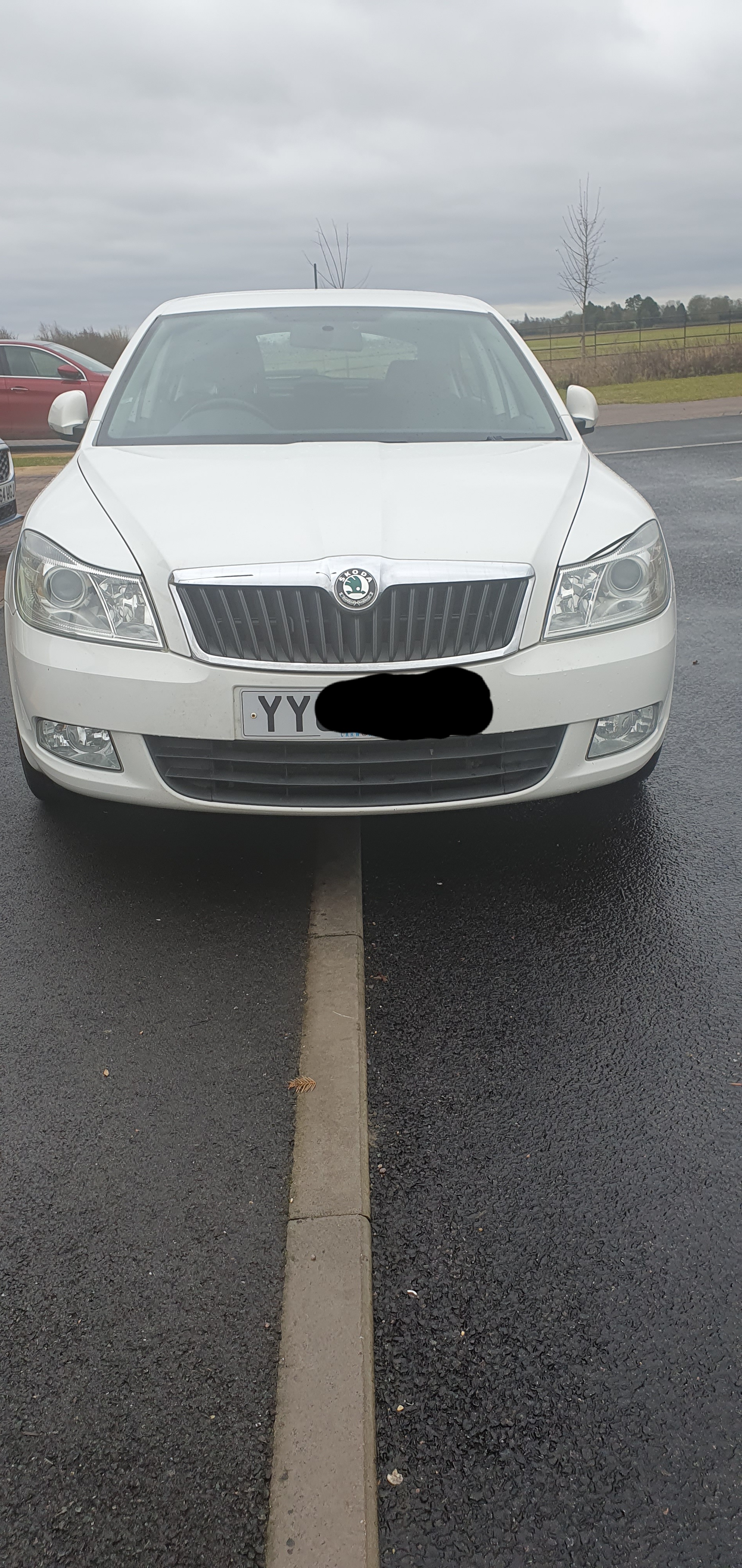

  1. A big thank you to Langers2k for the help coding my bcm lights configuration. Unable to do it with vcds. Now have front and rear drls. Both rear fog lights working and front fog lights. All working as factory spec. Very much appreciated.

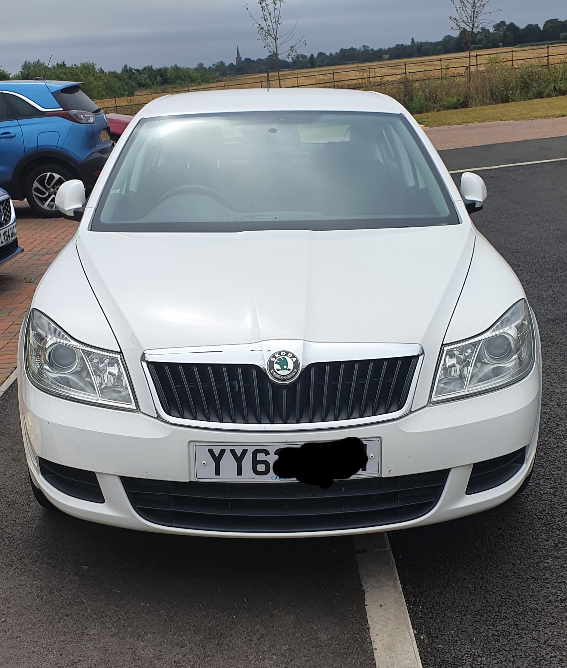

  6. Have managed to get a loom for a VW polo 6c which has drl and foglight connectors. I believe the wiring is as follows Connector C pins 48 left and 49 right for drls. Connector A pin 25 left fog light Connector C pin 25 right fog light. Just need to know the wiring from the light swith to BCM. There is an extra cable which is included with the loom. Also the earth cable to chassis or negative terminal on battery. Any advice greatly appreciated.
