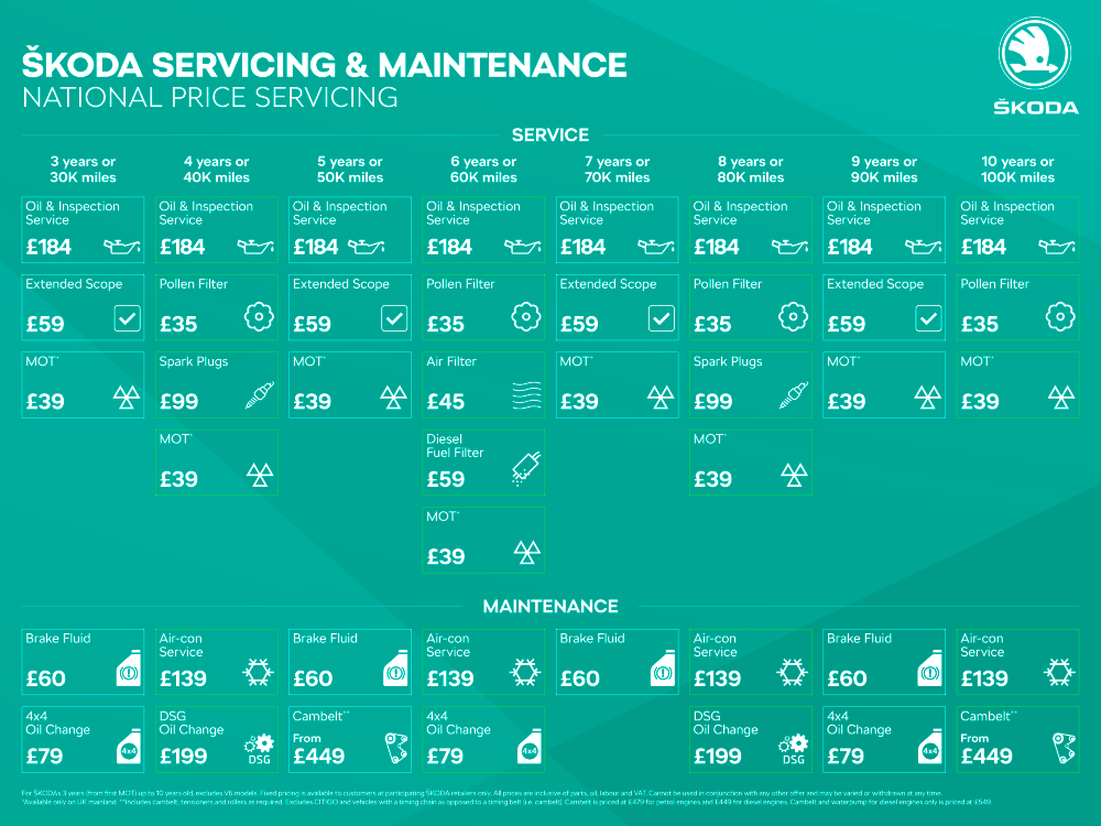

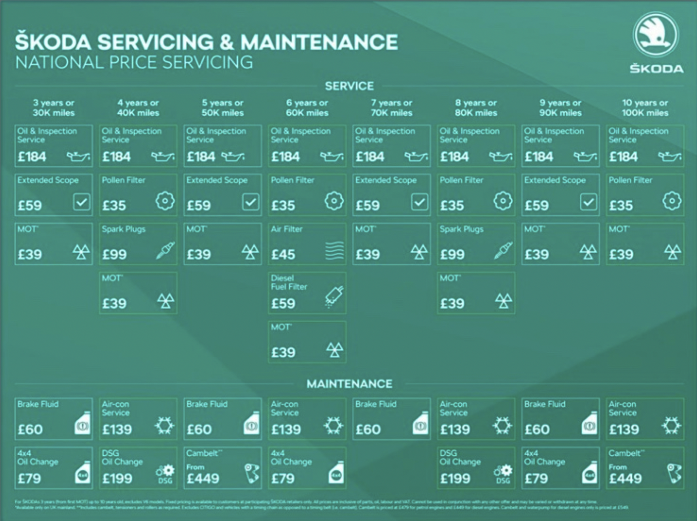

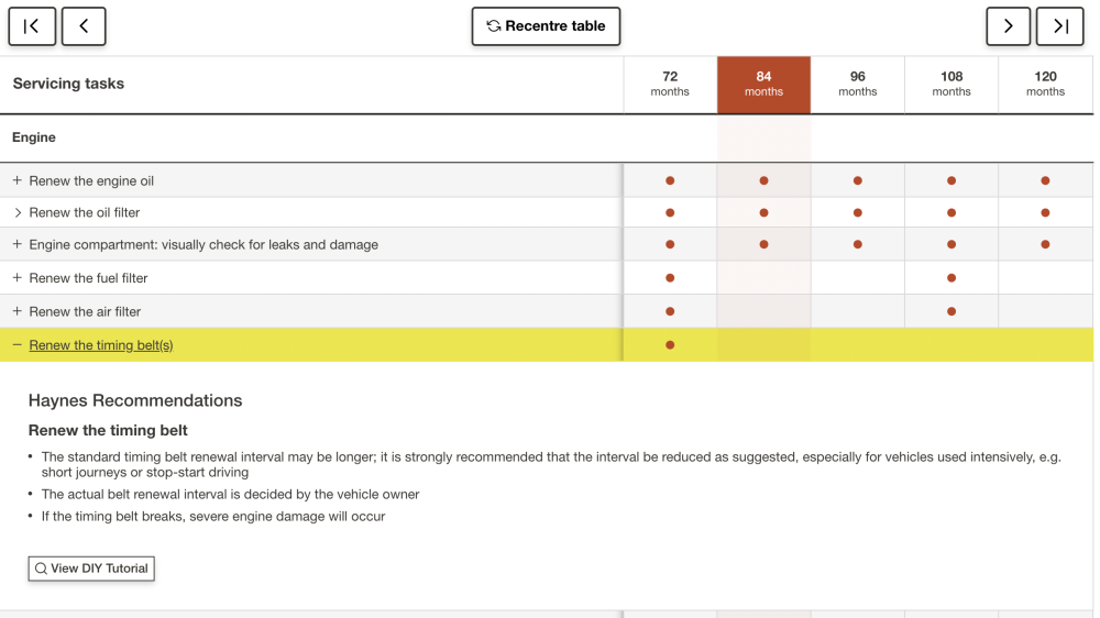

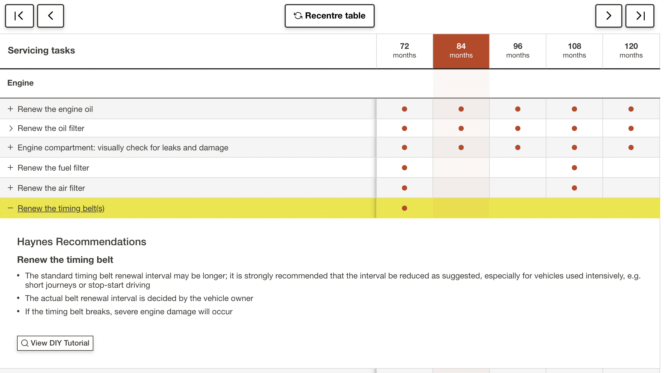

  11. I actually posted this for the benefit of anyone who may come across the same issue. It would be helpful if you could kindly add the steps for Virtual Cockpit fitted cars.
