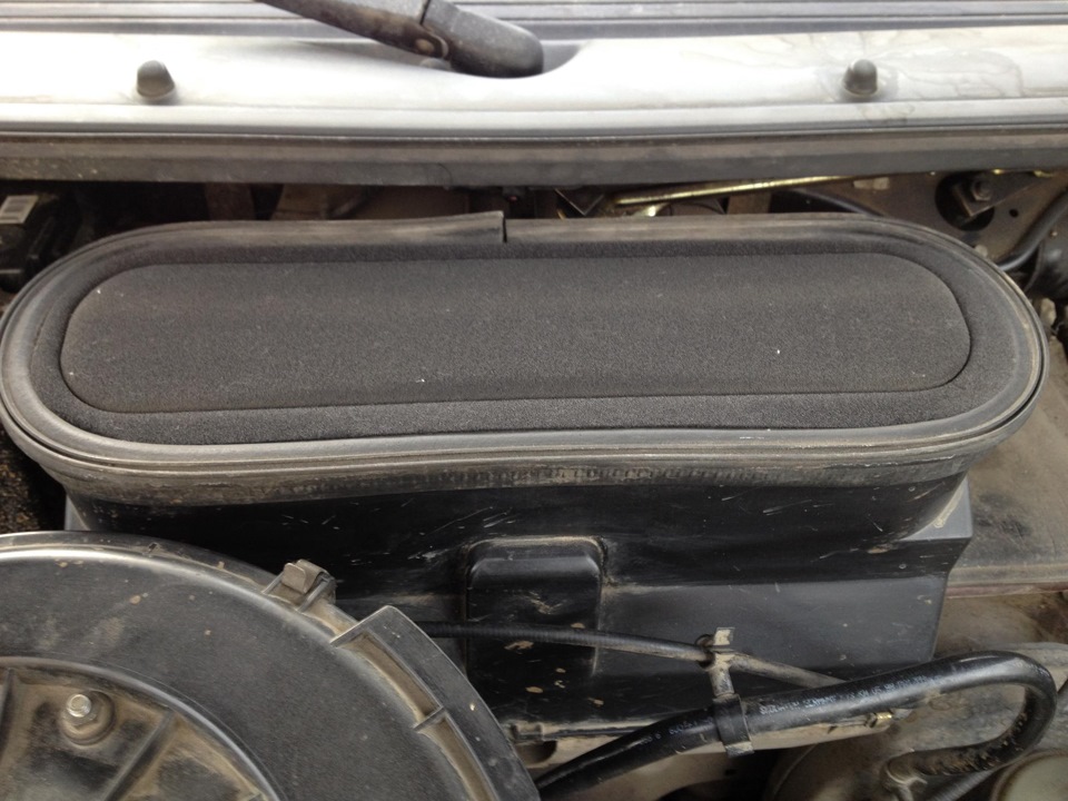

@RicardoM I apologize for not being very clear. The thing that I don't understand is how to disassemble this filter box in order to fit the filter: Because it is absolutely diffrent from that one in your post.
Can i make a modification to my Felicia 1.3 filter case?
I just liked the theme. I was trying to say that if someone has any idea I will also try putting filter with or without modification on the filter box.
I also have the same box and even if there is enough space for filter I don't see any way of disassembling in parts like the one in the first post because there aren't any metal clips. I think the best way would be to put something like this: If anyone knows how to disassemblе the filter box I would try fitting the filter from the first post:)

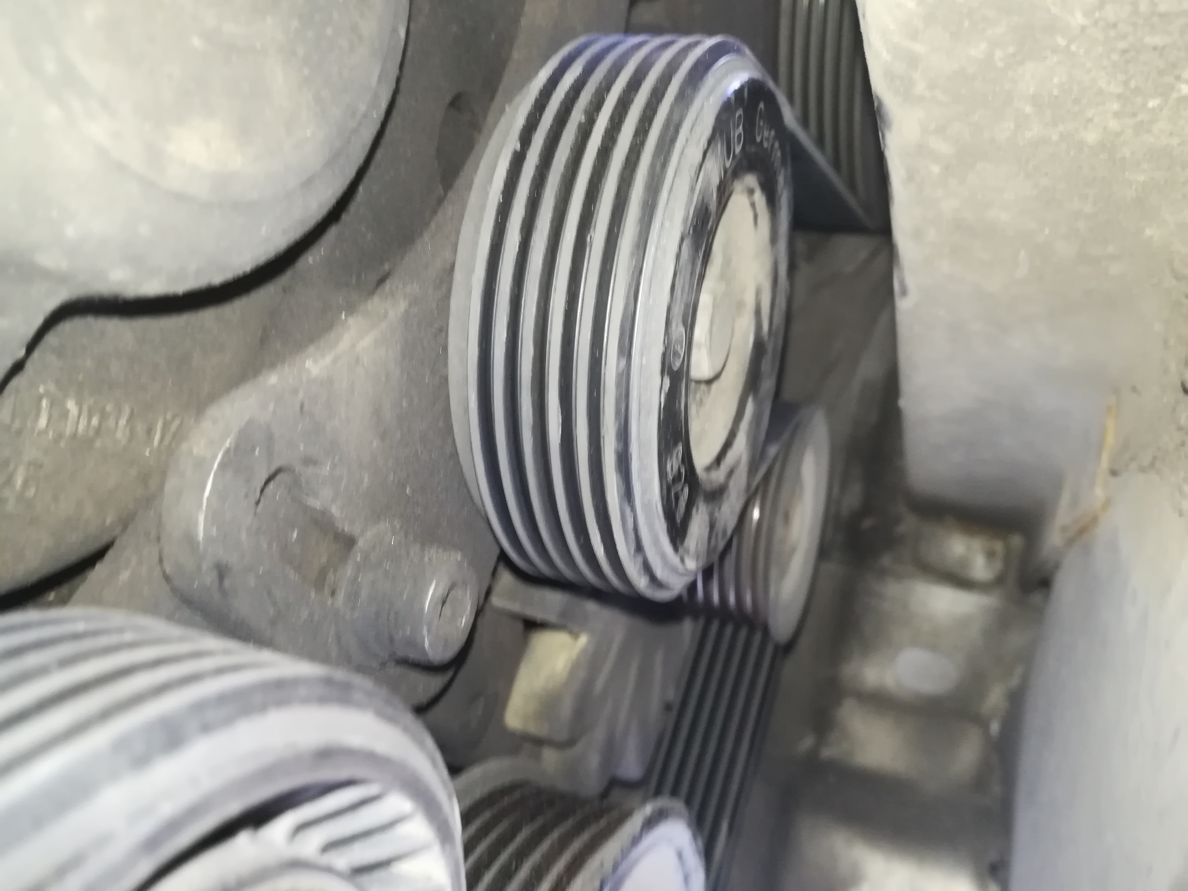

Changing auxiliary belt Felicia 1.3mpi with hydraulic steering and AC
The roller on your photo looks like is on the same spot as on mine. And the barcket/plate for the AC looks similar.
It is jus my interior that is L&K and the engine is 1.3mpi 50kw with 68hp. As far as I know the L&K models had 1.3 mono for hatchbacks and 1.6mpi for the estates. For the A/C as I said in another thread I have seen 3 cars except mine with the same setup and if I saw correctly one of those three is @Thefeliciahacker's Sportline.
I'm 99% sure that it is felicia one, but my dad told me that some years ago the block was cracked and the welding is right on the engine code and now it can't be seen. But in the documents of the car it is written that it is a felicia one.

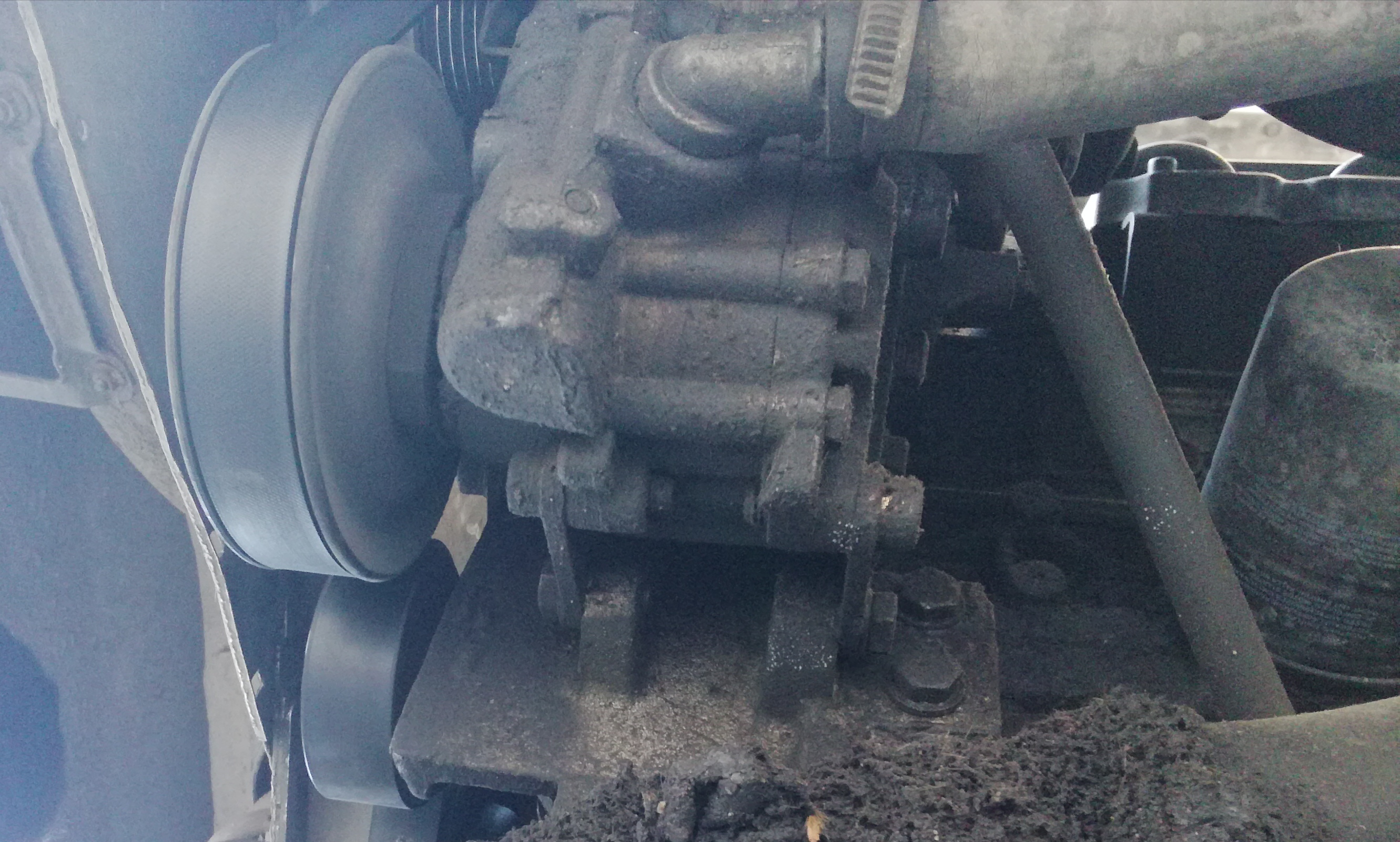

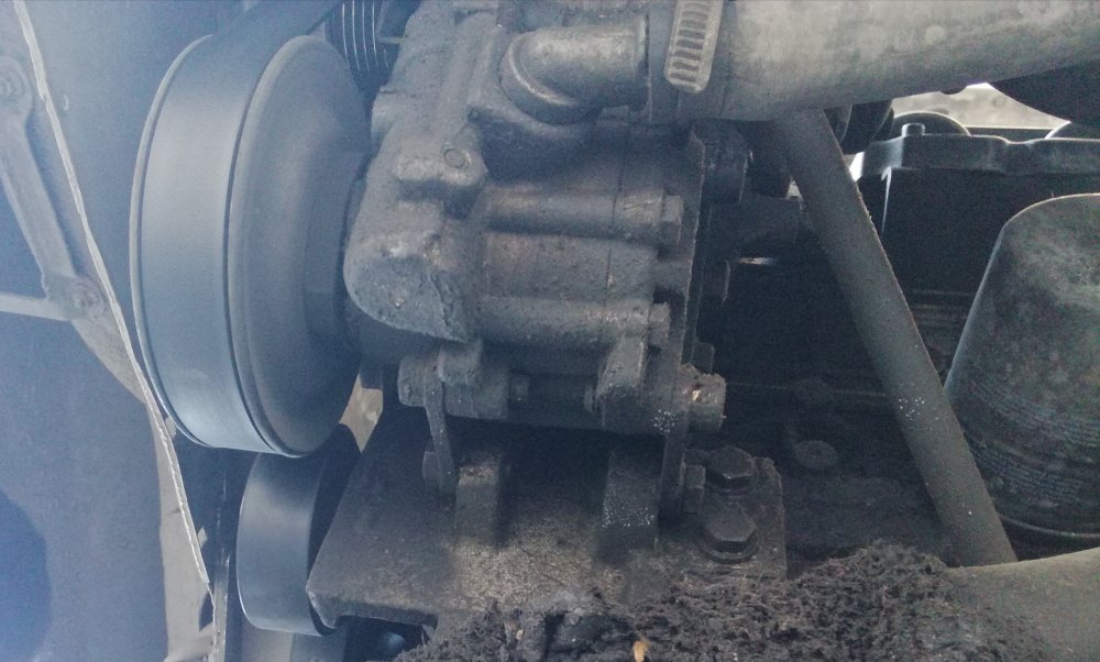

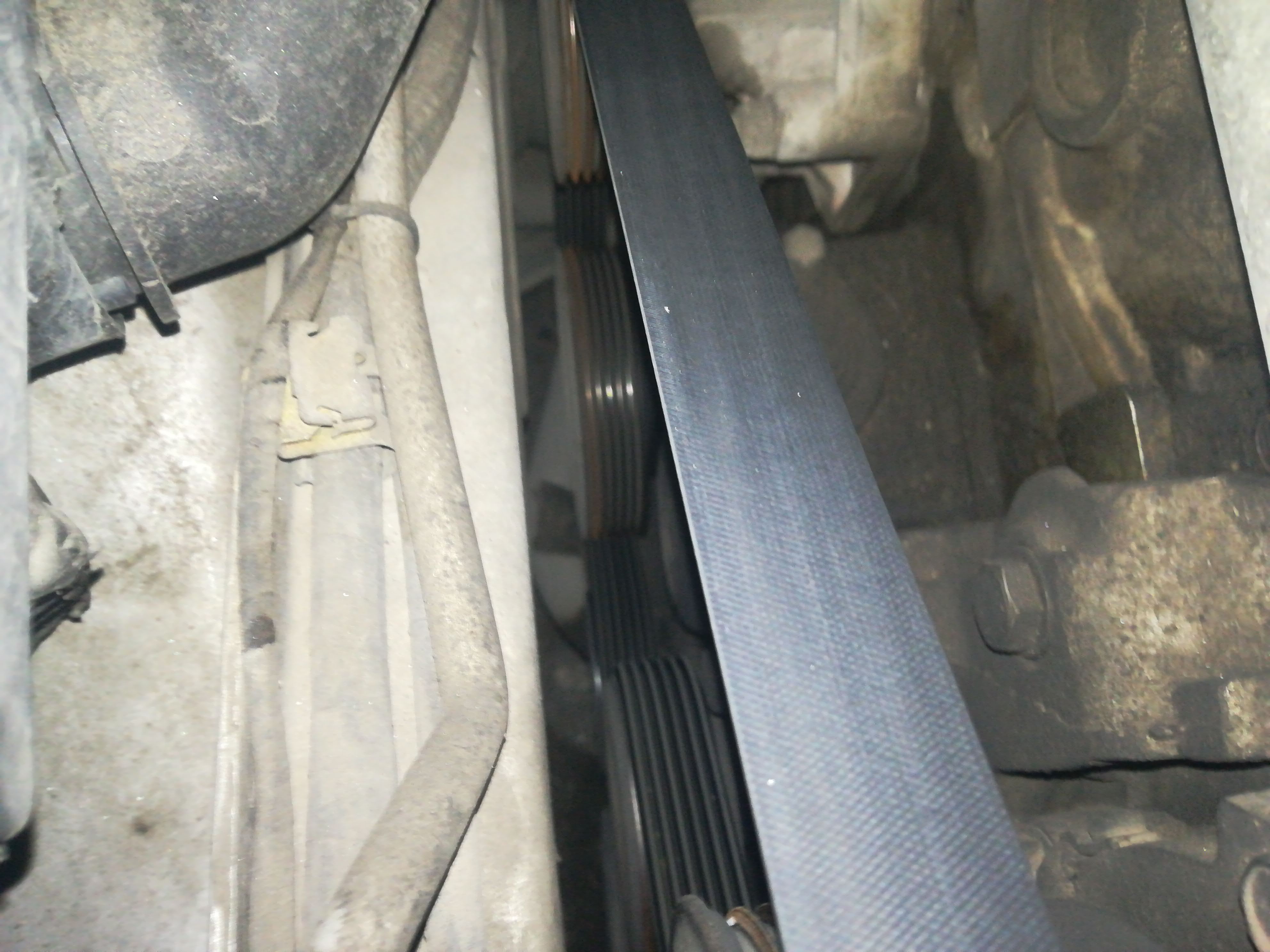

Thanks, but I didn't have time these days and the weather is bad, so I haven't tried, may be the next week I'll try to figure it out. In my car the Roller is moved down between the Crankshaft and the Power steering pump, on the place of the Alternator and even a little bit higher is the A/C compressor and the Alternator is moved down right next to the Tensioner, but unfortunately there is no original tension mechanism on the back of it(look at the photo in the first post). It looks like it is held by some kind of plate in its position, but it is the one that left to try before giving up and go to mechanic.

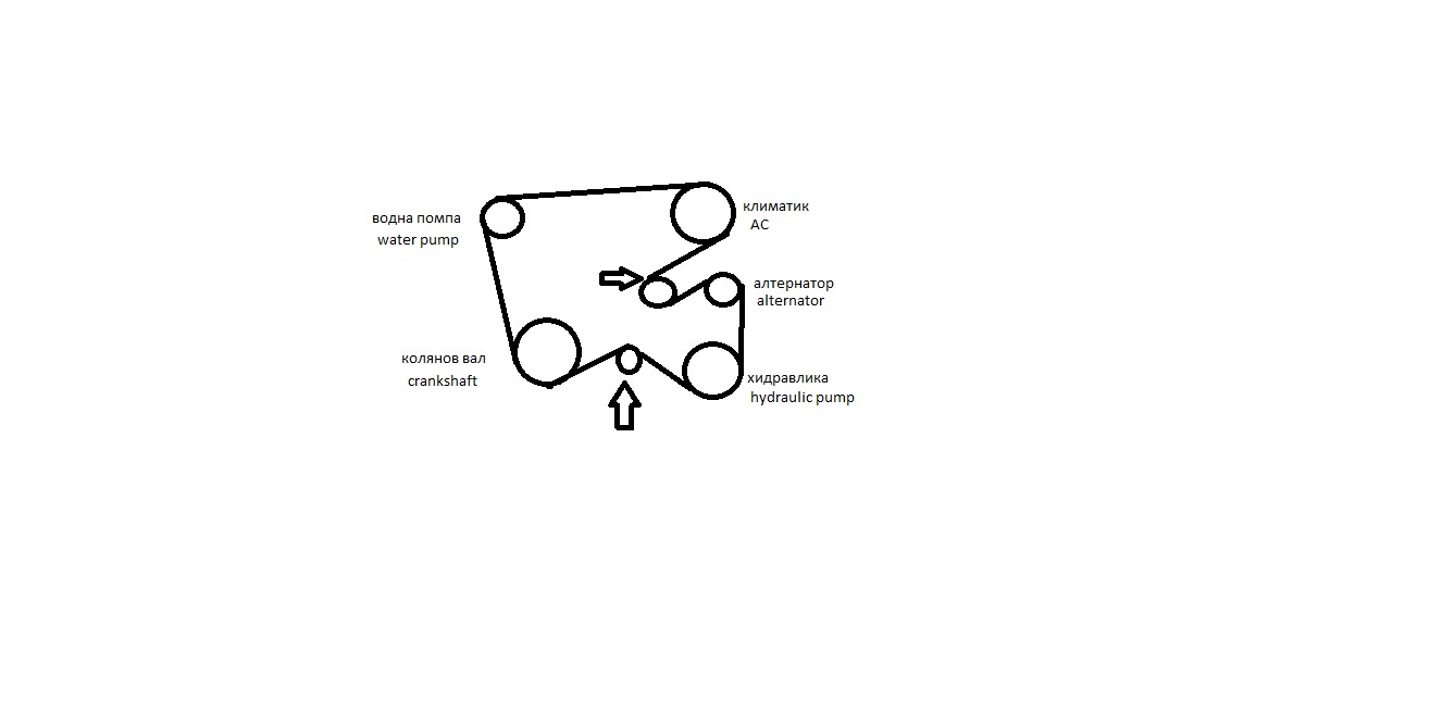

Thanks for the reply! So the tensioner pulley should be that one which is next to the alternator on the diagram? My confusion was because the tensioner on the other 1.3mpi engines is a different kind.

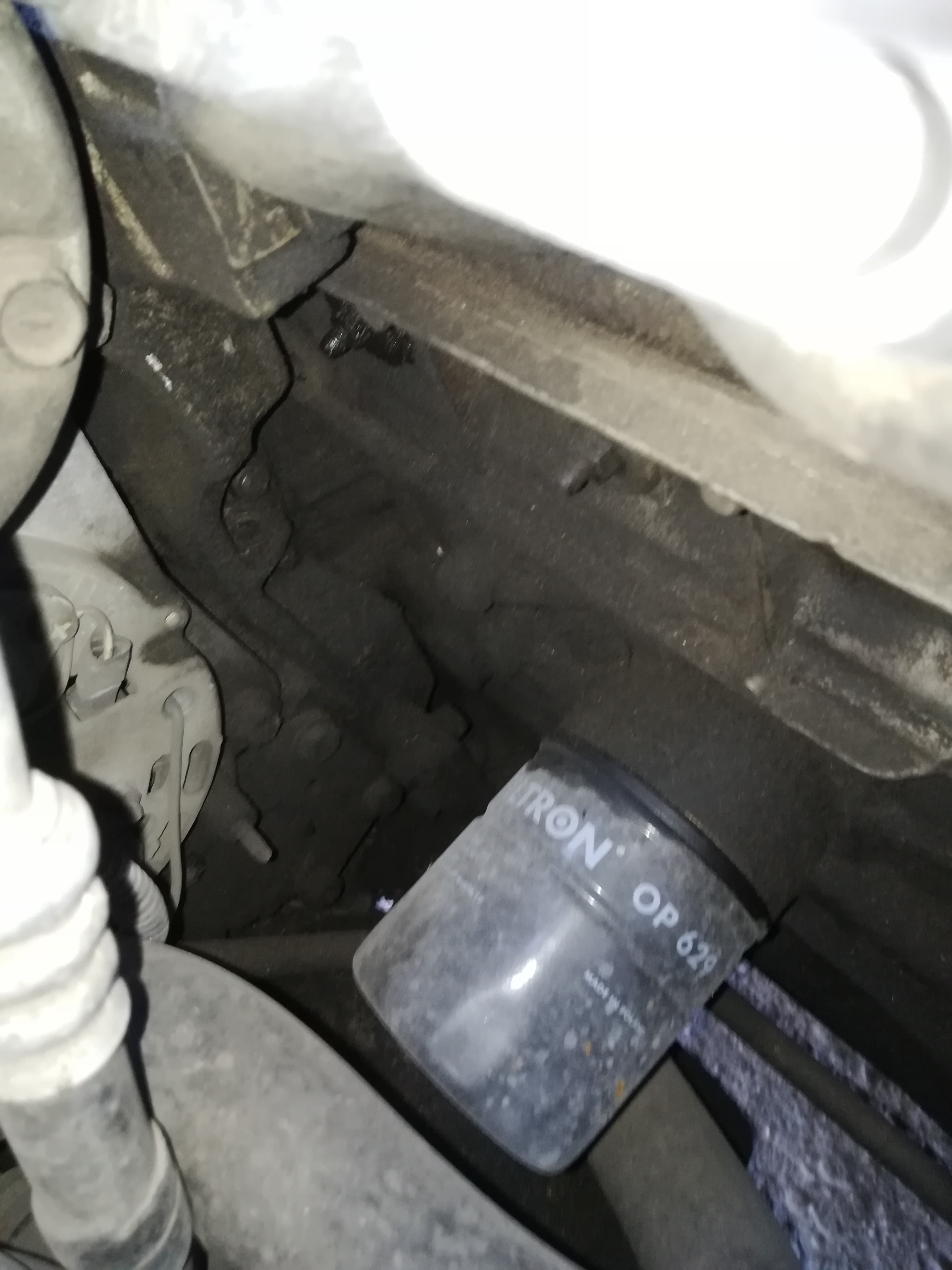

Hi I am trying to figure out how to release the belt tension because I have to change the auxiliary belt. Do you have any ideas? I don't know which pulley is the tensioner and ho to undo it: I checked and I don't have tensioner which is above the oil filter and I don't have space to remove the alternator. I am thinking of removing the AC compressor in order to release the belt tension but I think there should be easyer way of doing this. Those are the best shots I was able to get.
