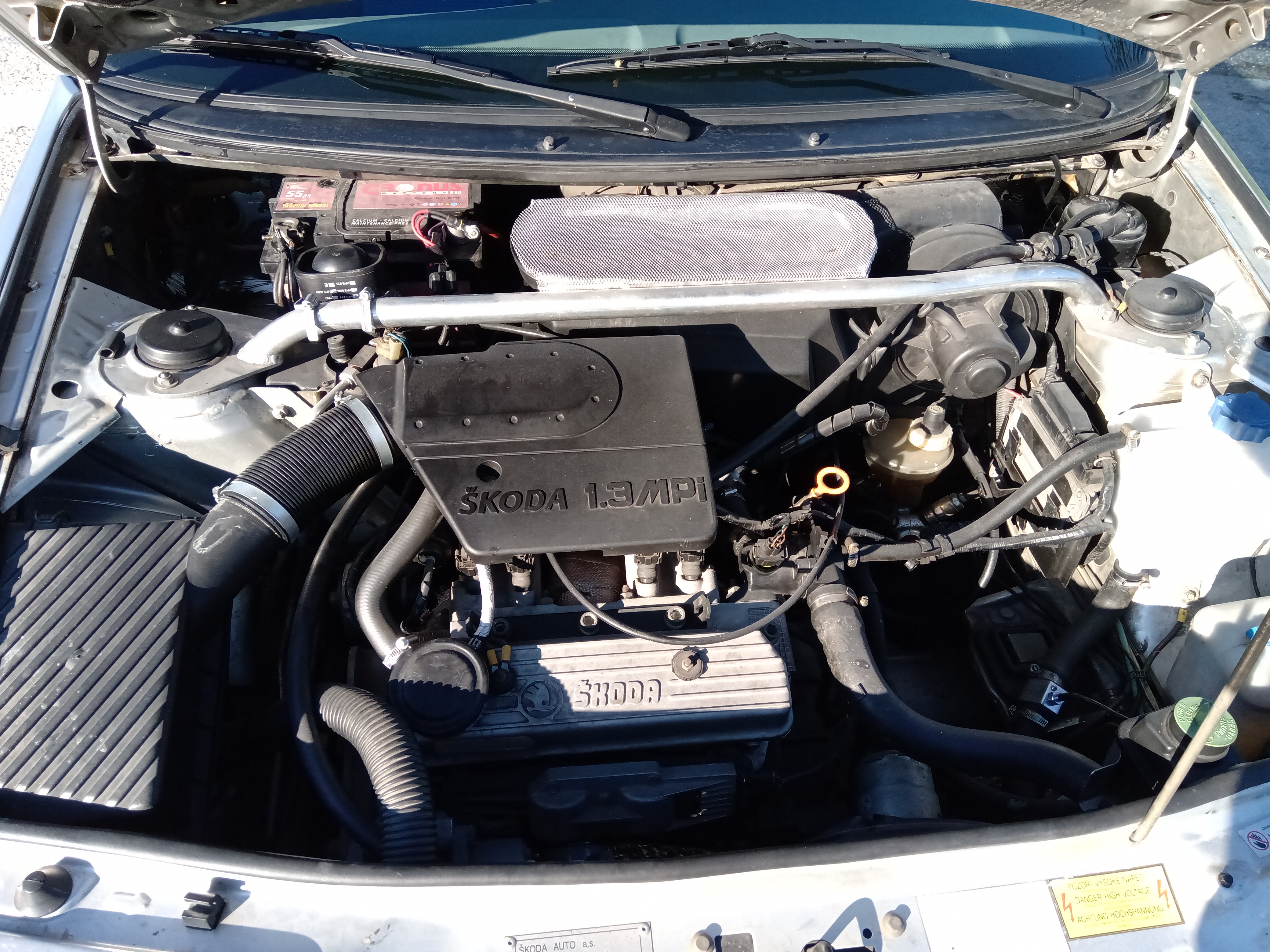

here is my engine bay:
One I posted has slot for filter behind evaporator, but this one is so crammed, that I'm not sure if there's any space for filter at all... One you have posted is variant for heating without AC, which is entirely different..
That the one I have also
Does it fit a filter

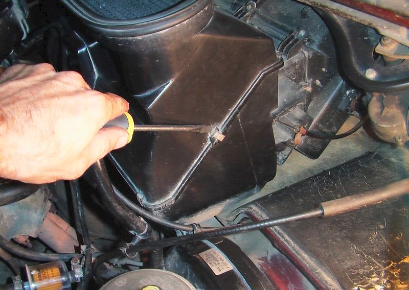

@RicardoM I apologize for not being very clear. The thing that I don't understand is how to disassemble this filter box in order to fit the filter:
It is just a matter of removing 9 or 16 metallic clips. Be very careful. They have the bad habit of flying and disappear.

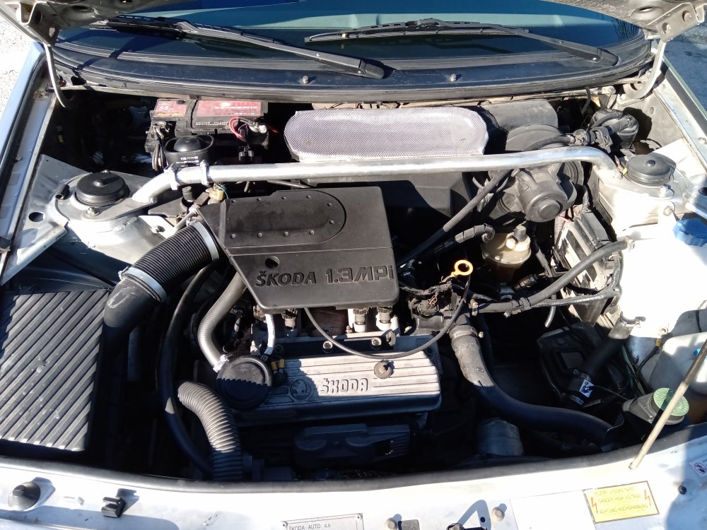

The only photo I have got right now is this, I'm sorry for the dirt.
Yes, I have AC.

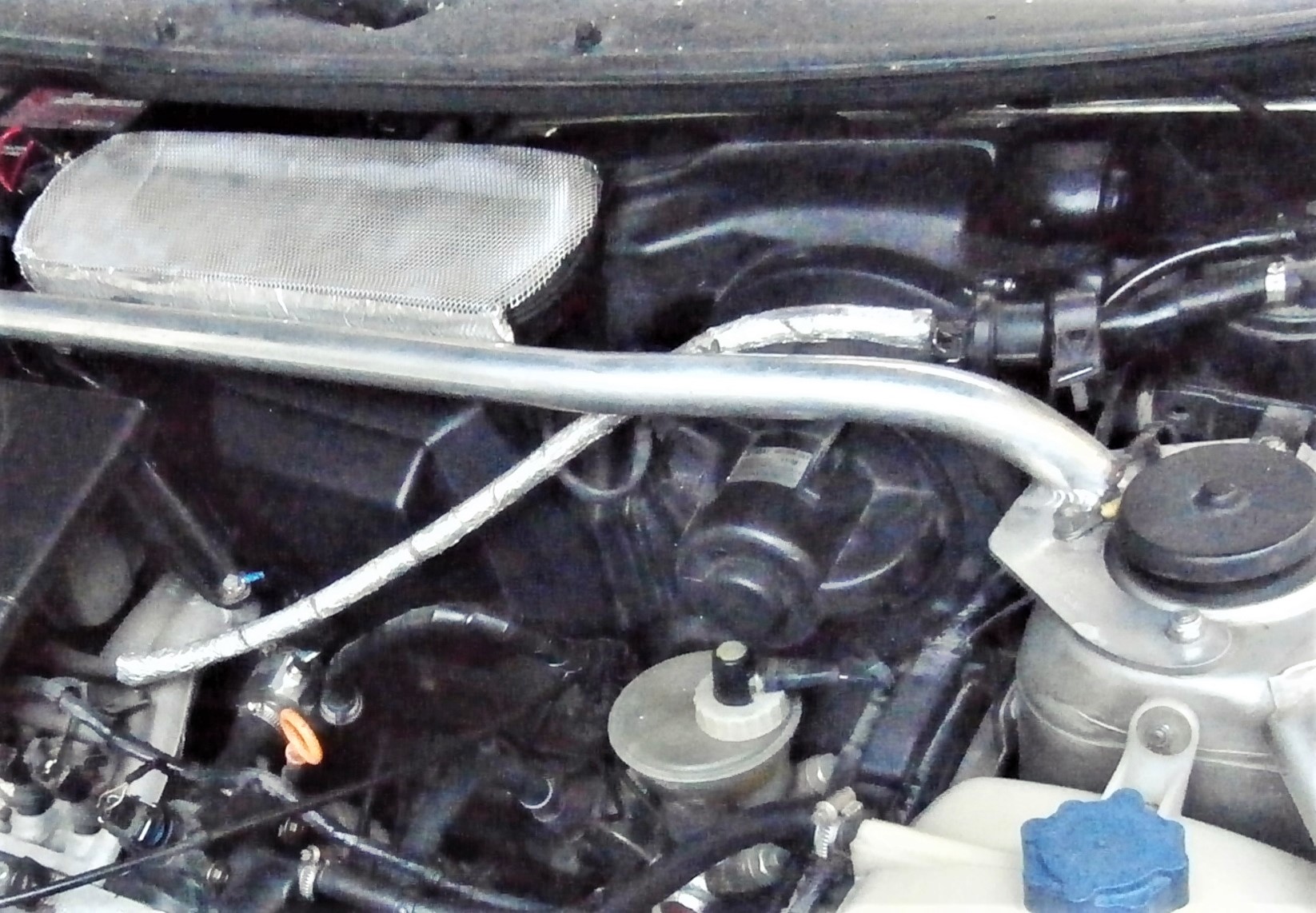

Here is an older photo of my Felicia engine.
After all these years i can not compromise with the idea that we haven't a cabin filter and only a foam.
There must be a way for a modification.
