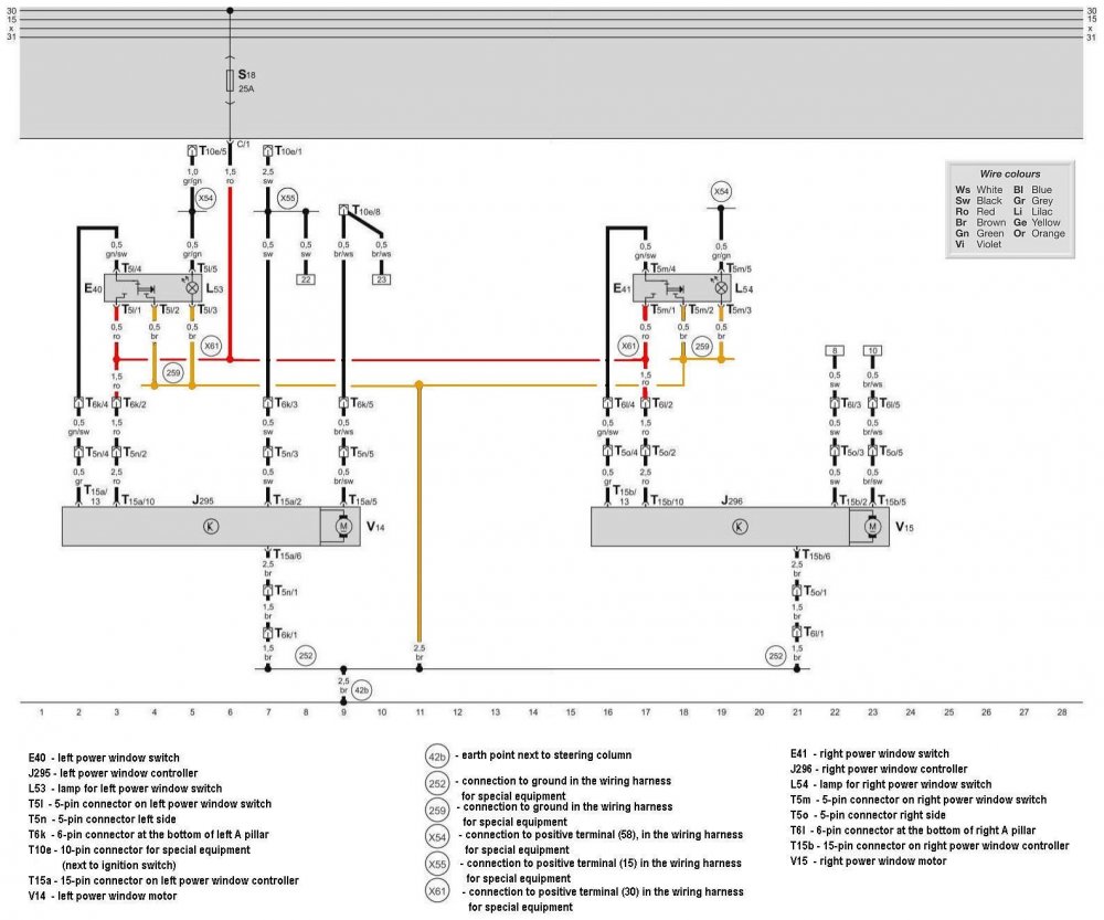

Hi! I am trying to fit electric windows for the rear doors on my felicia. The problem is that I have just the mechanism and without the original switch with the wiring.
Can anyone send the wiring diagrams for those which were fitted on the facelift felicia?
Note: Felicia didn't have rear power windows.

Yes, I know. I'm just using the same motors.
