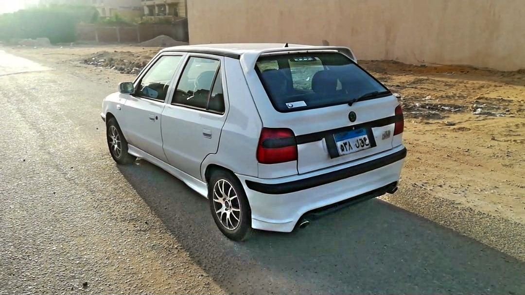

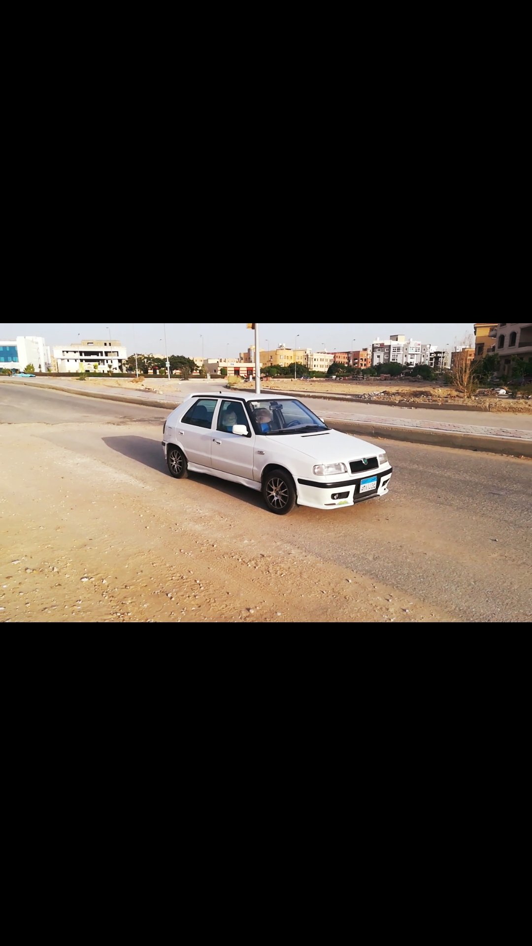

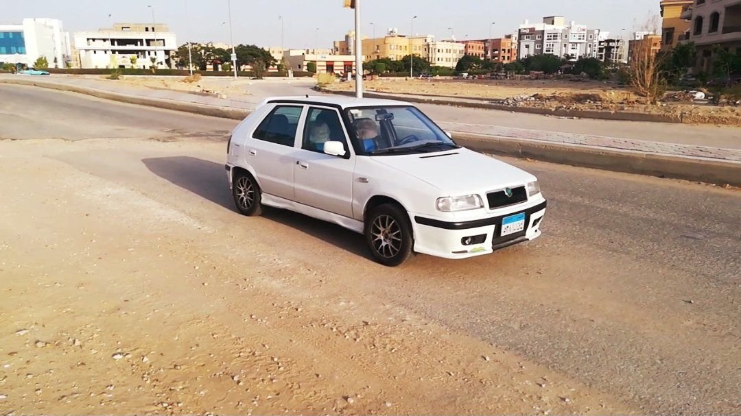

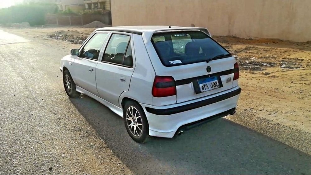

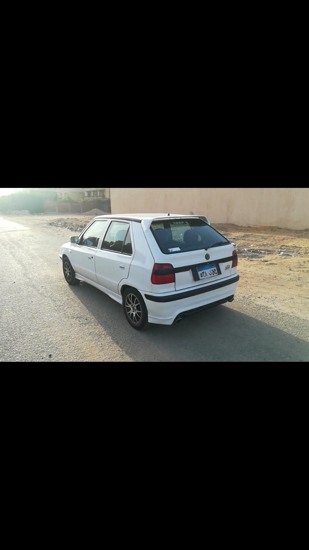

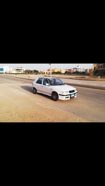

Hello. Here is one of my projects.
Model: 1998
Engine: 1300 mpi
Power steering
Air conditioning
What is your opinion?
Do you have some photo of engine's acessory holder? 1.3 with servo steering and A/C is very rare
