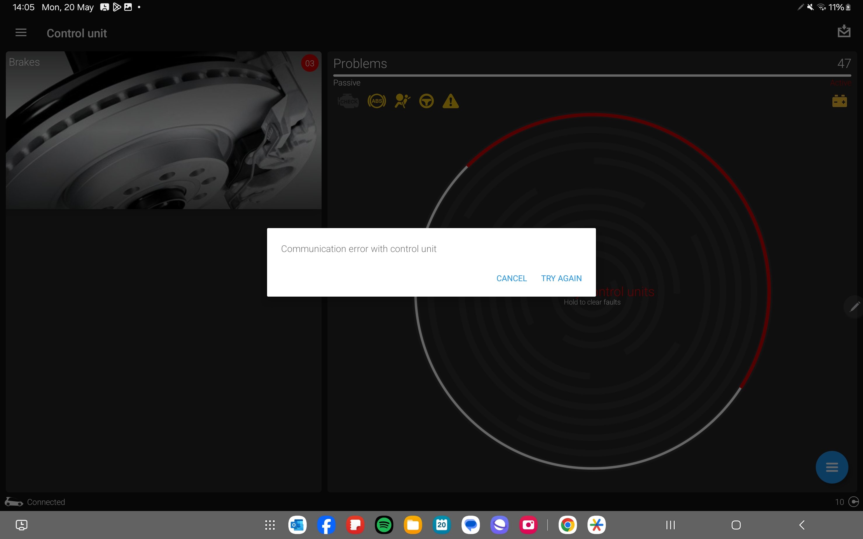

Good afternoon all my mk4 2.0 tdi has been suffering with no parking brake for a while now and after being sat at skoda for just under 2 months arguing too and throw about fault occurring 2 days out of warranty. I'm currently back to driving it with no parking brake. It's a dsg so has the option for Park but it's not really acceptable in my eyes and won't pass an mot. Skoda say they cannot find what's at fault and have been in contact with skoda technical. Who also can't seem to find the issue. The car has a 3rd party tow bar fitted but has been faultless for 1.5 years. When trying to do rear brake pad replacement the garage I used struggled to get any kind of response from a diagnostic tool to wind back the calipers. I then tried using obeleven having the same issues of unable to communicate with control unit. Eventually it connected and I managed to wind the brakes back. But resulting in a popping sound coming from fuse board / back of engine bay. To this day I have been unable to take them back out of service mode and so have skoda been unable too. They have not given me any direct fault finding other than a couple of times saying abs module / control unit failed. Can anybody help . ? Or give any advice for a repair in the Kent area

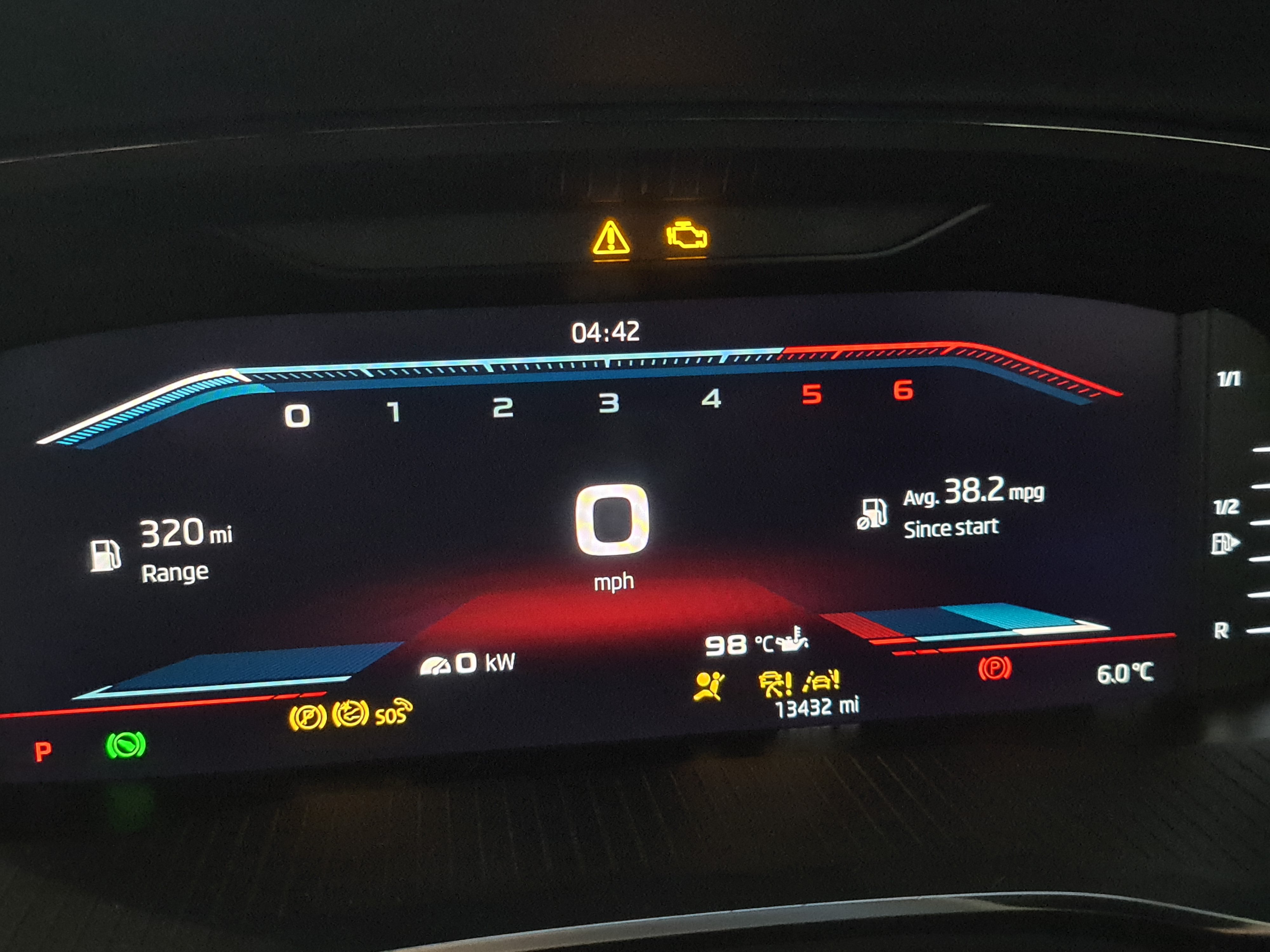

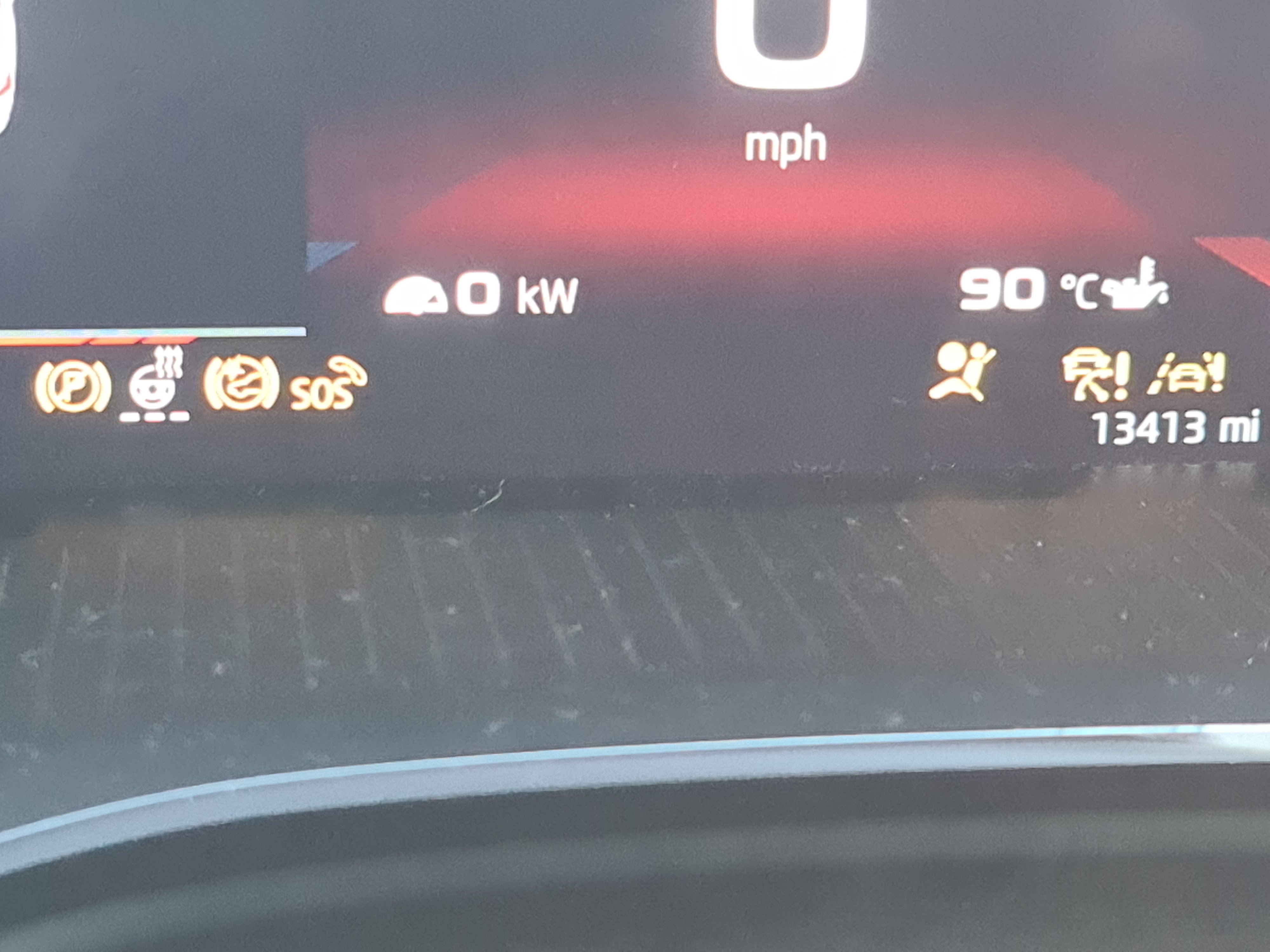

Yes & no, Had the car 10 months now and all I've had is electrical issues. I love the car and the way it drives but the faults are never ending. And get worse the longer you own the car. Photo attached is just the faults I've had on this morning drive to work.
