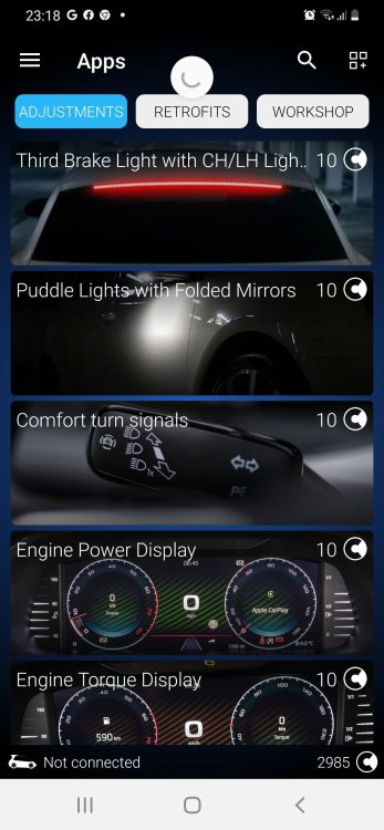

My OBD 11 is now has a list of App adjustments, power & torque display, mirror puddle lights etc. I've no means to verify that they work as I have a MK3.5 VRS245
Sorry, should have said, they are for the MK4 Octavia

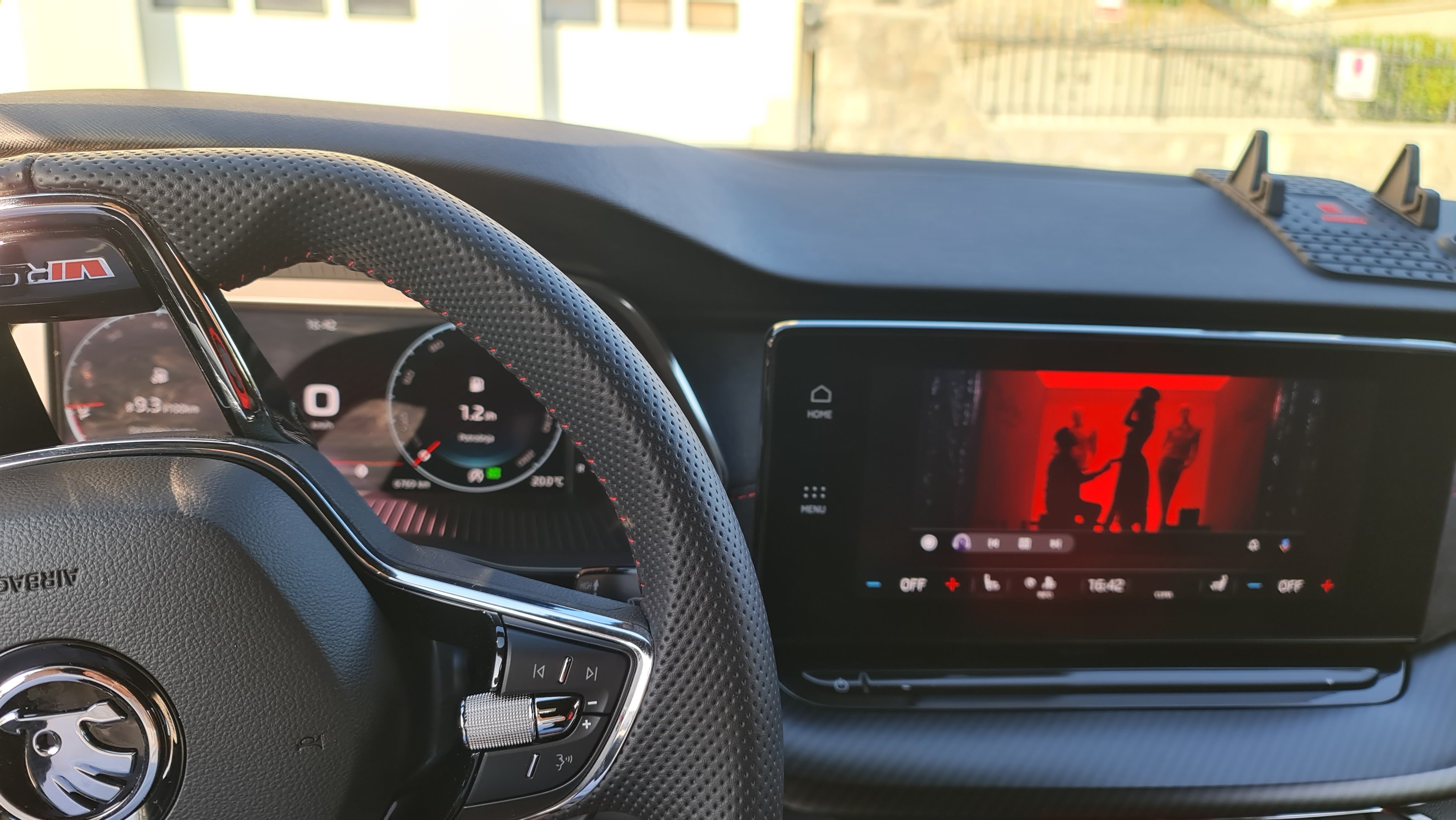

Ok i found out that we need to verify 3 steps in registration which was normal, then brake must be on, hood open, ignition on...  SFD unlock each module in aplication , not only 1 , u need to unlock all...after that u ll be able to do some coding. So i finally  managed to turn of seatbealt warning, drl etc, ok did you you findout that u can watch even you tube videos even with handy off, without youtube premium acc or watching tv throug mirror link but mobi needs to be on. And all that while driving a car

Hi! which modules or codes you used for this screen mirroring or youtube possibility?
Cant unlock. Still sfd protected.
How is the picture than made of Bolix? I see a screen mirroring right?
