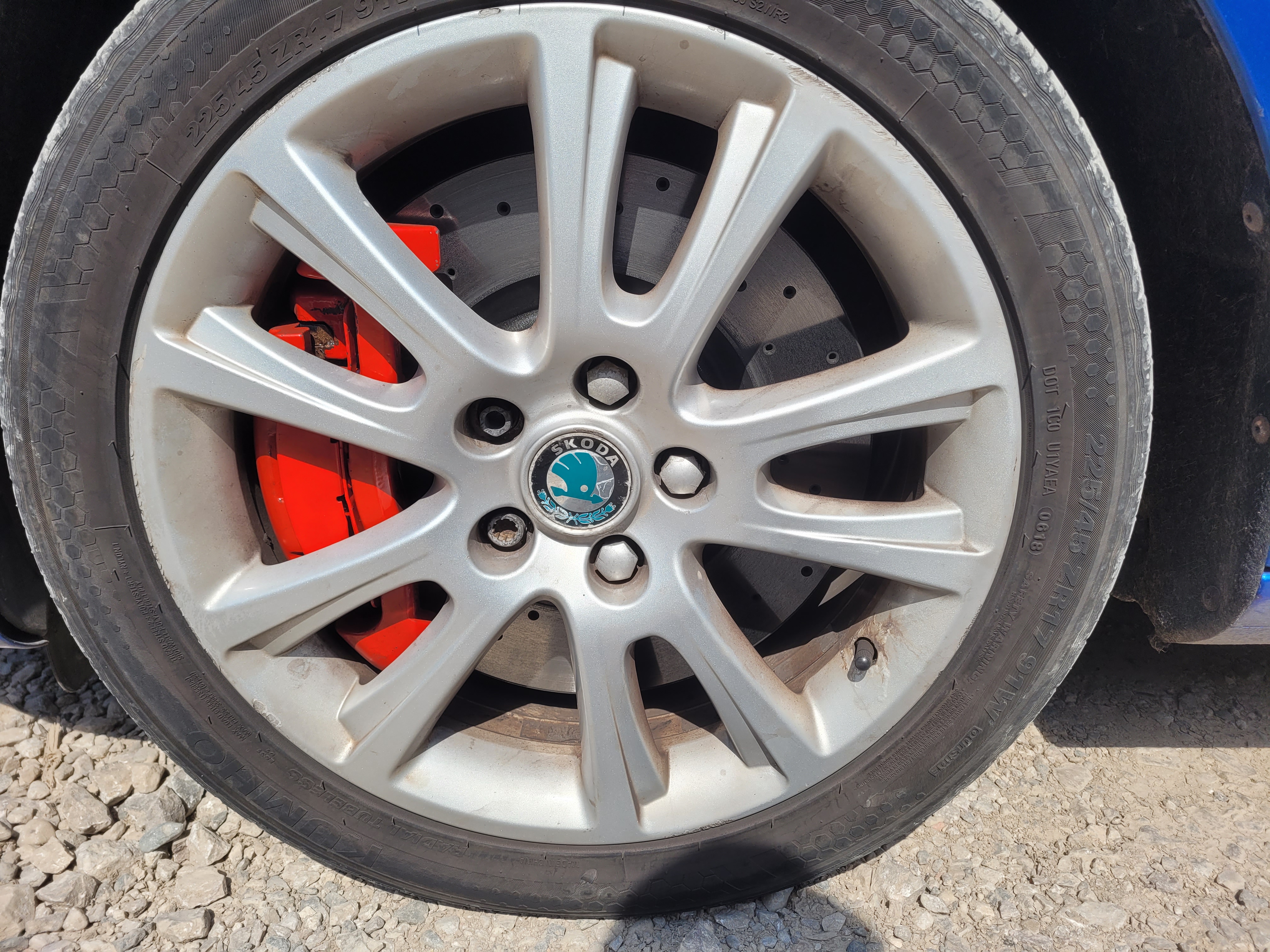

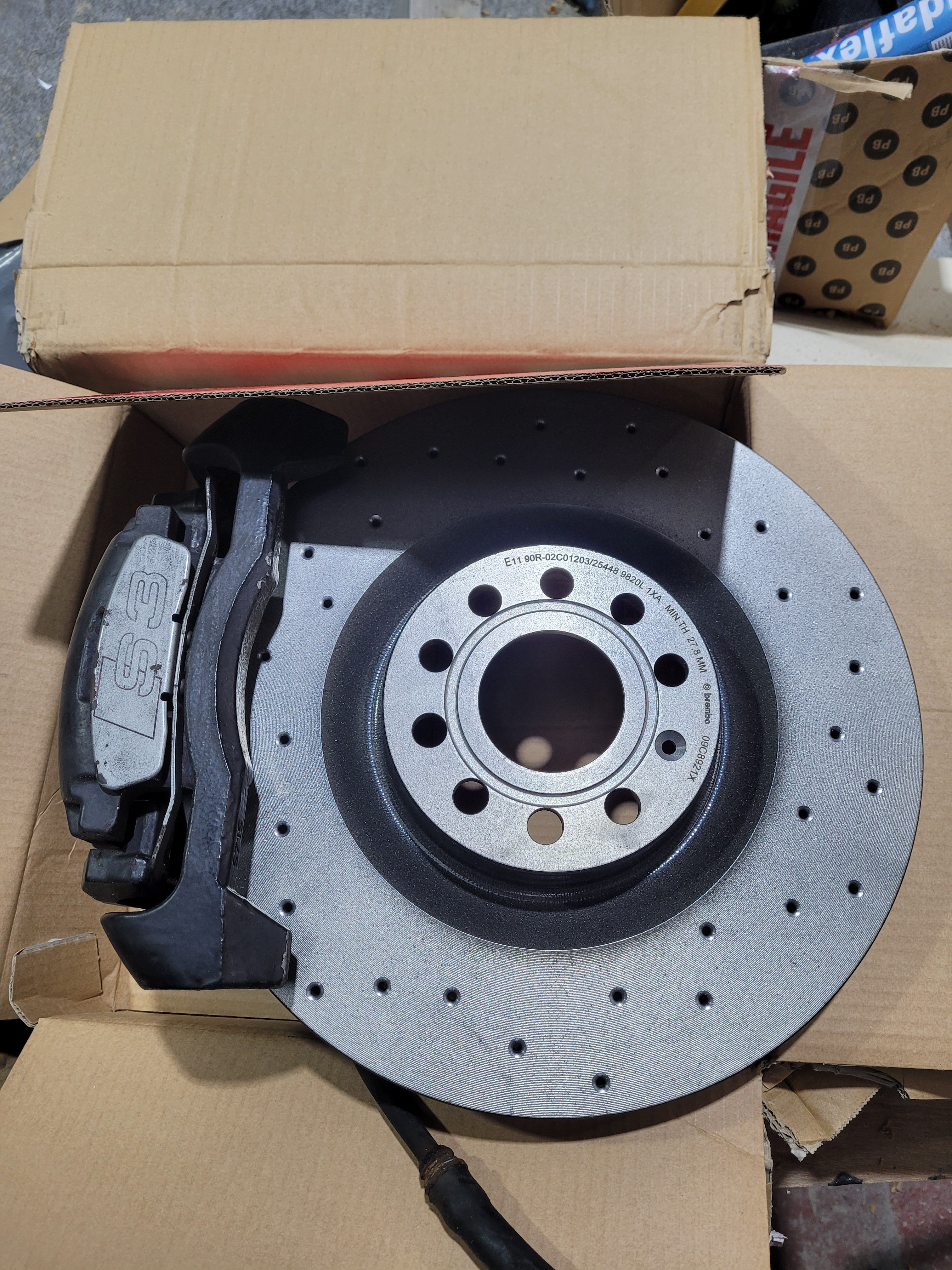

  2. What's wrong with the adjustable ones?
  3. https://www.facebook.com/711893365667754/posts/1614982762025472/ 345mm Calipers here for sale £180
  4. 8p and 8v are both straight swaps, the 8p uses 345mm, 8v uses 340mm disc. The calipers differ in design and piston size, I went for 345mm as it works well with the octavia master cylinder, the bigger piston would need more pedal travel before they bite. Discs and pads can be bought from autodoc, wait till Friday and they will be 40% discount. Match day madness. Hey, check out BREMBO Brake Disc in the AUTODOC app https://m.autodoc.co.uk/brembo/13801757 Hey, check out BREMBO Brake Disc in the AUTODOC app https://m.autodoc.co.uk/brembo/13801758 Hey, check out BREMBO Brake Pad Set, disc brake in the AUTODOC app https://m.autodoc.co.uk/brembo/13802391
  5. Have you thought a caliper upgrade? I run S3 345mm Brakes up front and use brembo high carbon discs and pads from the xtra range, they stop unbelievable well compared to the standard 312mm brakes that were on it.
