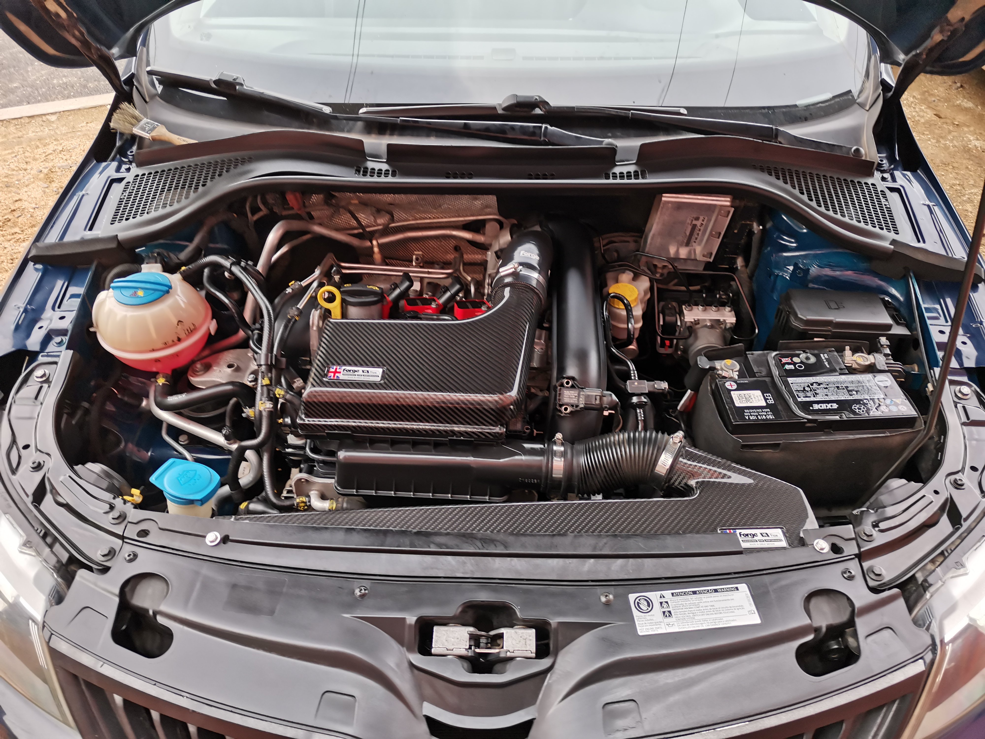

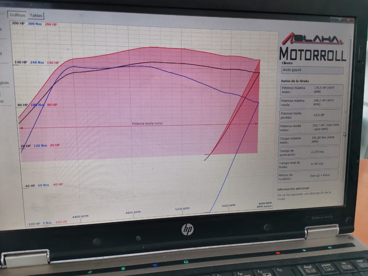

  2. Hello, I have a 1.2tsi spaceback to which I put a 1.4tsi 150hp turbo, apr coils, downpipe, revo stage 1 reprogramming, intake forge motorsport and I have another car compared to the same stock.
  3. I have the 1.2tsi and I installed that turbo plus downpipe, apr coils and I'm with stage 1 revo and got 170hp and a good torque line.

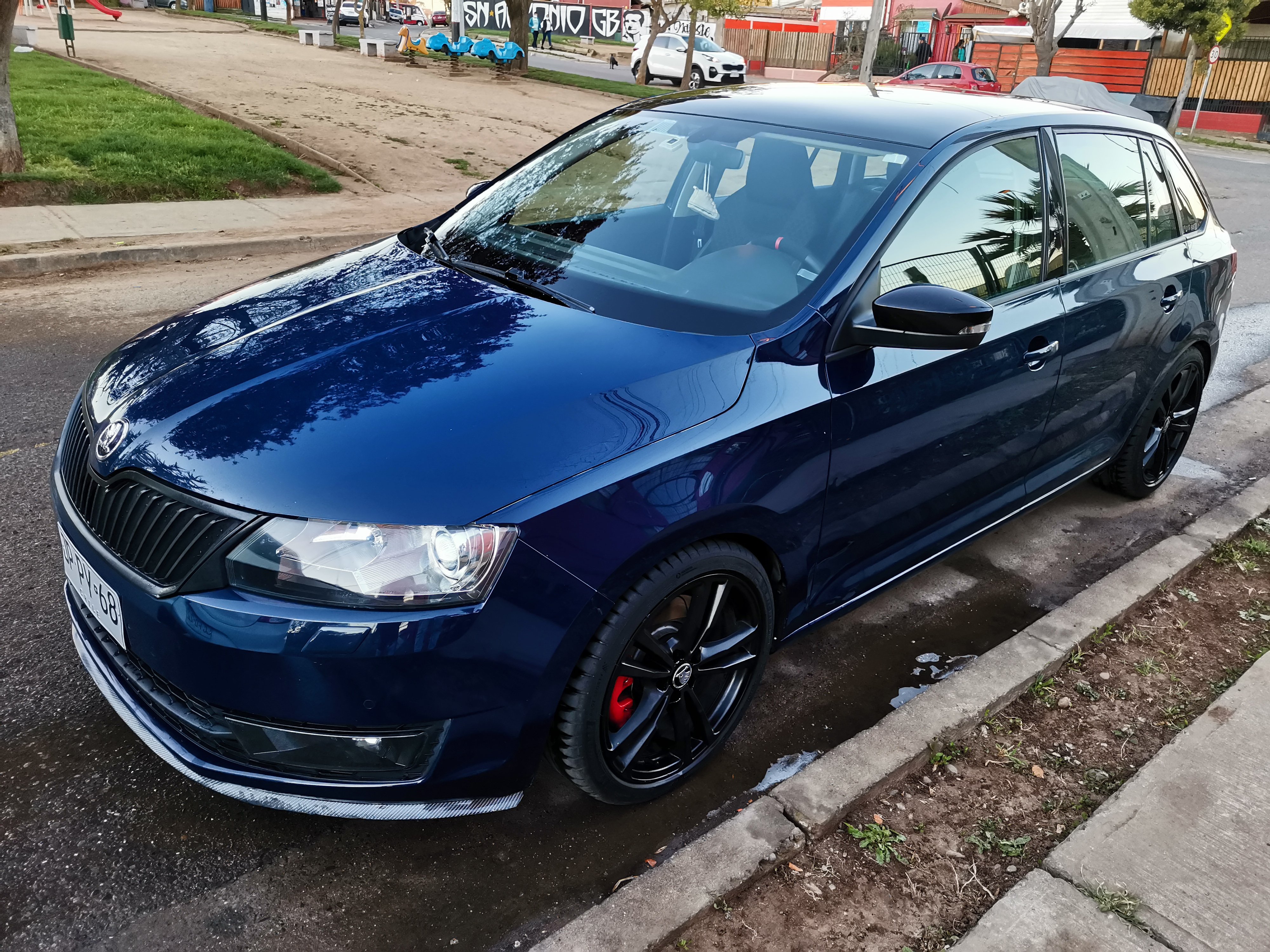

  4. inglés (EE.UU.) Sorry for my English (I am from Chile). I want to share my skoda spaceback project that I use for daily and to entertain me on track, it is a 1.2tsi of 110hp 2017, in the course of time that I have it I have made several improvements to have a kind of vrs. -Stage 1 revo (soon stage 2+ tvs). -Turbo of 1.4tsi 150hp -Carbon fiber forge induction -Inlet forge -Apr coils -Ceramic clutch -Front brakes 312mm -Rear brakes 256mm -Hawk hp+ pads -Brake lines hosetechnik -springs h&r -Audi s1 wheels -Custom downpipe -magnaflow exhaust -ttrs ball joint (camber -2 degrees) -ecs tuning bushings Rear h&r stabilizer bars soon. Thanks

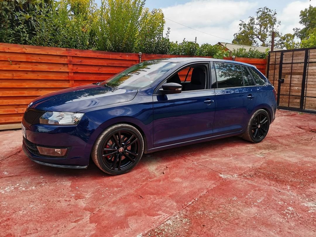

  5. Stage 1 revo wheels audi s1 downpipe springs h & r induction forge carbon fiber blowoff gfb brakes audi tt 312/256 coil apr More photos instagram @pedrofxentes
  6. It is a skoda spaceback same platform and with adaptation everything can be😂😂😁😁
  7. Carbon fiber forge intake is an extension from the turbo to the oem box and you feel the change.
