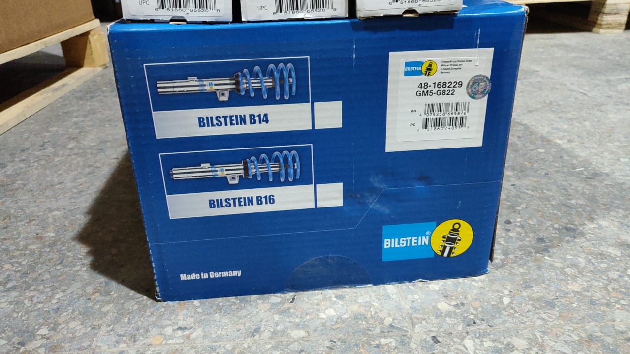

Hello Cristian, please, can you check the clearance from the wheel to the coilover when installed? I have Superleggeras 17x8 and there are milimeters between wheel and OEM shock.
Why you choose this bilstein reference instead 48-146852?

Hi! Haven't installed yet. Ordered a kit from ECS that hasn´t arrived and I want to install this thing right from the first time.
The wheels, I checked the OZ wheel catalog and based in that, I made the purchase, I tried some oz crono 17x8 but they rubbed.
As for the bilstein kit, here in Chile we don't have the itv tuv or mot you have in europe. This kit is made for the mk3 fabia, wich uses, the same shocks of the mk2 vrs 6R/6C CODE. Weight wise, the same axle load +or -

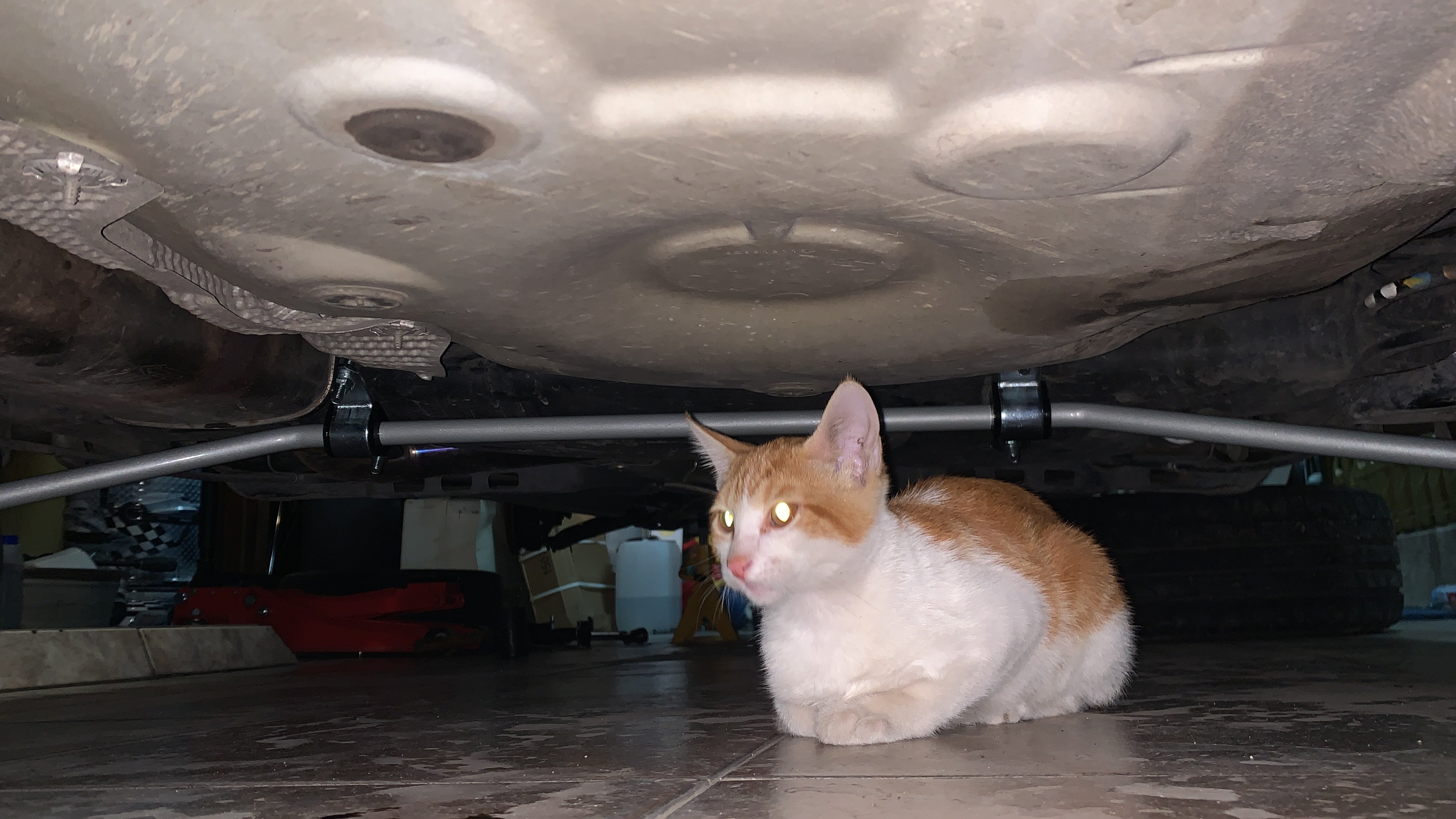

My cat checkin the rarb install.
went for the whiteline in the hard setting!

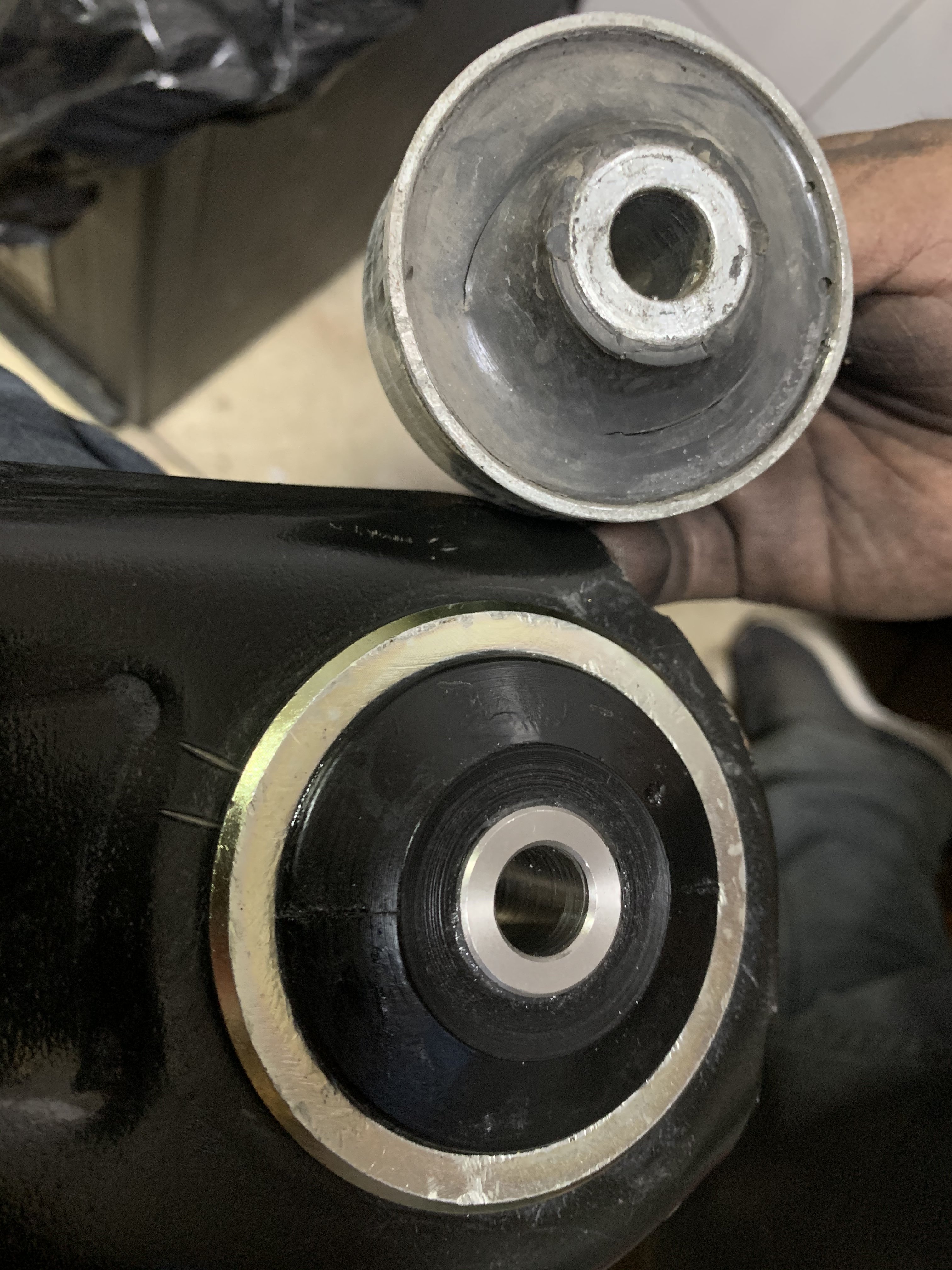

A Quick check before Trackday and the whiteline bushings are gone!
replaced them with some powerflex black series
HUGE difference!
Well, went to the nearest track I have, dropped the times and all I can say...
JUST FIT THE RARB!!!
amazing how it can transform your car.
I know there are various brands, but just go for it!

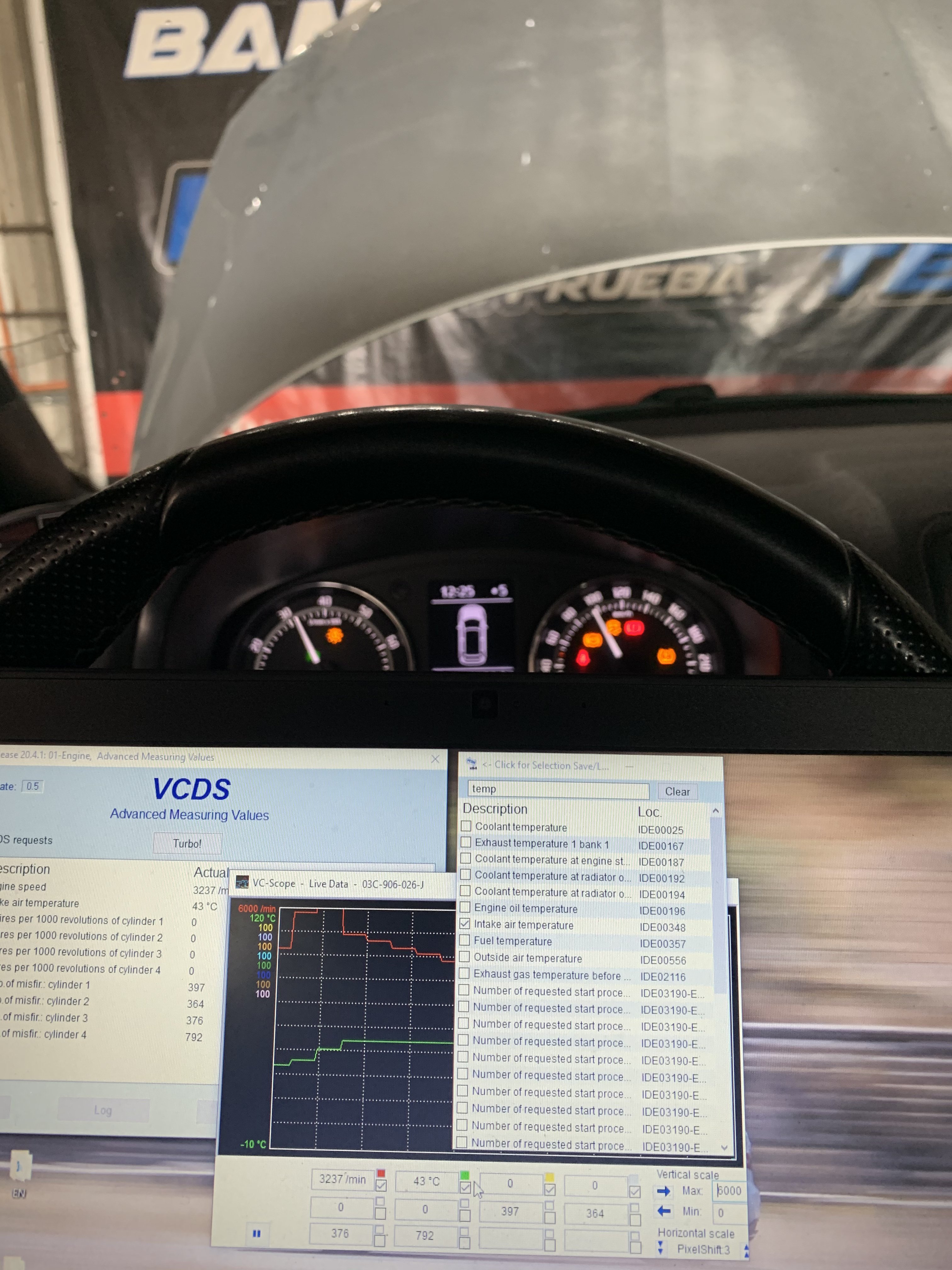

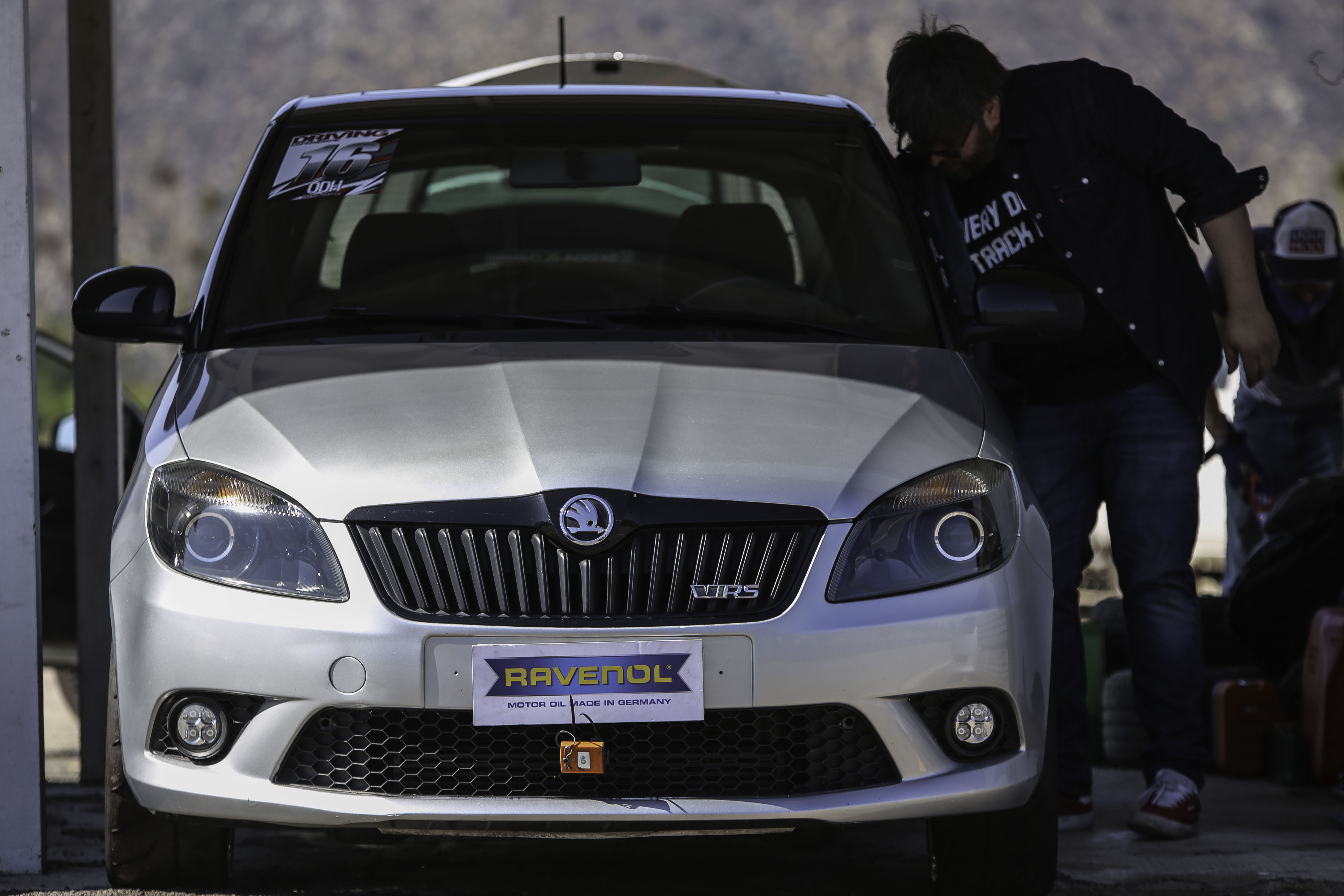

Hows the engine handle the heat and humidity there? Hotter parts of the world such as Asia and Australia the mechatronic rally suffered with the high humidity in early CAVE builds.
Looking good.
At the moment not giving any trouble whatsoever.
coolant wise, using mocool, replaced all the g13 from the system.
dsg shows same temp all over the day, 6 runs of 8 laps each.
As a caution measure, will change the dsg map. Tvs or rtmg, still trying to know experience from other users but none seem to take this to track that much.
Engine oil, reaches 120 /130 Celsius.
Using Ravenol RUP 5w40. No signs of oil usage. 10.000 km service 450cc of oil.

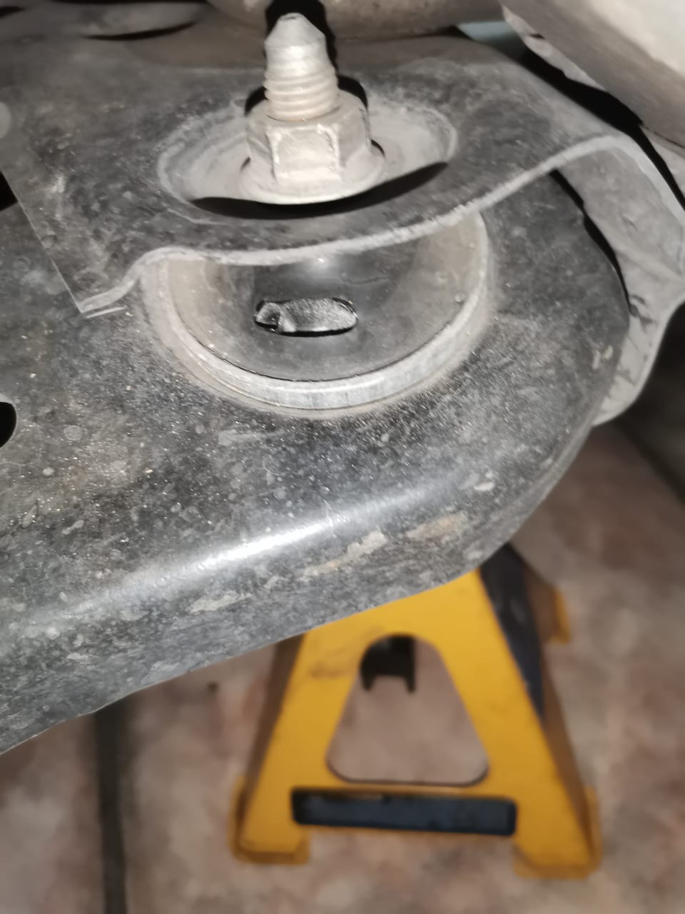

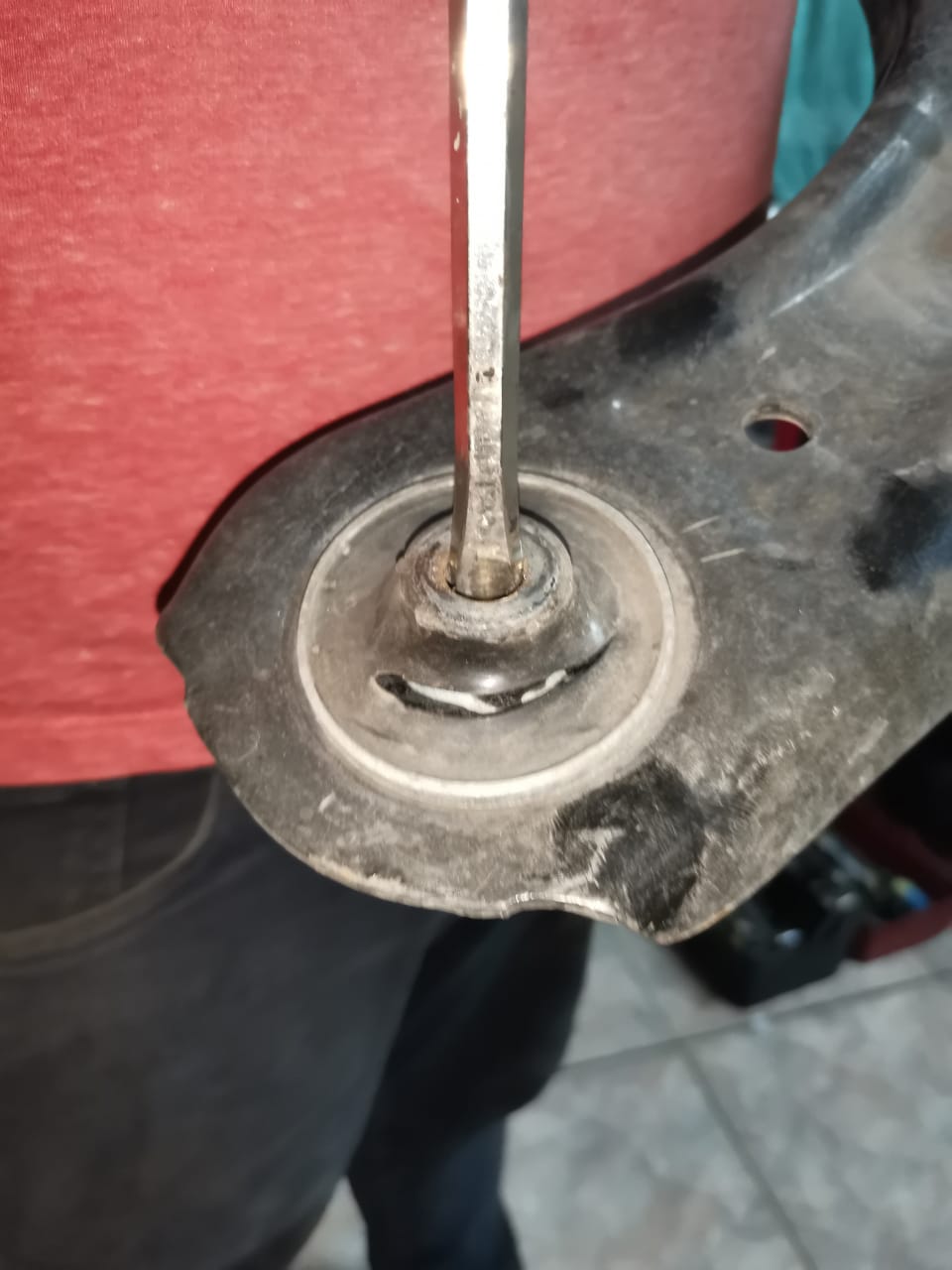

Love that colour. What benefits do the TT ball joints have over the standard unit? And do you have a link for where to get them? I'm planning to renew some of the bushes soon so if I can fit better parts at the same time I can kill two birds with one stone.
TT joints basically give the car -1.50 degrees of camber not too much, not much like the mk3 lower arm which is longer and by itself gives you -2.50 of negative camber. If the car is a daily driver, the TT will do the trick. If it’s used as a track “weapon” the other is the option but may require washers to avoid the cv joint to pop out.
Did not know that. I'll keep it in mind, thanks.

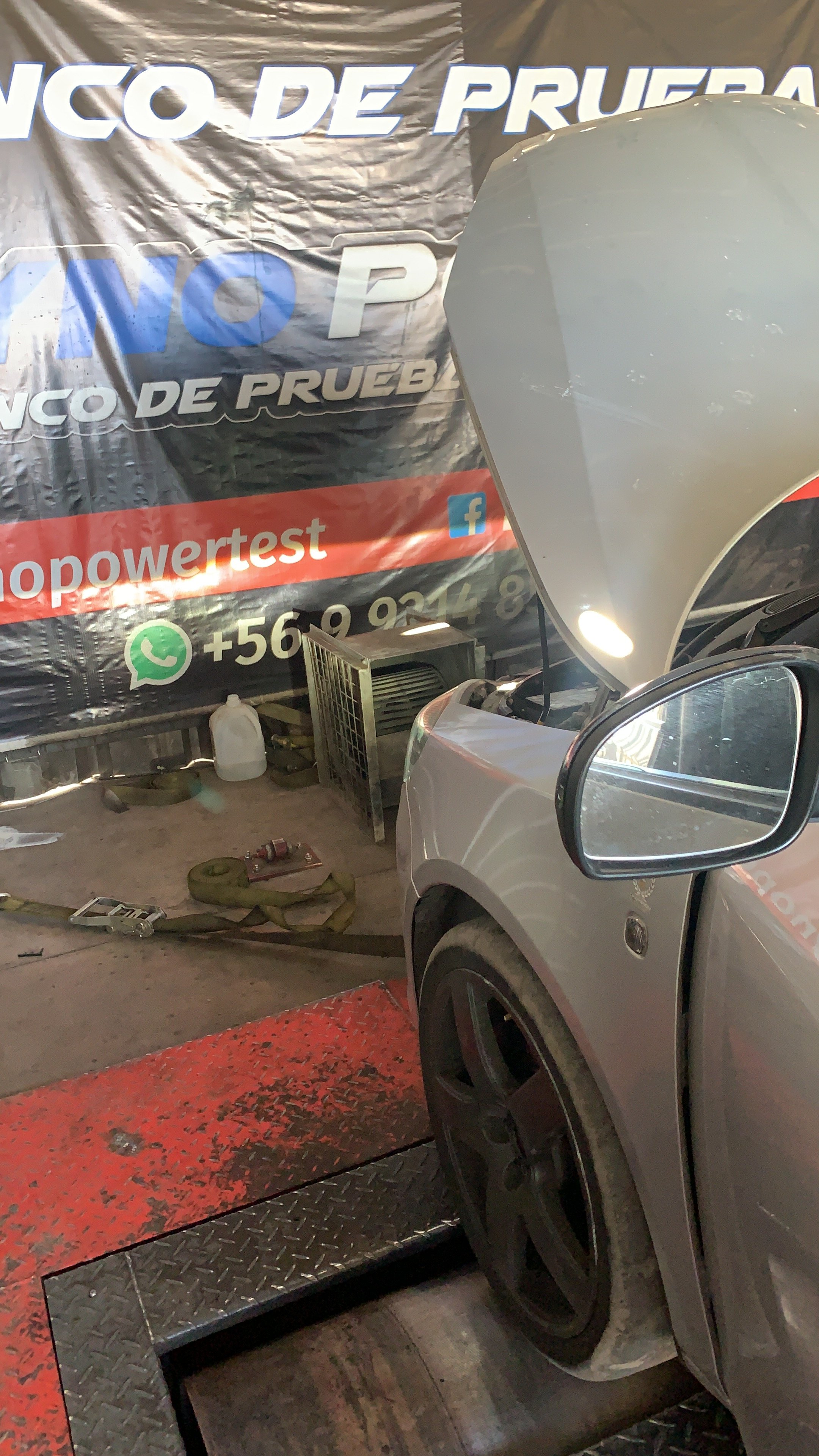

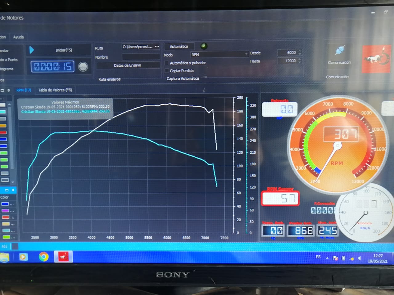

Went to the revo dealer and couldn’t resist to make it stage1
The fabia went from 169 whp to 193 whp
Feels a lot more top end than stock, assuming that I’m putting sooner a 200cel cat downpipe, I hope to pass the 200whp barrier.

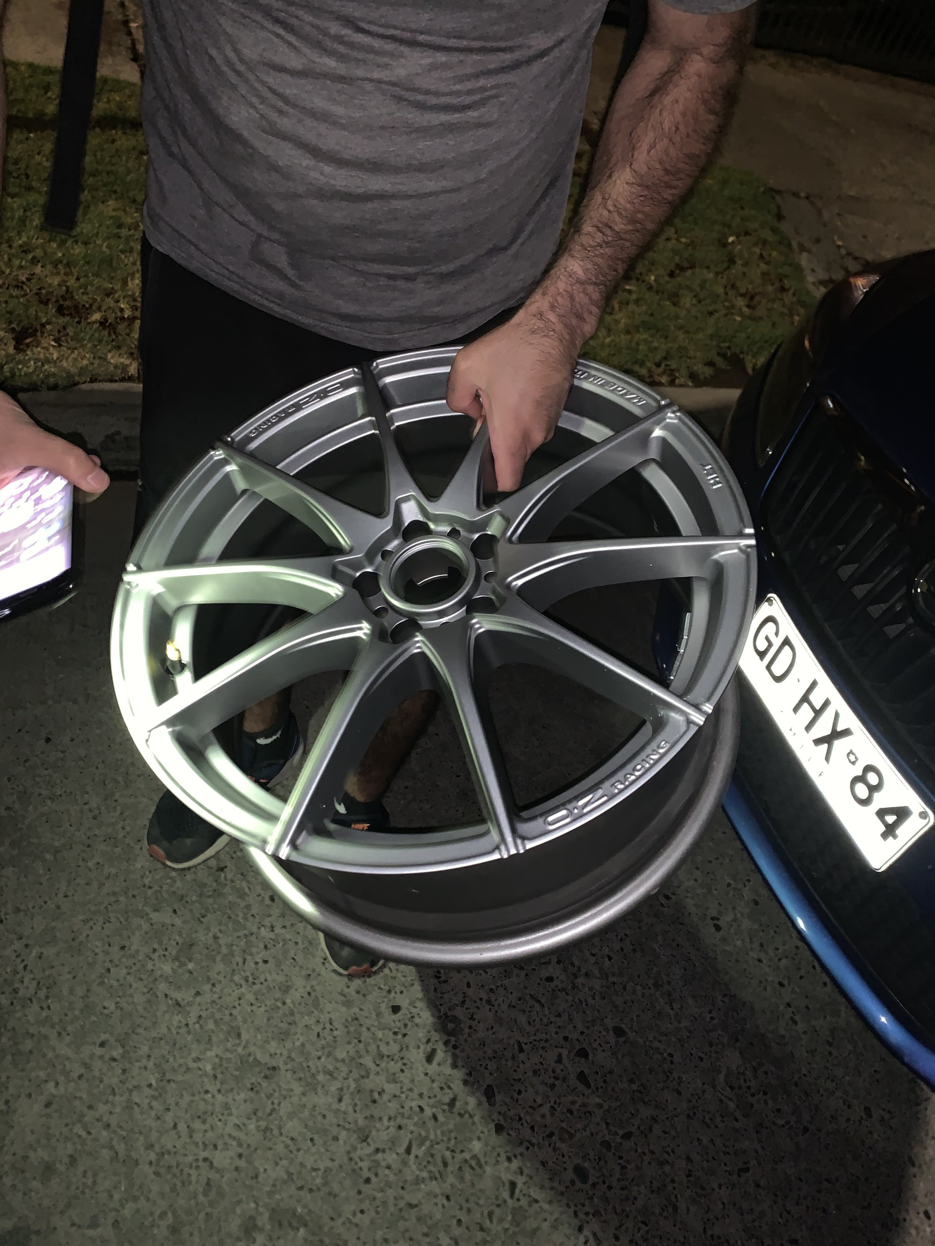

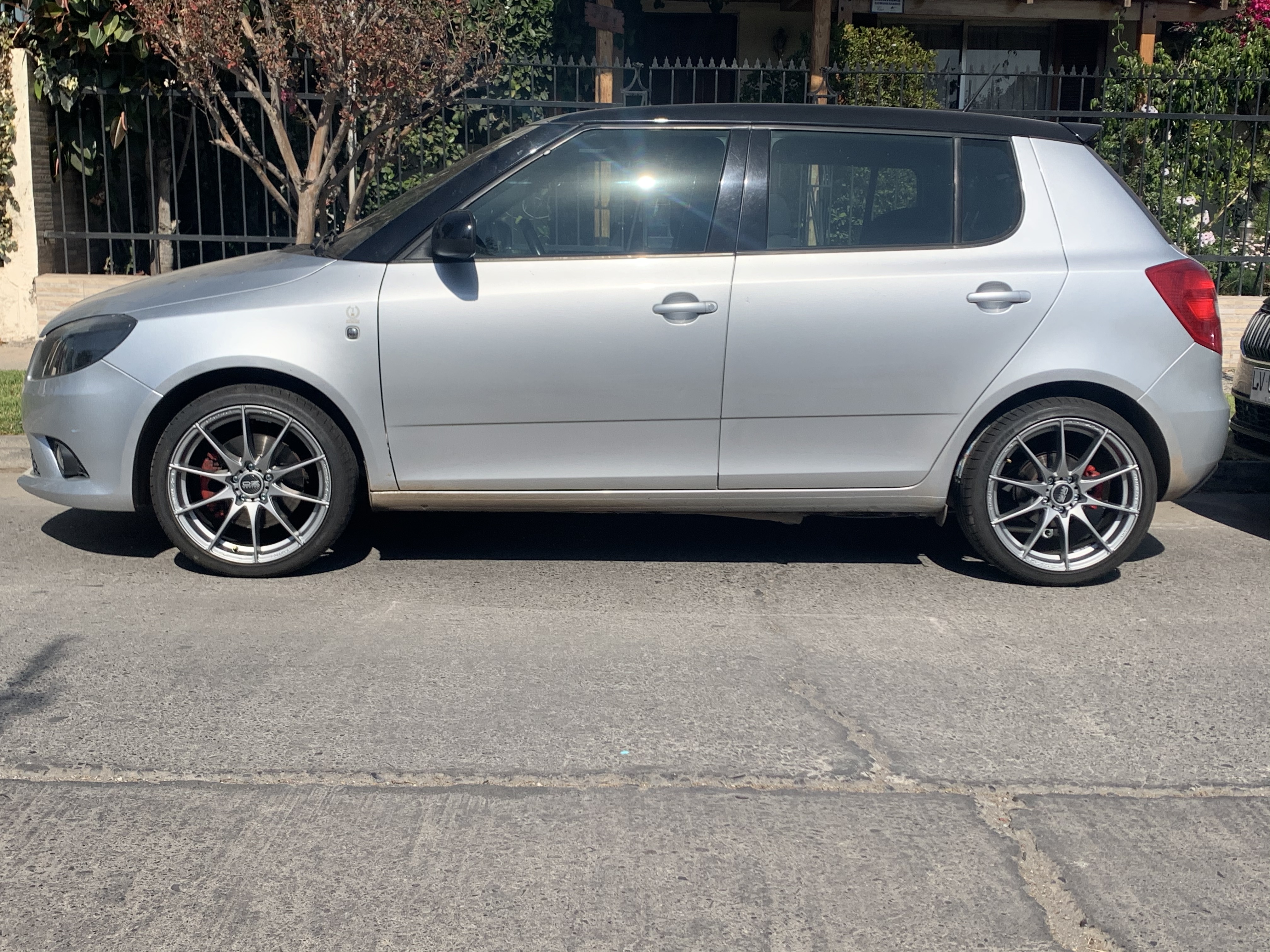

Well, oz formula doesn’t look right to me. Soooo gotta find some other wheels for the Fab.
still waiting for the front strut tops so no bilstein yet. Std springs
And I’ll keep this as a track wheels
vw (borbet) take five wheels 17x7 et38

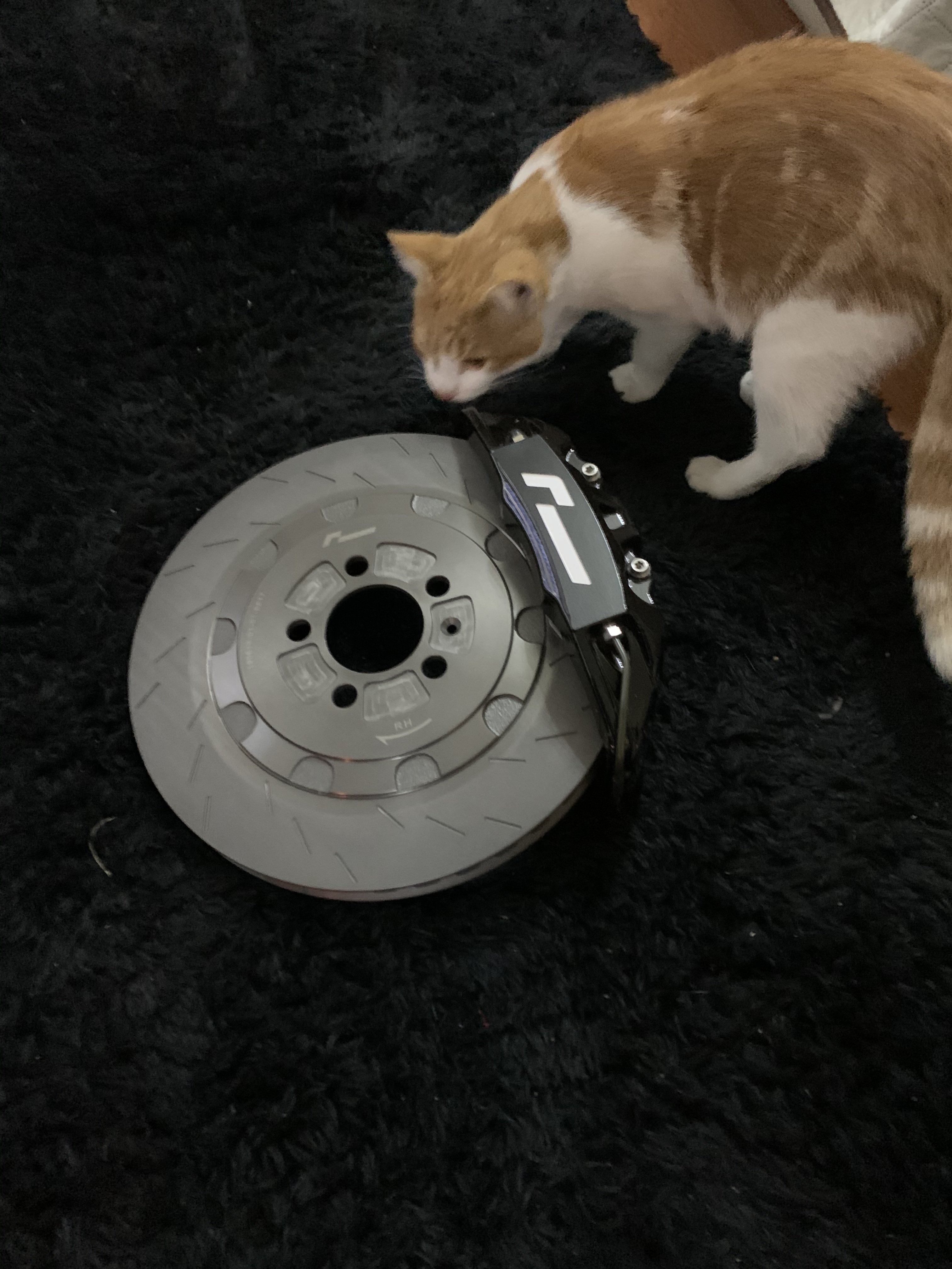

Another upgrades for the project
-racingline big brake kit.
Lightweight as can be. Less than the original set intended.

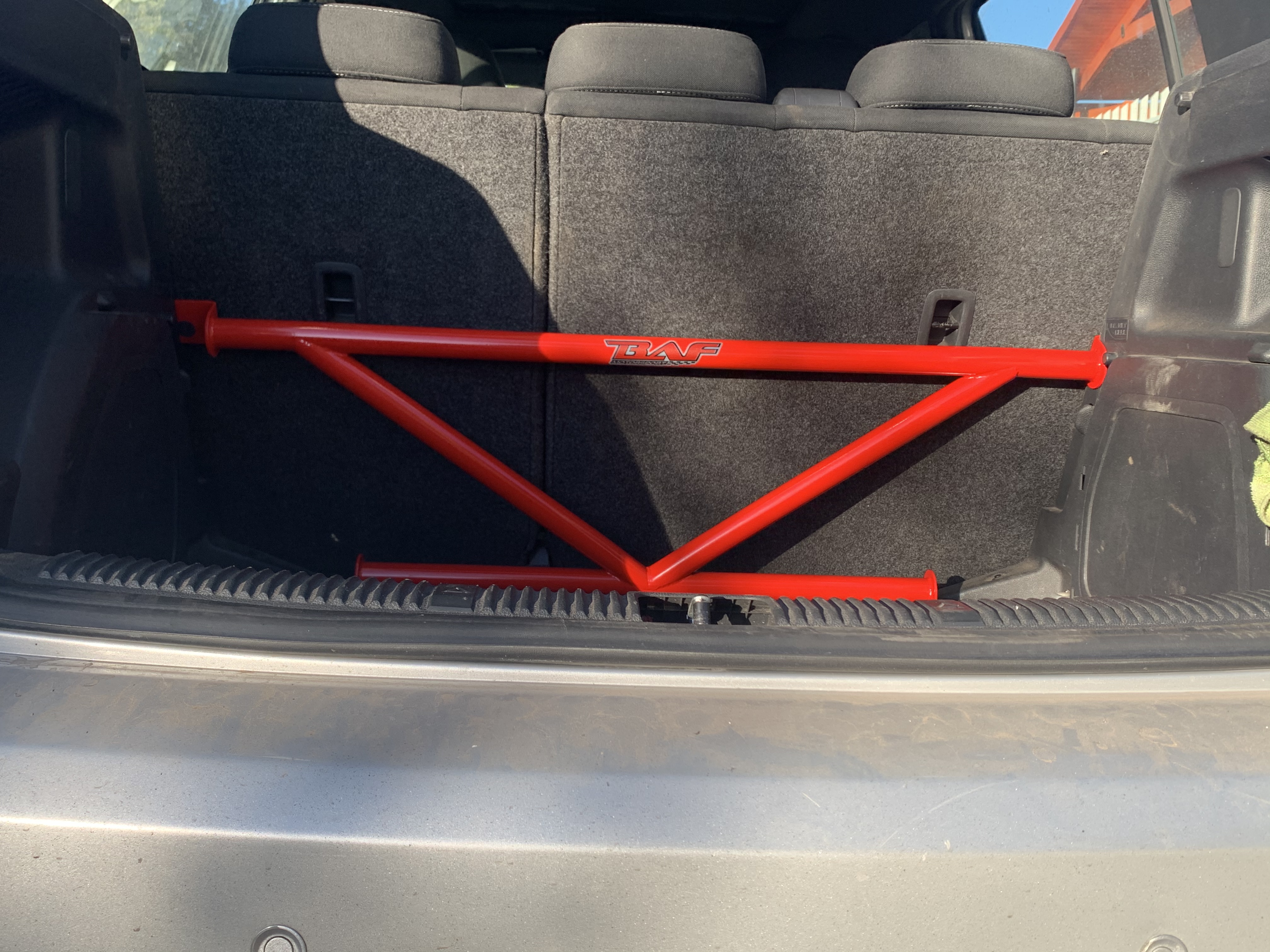

- baf motorsport K brace
I was searching briskoda, and some user had that intalled. So, went for it. I pretend not to use the rear seat as I did in the former “track” fabia. As soon as I removed the seats, it felt more sloopy on corners so, K brace it.

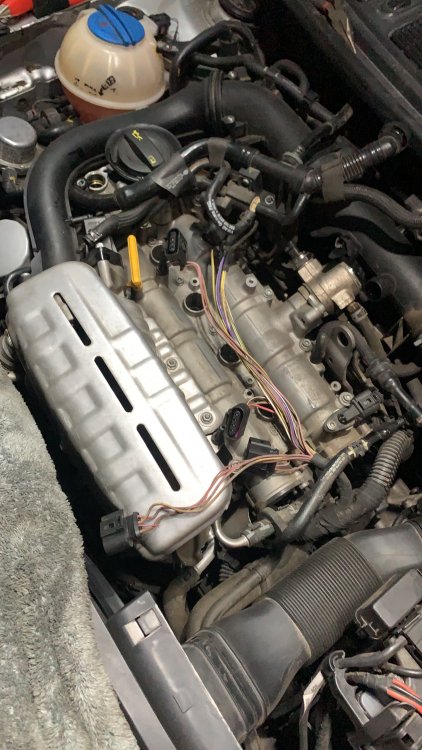

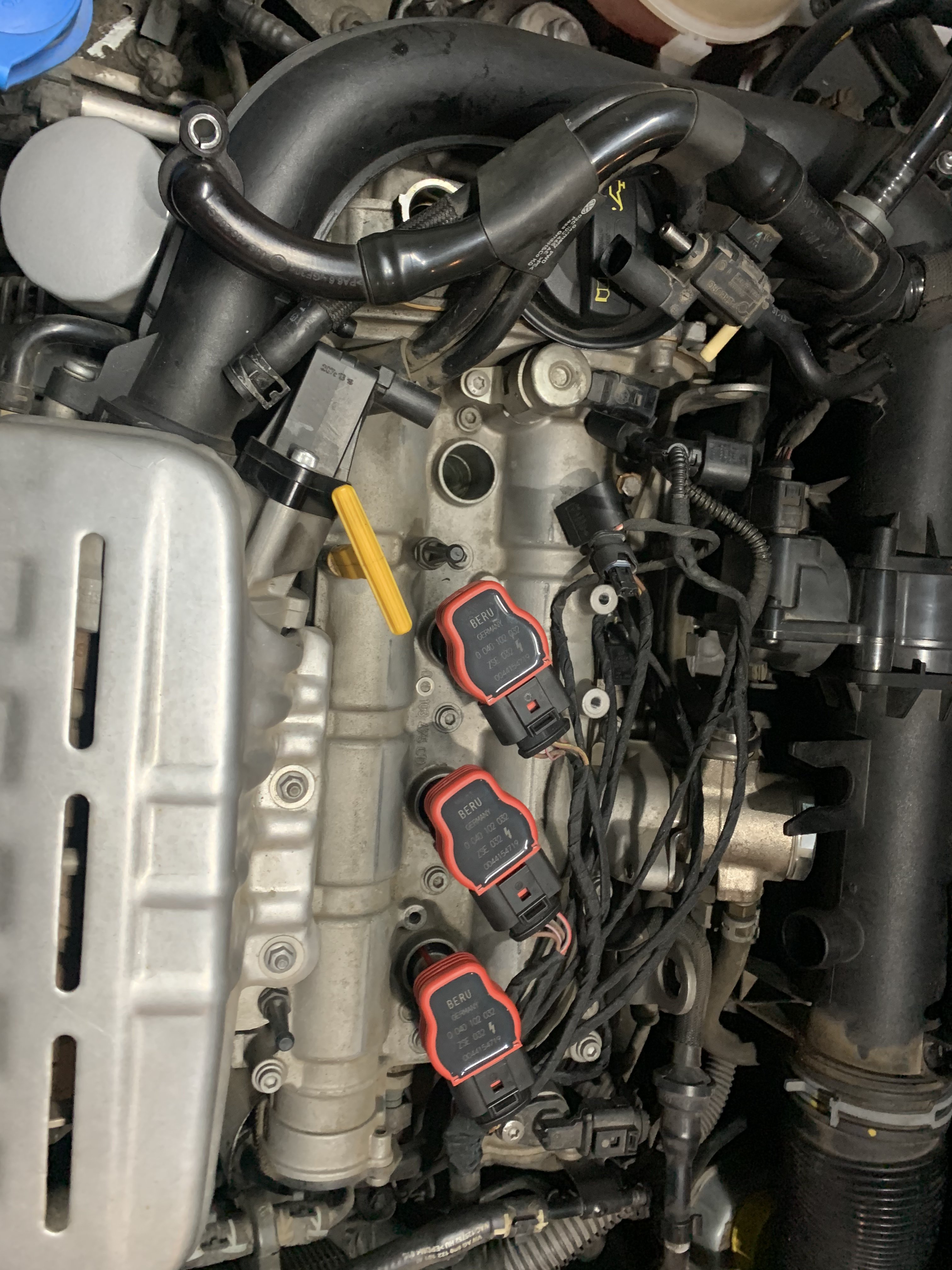

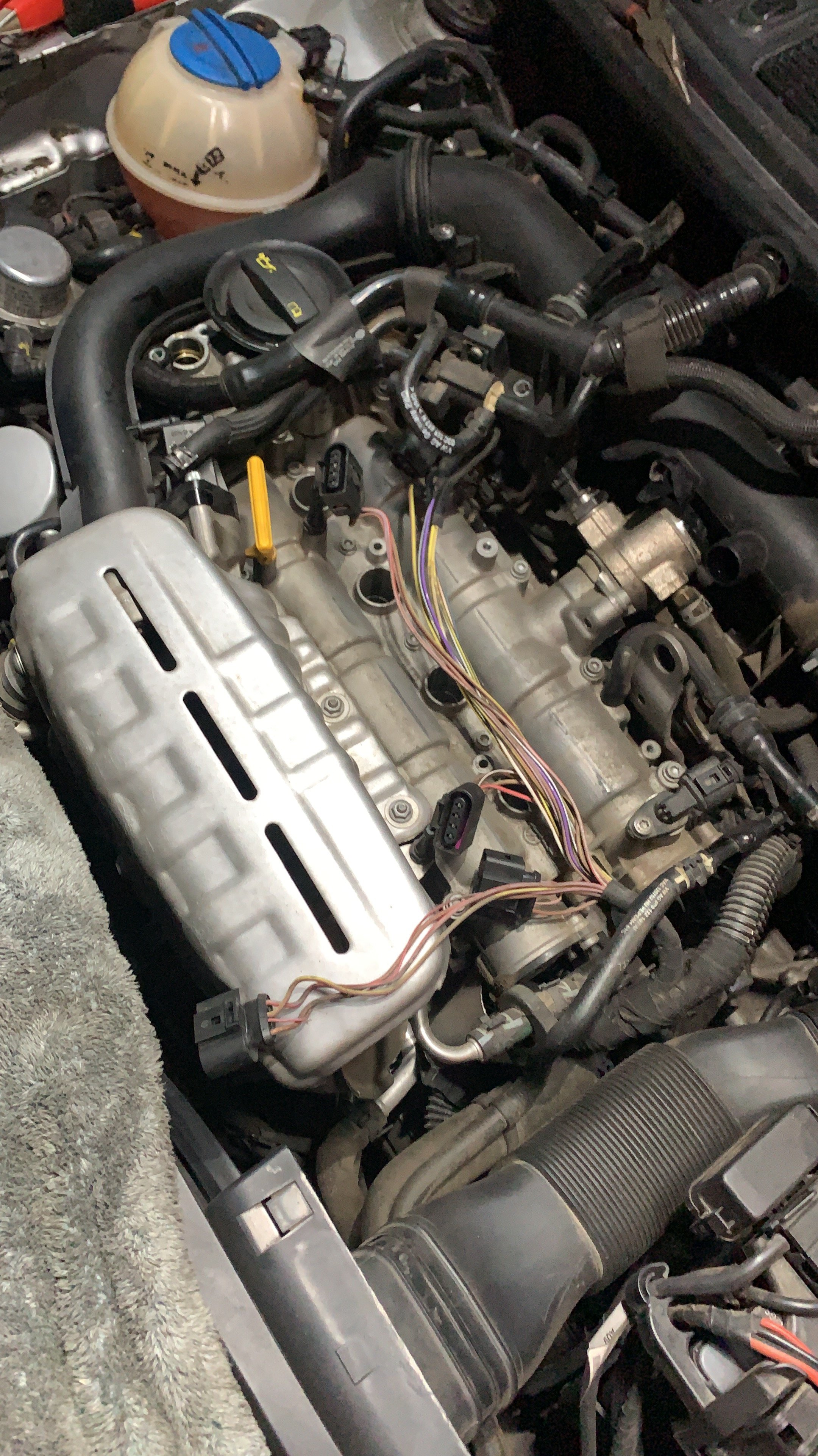

And well, R8 coil packs
Used the Beru ones instead of NGK and went straight to the dyno. No misfires, aaaaaaand! More power.
Previous Dyno run
169 whp stock
193 whp with revo stage 1
202 whp with the R8 coils
