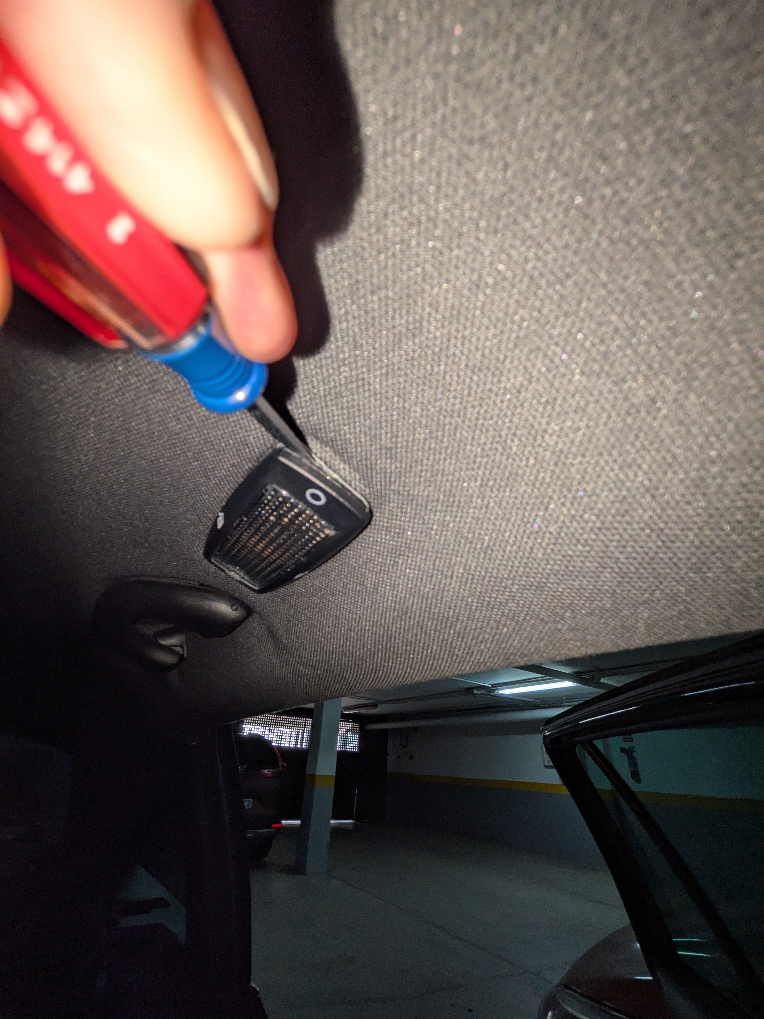

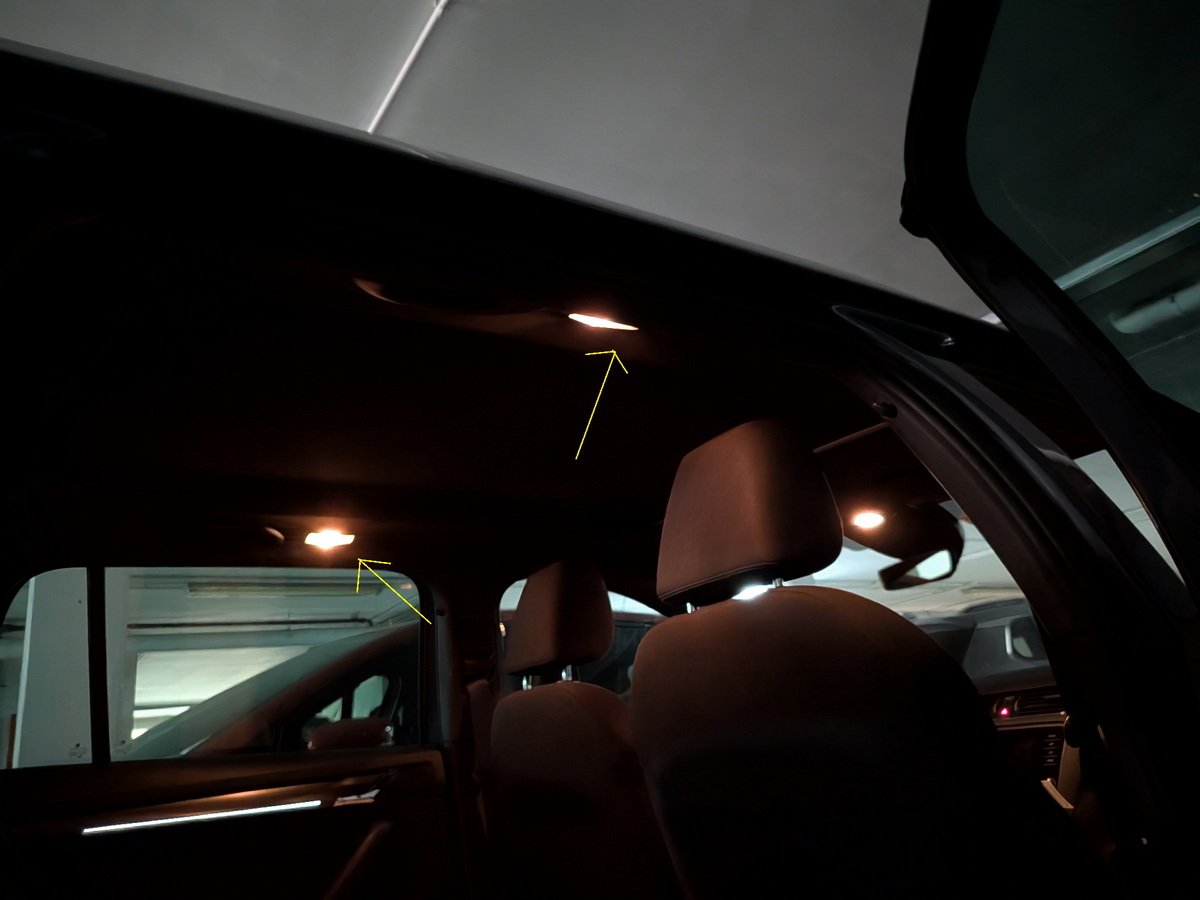

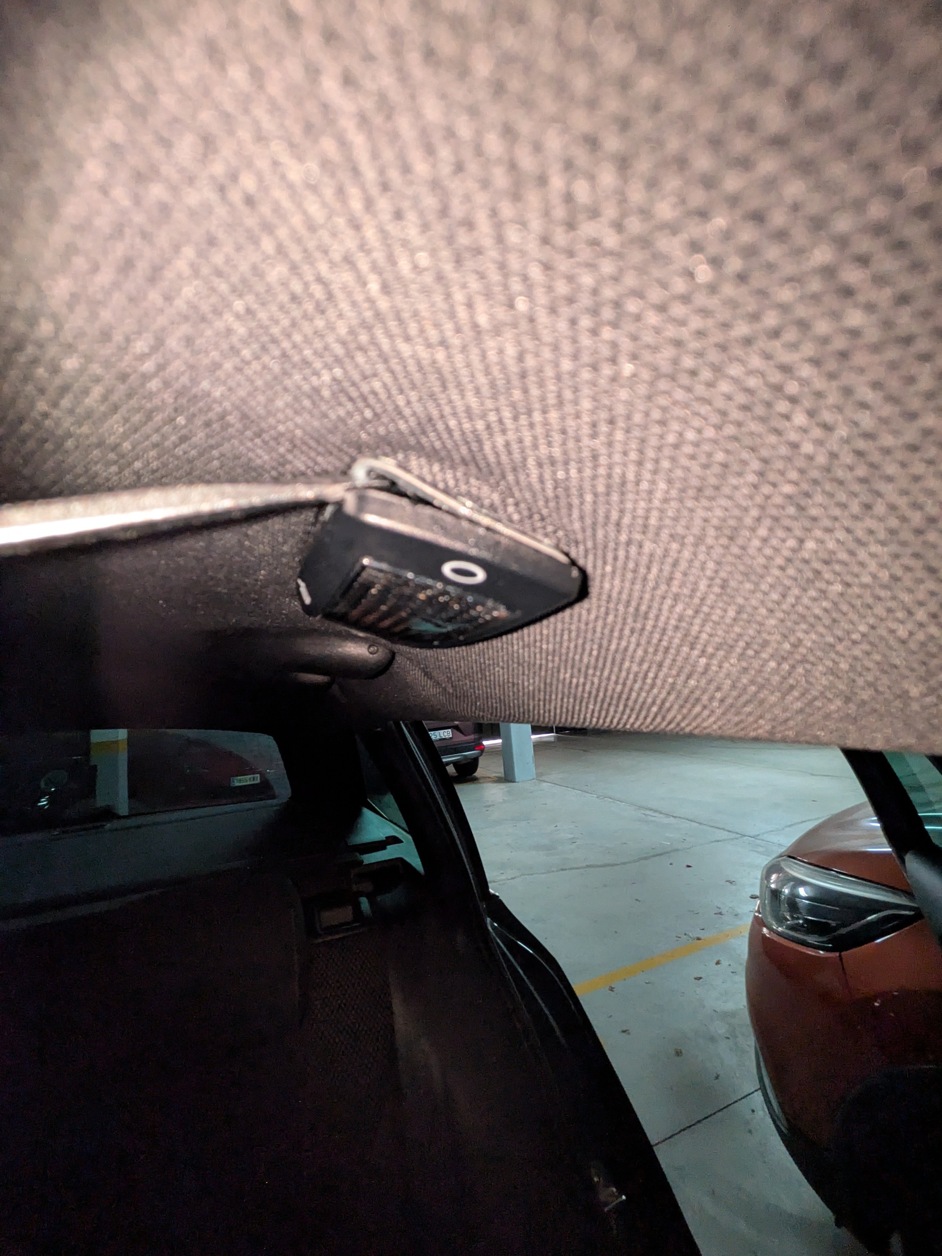

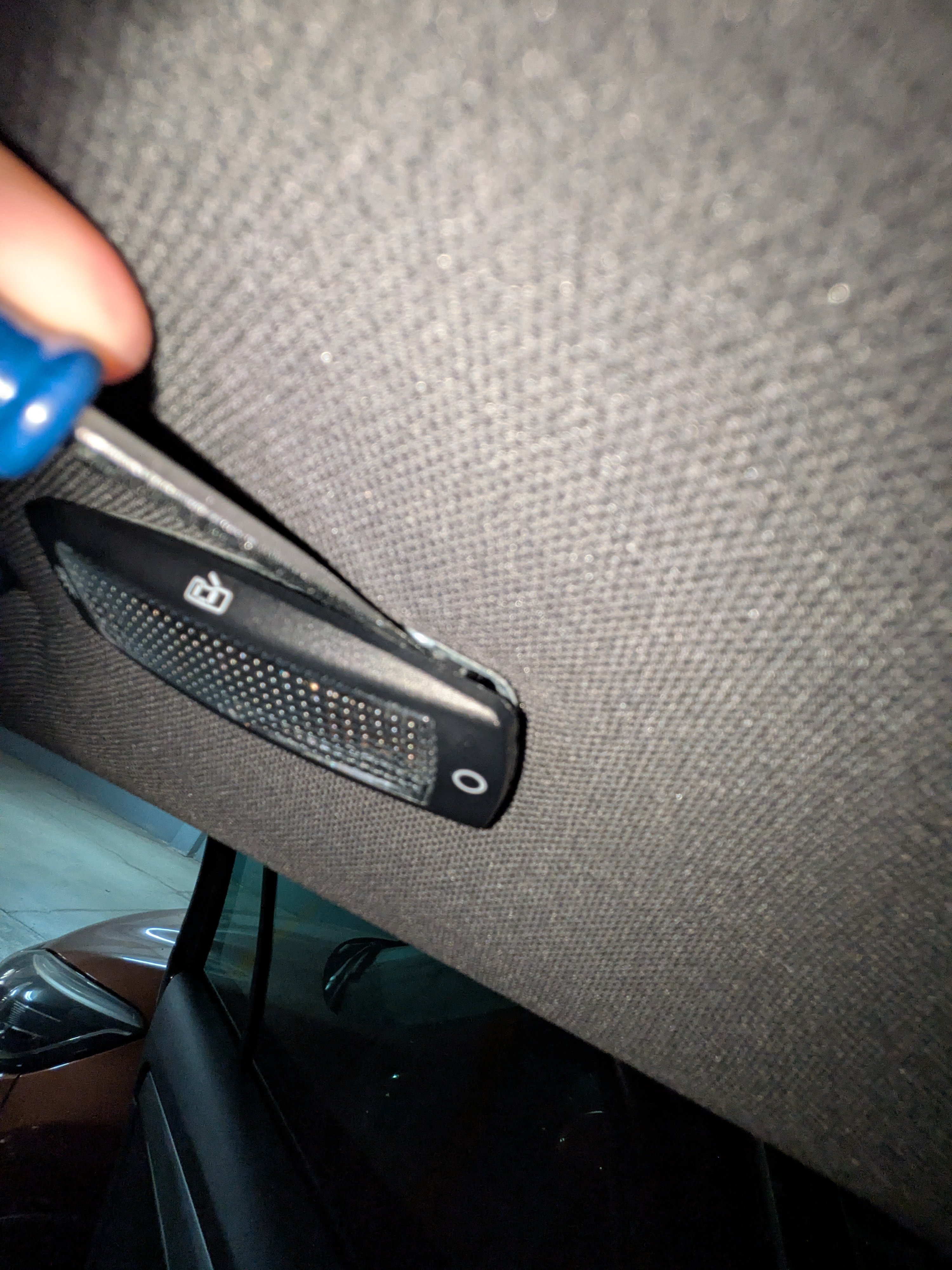

Over rear-passenger door bulbs replaced. I remain flummoxed at how difficult it was to get those light units out of their metal frames in the roof. Snapping them back in was a .. snap (you knew I was going to say that). I hope these new LED bulbs last a long time; I do NOT look forward to having to extract those things again! Next stop: front reading lights! (I'll post a new thread). Thanks again, all, for the guidance! -Jay p.s. Not sure if I posted the specifics: Rear cargo area flat-ish lots-of-little-LED bulbs (flat-ish because they have both a flat section, with ten little LEDs on each side, and then perpendicular to that a round section with another six little LEDs on top, picture below): https://www.amazon.es/dp/B0D7J2VJ2Z "Astur group" "W5W LED Canbus Error Free 26 LED 4014 SMD 6000K Super Bright 360° Visibility Easy Installation LED Car Interior Light and License Plate Pack, White (Pack of 10 T10 Premium)" €10 Rear passenger seat over-door lights: https://www.amazon.es/dp/B0FFY95763 "KATUR" "36mm Festoon C5W (4pcs)" - half of a barrel, with little LEDs strewn all across; non-polarity (can insert in either direction), just have to place the bulb into the C5W socked so that the LED-"festooned" (see what I did there?) side faces towards the lens inwards to the car cabin:

Thanks. That's how I understood it, and I had also found a video that showed that. I guess it's just these had never been removed on my car, and they were really stuck in there. I sweated bullets getting each of them out, but finally did so. And, of course, found that they use different bulbs entirely from the cargo area lights (which I have now successfully replaced; and, which, I notice, do have polarity and have to be inserted a specific way - despite what the product listing seemed to claim; I mean, of course, that makes sense, 12VDC, but, is it too much to ask for accurate product listings?). Now to shop for bulbs for the rear door reading lights (C5W)...

Ahhhhhh, nuts. These bulbs' metal fins are a bit too short/ the much wider diameter LED round blocks the fins from pressing far enough into the T10 socket to sit securely. Returning, continuing the search... (Also, still need guidance on how to get the over-the-rear-passengers'-doors lenses out of their holes without breaking something ... Bueller? Bueller? 😅). -Jay

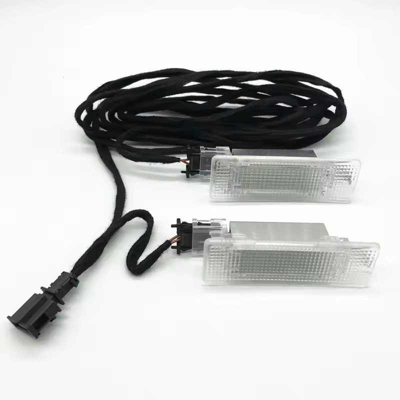

Separately, can someone point to a splitter cable, as in, unplug the rear cargo light, plug the splitter cable into the socket hanging from the wall of the car, plus the light into one of the two splits, and plug whatever else (e.g. an extension to a LED strip mounted on the cargo area cover) into the other split? I think I found such a thing: https://www.ebay.com/itm/205130338596 The seller of that item (which has a 1.5m cable) offered me a 30cm version for about $20 (plus shipping from I don't know where), and I wonder whether I need to pay that much for a splitter cable? thanks,

@skomaz See, now, that's "Clever"! :-) How did you connect the wire from the adhesive LED strip to the existing boot light? Looking at an aftermarket replacement whole-assembly for the rear cargo area lights: .. it looks like it might be possible to get a little harness extension, to plug in between the standard harness and the rear cargo area light, to provide another (female) harness plug into which to connect the wires extending from the LED strip. Are these harnesses standard, and is it easy enough to buy a harness splitter? But then another thing occurs to me - I frequently remove the cargo area cover, because I often carry a bicycle inside the cargo area (I also have a bicycle rack, but there are times when I'd rather have the bicycle locked inside the car's cargo area, instead of locked onto an exposed rack); so, maybe with harnesses (and a big black and yellow zebra warning sticker so I don't just yank wires out of things 🤦) the LED-strip-on-bottom-of-cargo-area-cover would be practical for my particular use case. Else, other ideas ? I suppose I could put up two LED strips, one on each side of the cargo area, along the long horizontal plastic pieces (into which the baby seat release latch is fitted in this photo): Lastly, you indicated that the extra power draw doesn't cause any problems. Do you have a sense of whether that's because the car doesn't particularly monitor that circuit, or because the extra draw is within some (what?) limit? What is the V*A of the LED strip that you added? thanks again!
