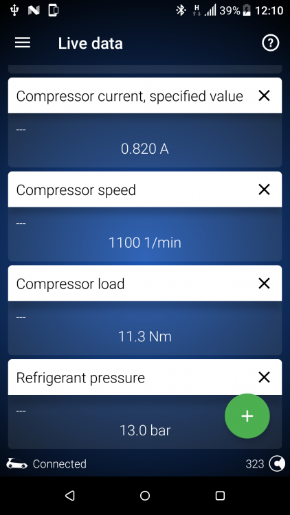

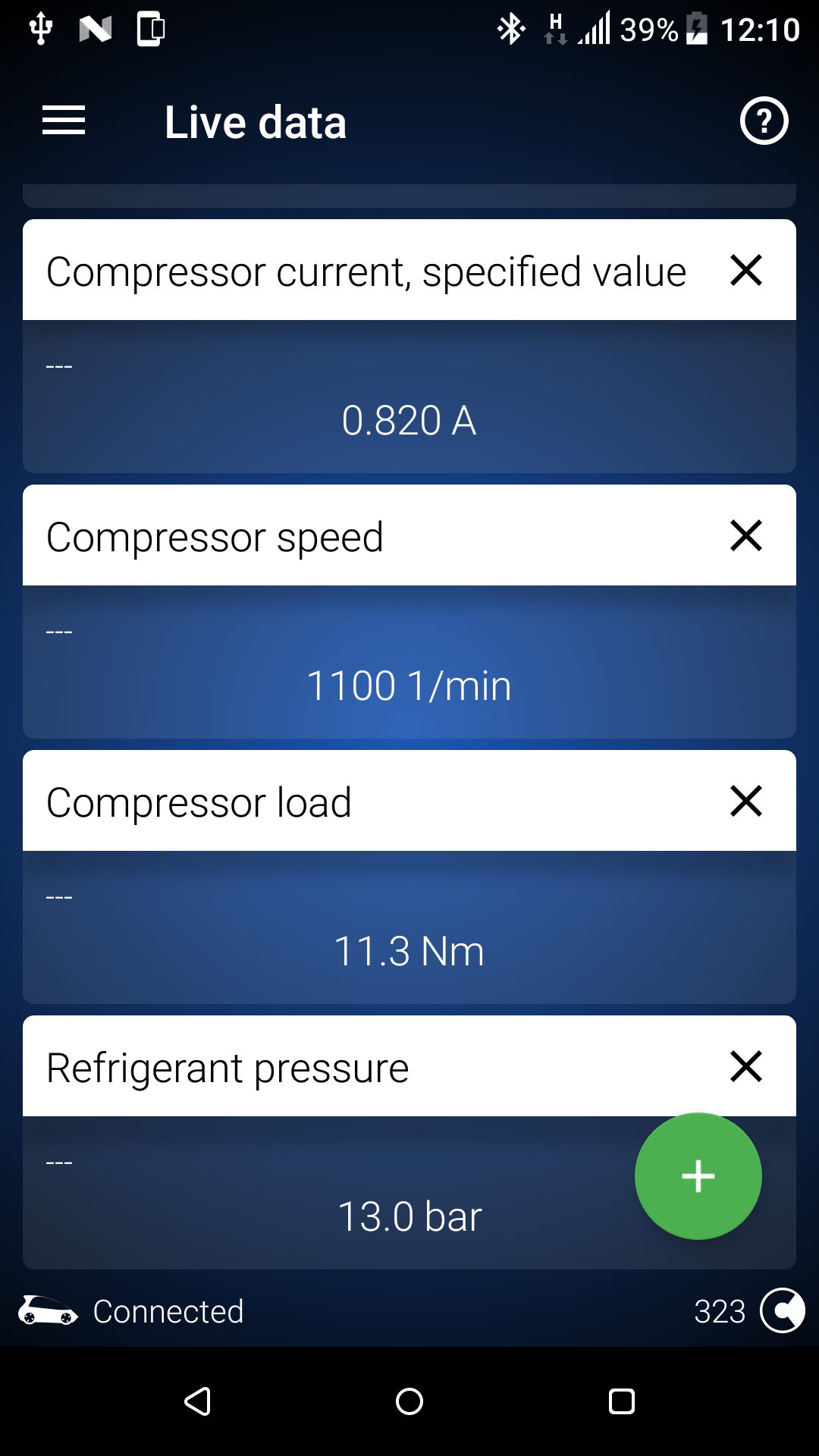

Compressor is OK, as well as refrigerant. Visited VW service today. When I told them what I have already checked they looked at me like I am coming from Mars. Booked time slot in service for next week. I am really curious to see what is going on, but I am also prepared to here some bull**** from guys from service. Will see.

I bought the car year ago. It is 4 and half years old now. I think nobody ever changed it. I have to check if I can read compressor details via OBDEleven and will come back with data. But, it is strange that I have problem only with one zone, and always the same one. I can't see how it can be due to refrigerant. Anyway, will check compressor data.

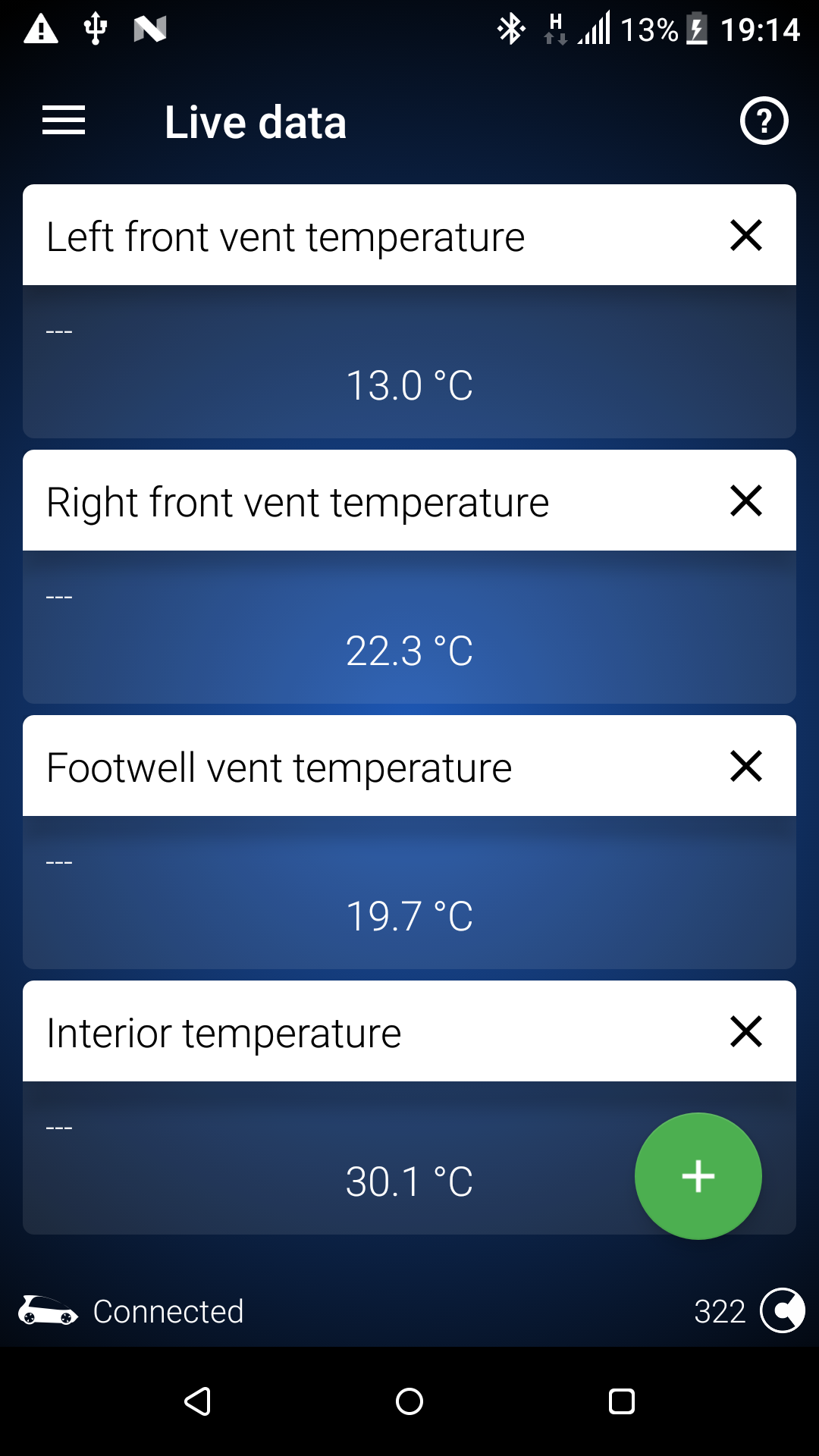

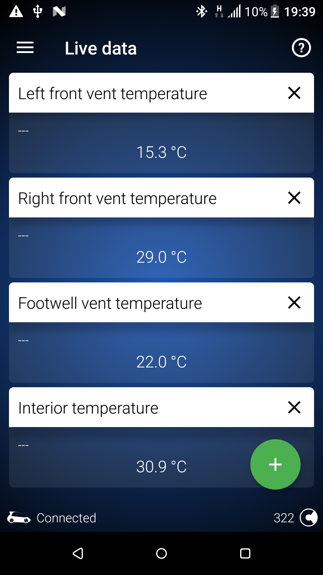

Octavia 3 estate 2016 form signature. AC is automatic, dual zone. When temperature is set, for example, at 22°C, with outside temperature of 34°C and AUTO mode, driver side (left) is cooled as expected, but co-drivers side (right) is getting warmed. AC is set like follows: Temp: 22°C, sync Mode: AUTO Left side is cooled, right side gets hot air. 1. Checked for errors via OBDEleven and found B109515 (Position sensor for right temperature flap motor), intermittent. So I did calibration. Nothing changed. 2. Disassembled right side glove box and glove box frame, found the motor, took it out. During opening I didn't find anything strange, but while opening the potentiometer plastic case I broke it. So, this morning I bought replacement motor (5Q0 907 511 K) from wracked car. Put it in, no codes, but I still get hot air on right side. 3. Did a bit more detailed inspection using OBDEleven. Found out that I am not dreaming, right vent temperature sensor is showing 10-15°C more that the left one. To exclude the problem with those temperature sensors I switched their places (left to right, right to left). Nothing changed. 10-15°C hotter air on the right side. 4. I thought maybe the flap that is mixing air temperature for the right zone is mechanically broken. Disconnected motor, tried to move flap by hand and it moves like it should. Then, to be 100% sure, I got endoscopic camera and pushed it through one of the vents down the pipe and found the flap. While I am moving the lever by hand, flap is tracking my movements. It gores from end to end, without the problem. So, it is not mechanically broken or stuck. https://www.youtube.com/watch?v=iqd4tCBjI-E 5. When I manually slow down the blower speed to 2 dots/bars, temperature difference between 2 zones get lower, but still, right one is blowing at least 5°C warmer air. What could be the problem? Any ideas?
