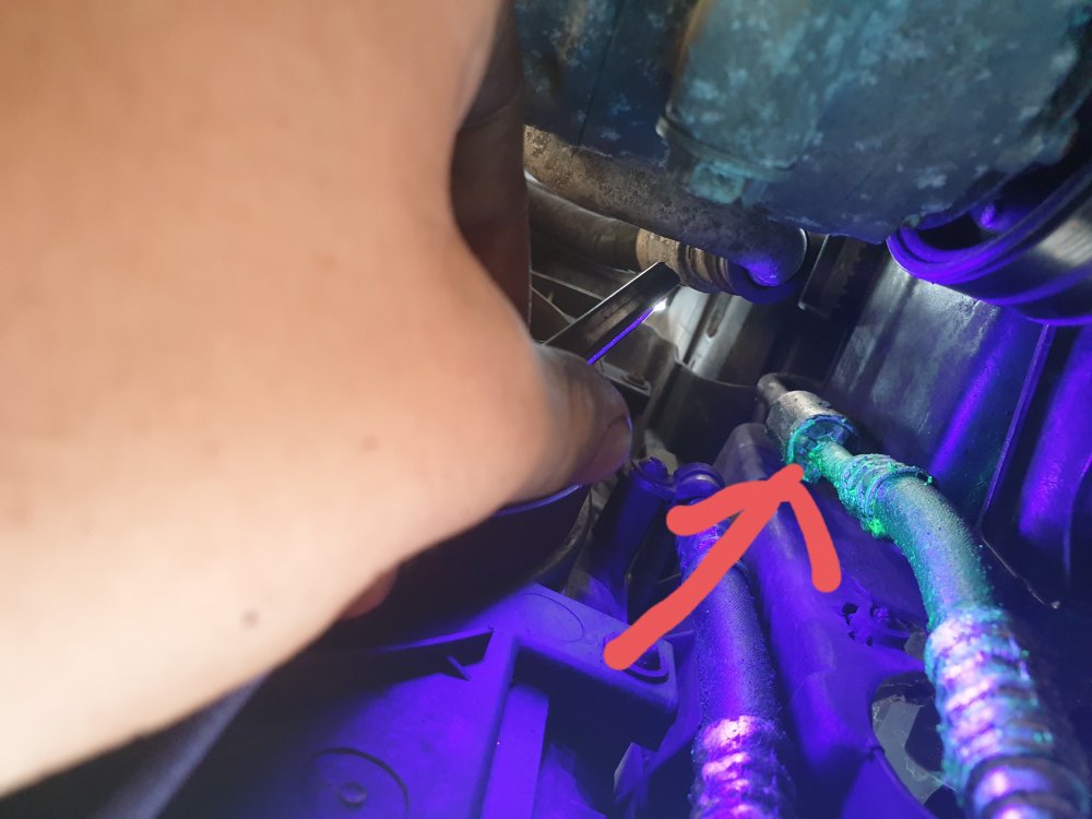

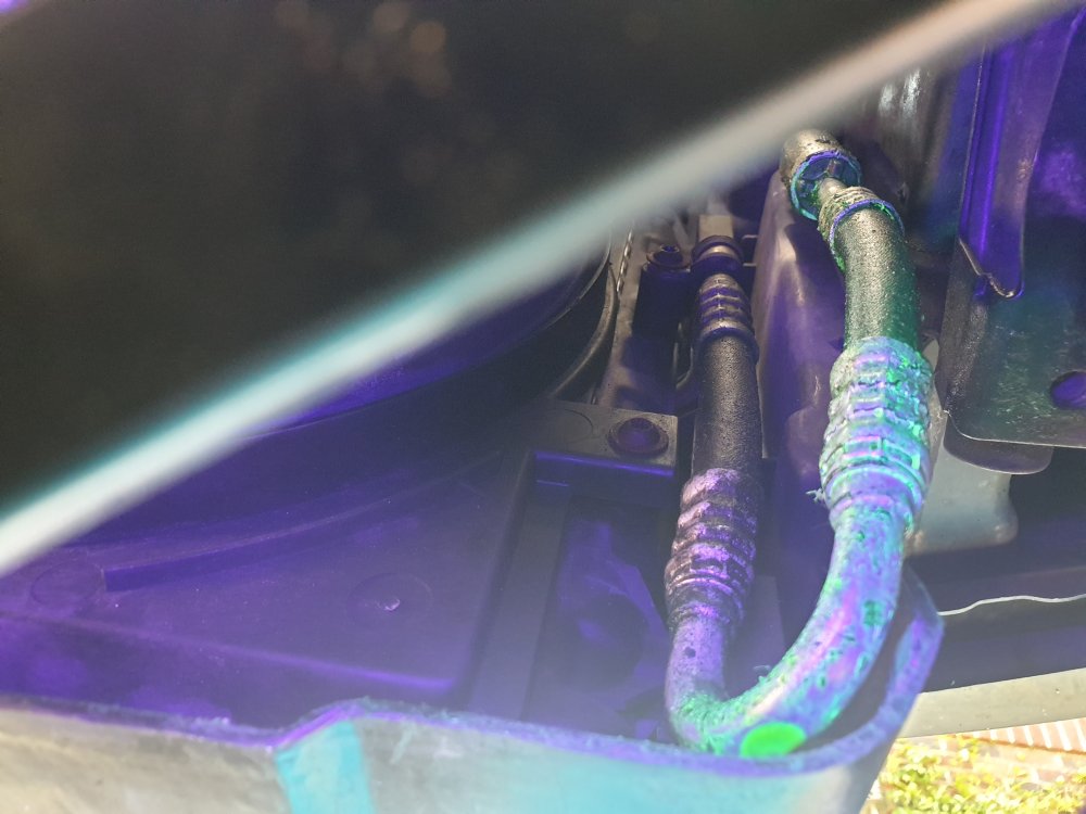

  6. I have visually inspected everything I could. Haven't checked the condenser unit though since it is hidden in the dash. I suspect those are the only two leaks since it does take a while to leak out.
  7. I will try it with a generic AC quick connect release tool since I can't find the VAS one anywhere online. Do you know what size the O ring seal should be? 6Q0298260 seems massively expensive for 1 seal, c clip and plastic insert. I did see somewhere that it wasn't a standard size that would be included in one of the repair kits.

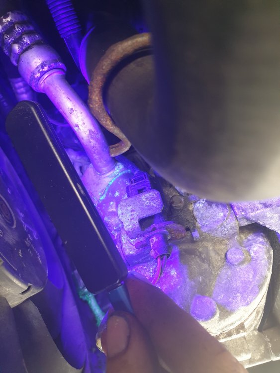

  9. Also looks like this bit is leaking from the point with the arrow.
  10. I suspect as in the picture that my ac is leaking slowly from the low pressure side. How difficult is it to replace that seal? And which part would I need?
