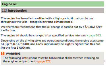

Skoda Octavia VRS 2.0TDI (CUPA EA288) high oil consumption
This screenshots from the manual. I'm guessing that they wont even try to service your car if the consumption falls into that range.
To be honest, after reading countless topics on oil consumption issues in newer VAG vehicles, I'm starting to think that 1L every 2000-3000 miles is "normal" in these cars. If you read the user manual it states that 0.5L / 1000km is considered normal, even more when the car is new. Also, I think this is even more applicable to engines with higher power output.
