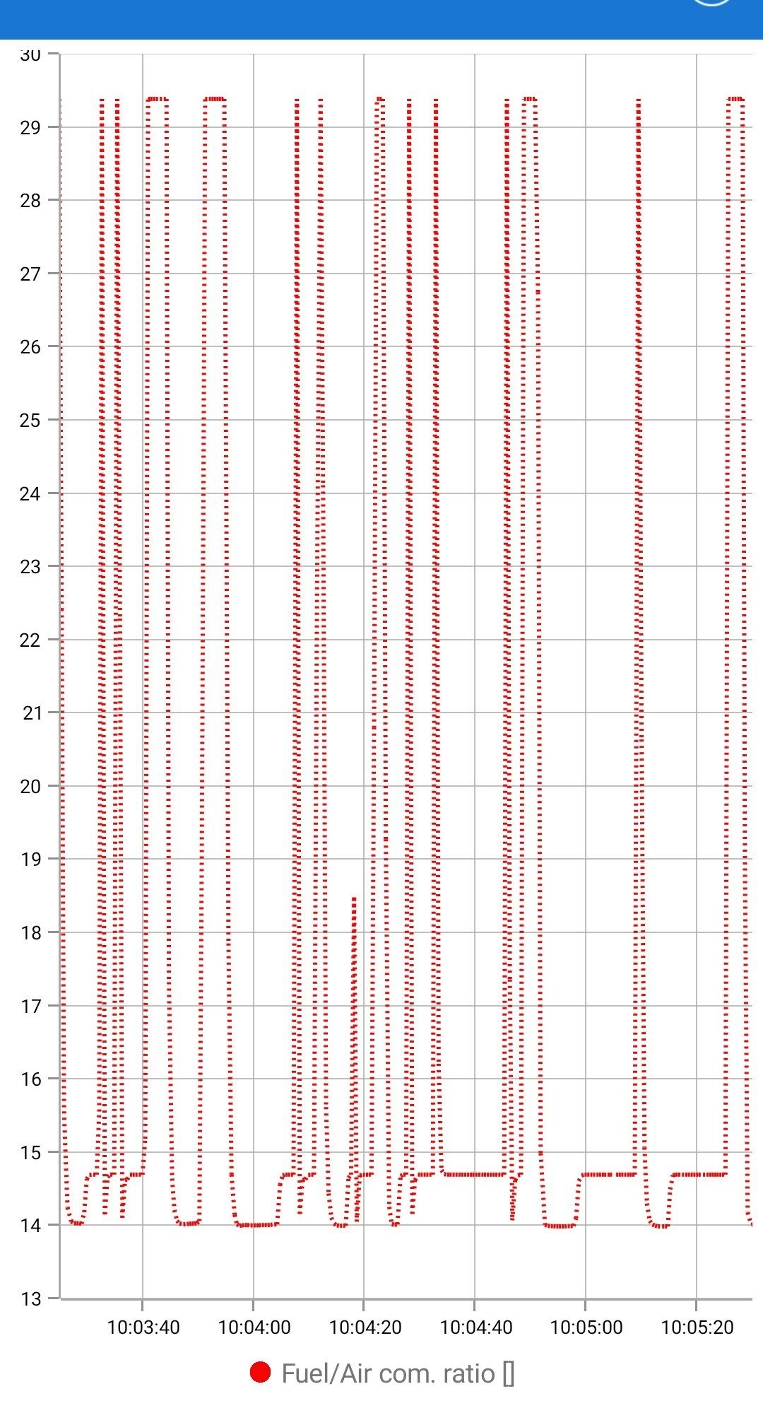

  2. Is it normal ? I mean all the sources I have found, tells the ideal air/fuel ratio is around 14.7. This is true when idling or driving slowly. When accelerating or driving faster it should be lower than that. The higher value means leaner mixture the lower value is richer. Mine is jumping between 14.7 and 29.4. No values in between and no lower than 14.7. Any idea why this could be ? Attached is a screenshot from the Car Scanner app.

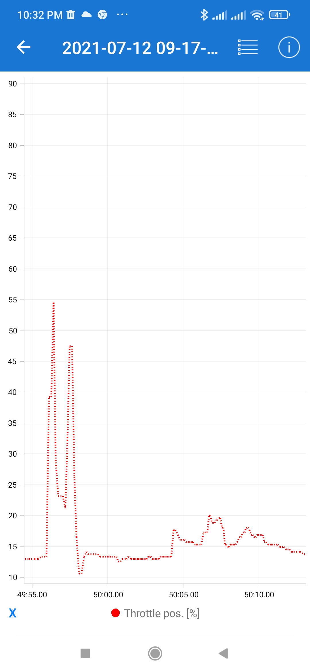

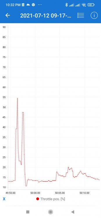

  6. "When driving at slow speeds + lower revs if you floor the throttle how does if feel - any hesitation or feeling of dropping a cylinder. These engines are very plugs/coils sensitive" There is no problem when accelerating from low speed. The sparks were changed two years ago and the car ran only 13000km (8k miles) since then. I can't better describe it as a very short stall or hickup. With the video, just wanted to check how the throttle valve follows the pedal when the engine is off. I have found interesting that the valve flips backwards when I start to press the pedal, but it's maybe normal. I still find it strange , but again I am not a mechanic.
  7. 1) I am limited on CANBUS tools, as I only have an ELM327 compatible OBD2 device, but cannot see any DTCs. 2) I bet the car would takeoff smoother if this "anti-stall" function could be turned off. 3) I have tried this before for a short time, but barely found any major improovement on the throttle response. The ECU or PCM still over react the slight pedal pressing when in 1st gear and about to takeoff. One thing I use as a "workaround" to prevent the stalling apart from the Direct setting in the driving profile. I don't fully release the clutch until the car runs at least 10-15 kmph, but I find a bit weird to control over the anti-stall function.
  8. I own this car for about 6 month for now. Since the beginning I noticed the hesitation in the 1st gear and took the car to two different skoda dealers. Both of them told me that there is nothing wrong with the car, just need some extra throttle when taking off. I have also mentioned the hesitation issue with the 1.5 TSI engine, but they have assured me that it's a completely different story. While agree on this, I still find the throttle behaviour a bit strange. For a slight push on the pedal the engine quickly revs up, but falls back on the clucth release and revs up again, causing the hesitation. Now, I have an OBD tool which wich shows the same behaviour on the throttle position sensor. I have also used a small USB camera to check the throttle valve, by pressing the pedal from the idle position to the max. (ignition on, engine off). On the video at 09 sec the valve flips backwards shortly, despite I was pressing the pedal forward. I beleive that it could be the culprit, but I am not a mechanic. Can somebody shed a light on this ? Maybe a throttle body alignment would help ? Thanks. IPS_2021-07-16.12.39.08.0490.mp4

  11. Maybe it's unrelated to the 1.5 tsi problem, but my Octavia 3 with the smaller 1.2 tsi engine does exactly the same jerking/hesitating in the 1st and 2nd gear as you described. I have the car for six month now and taken it it to the Skoda service few month ago. I was told there, that it's due to the way I handling the clutch. It's always easy to blame the driver, but I knew this from past experience. Now, I have taken it a bit further, so got myself an OBD2 reader to read the fault codes, but found nothing. No misfires or anything else. I have found the throttle behaviour a bit strange, but it's maybe normal. When the throttle is in idling position and the engine is not running the relative throttle position is at around 16%. When just slightly pressing the pedal it drops to 10-12%. When the engine is running it's just doing the opposite, so the engine revs up quickly to 1500rpm, then drops suddenly to 600rpm. Sometimes even bellow 600rpm causing the jerking or stalling. I would exclude the carbon buildup as it usually would causes jerking at higher revs and the car has low milage. Now, some of you saying that the ECU software upgrade would cure this issue partially or completely. How can I read the ECU revision and how can I found the latest ECU updates if any ? I guess Skoda won't tell me...
