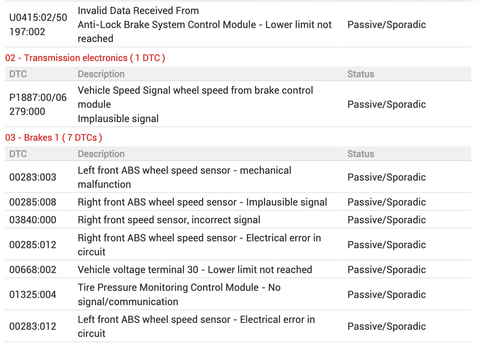

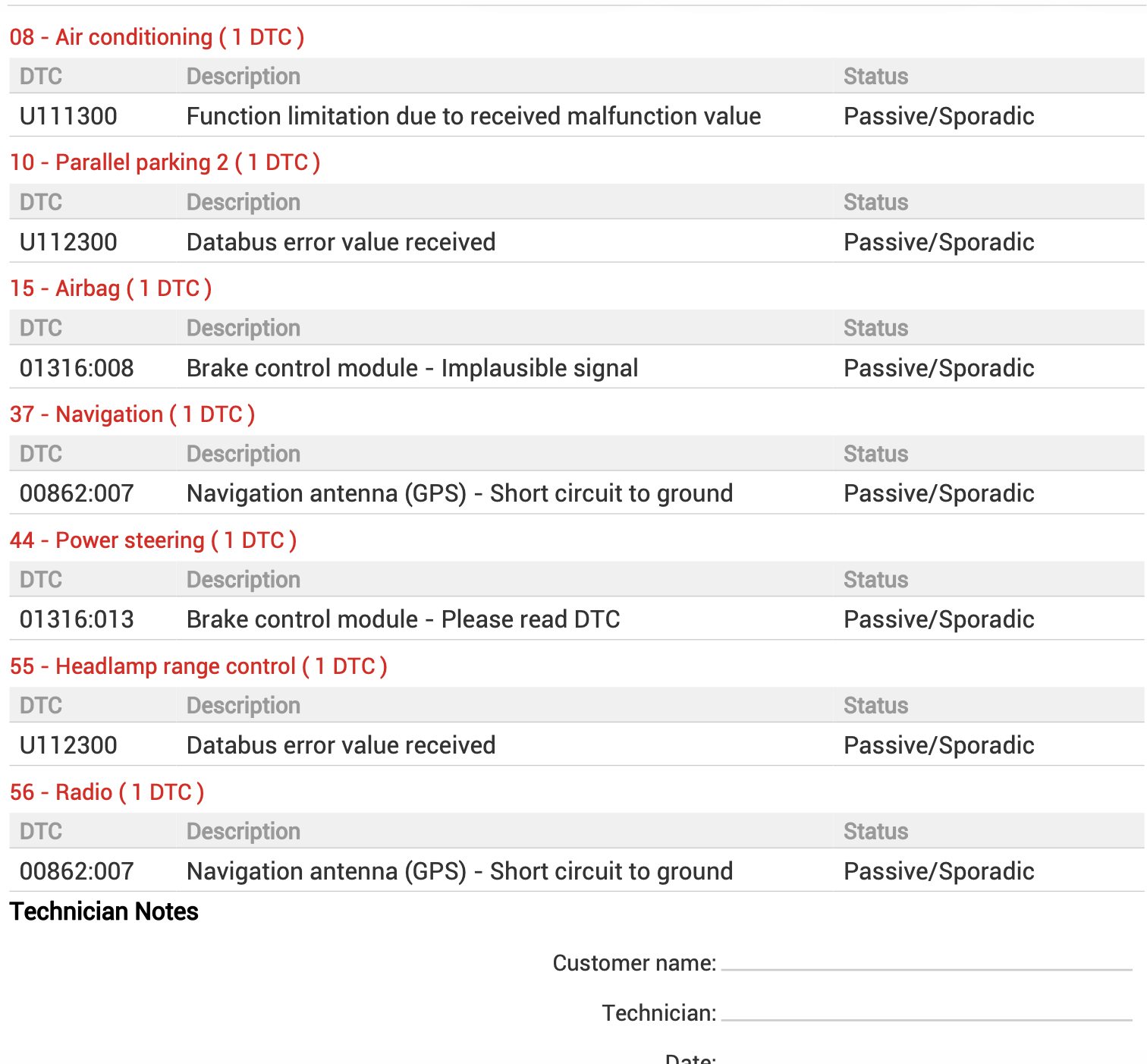

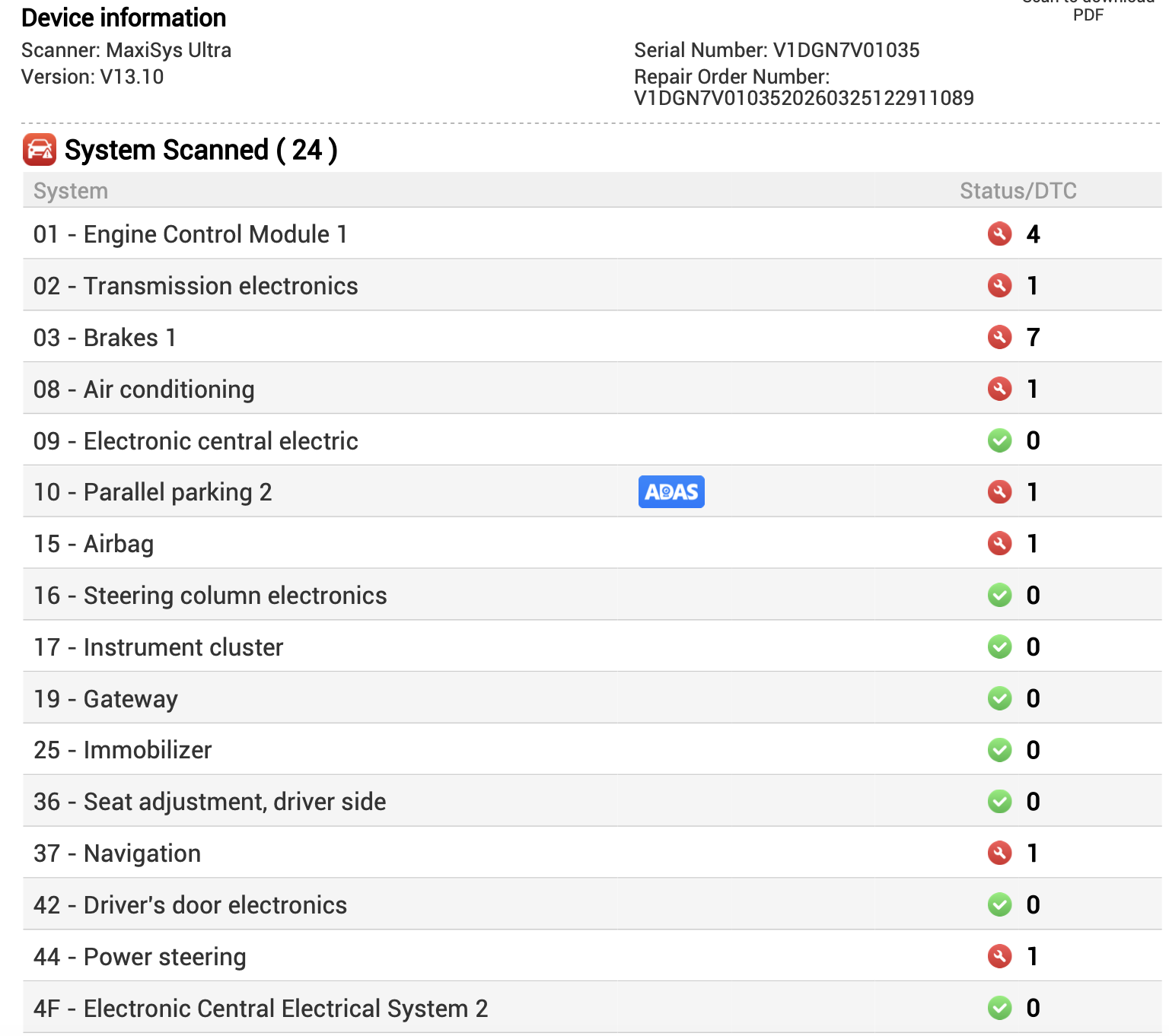

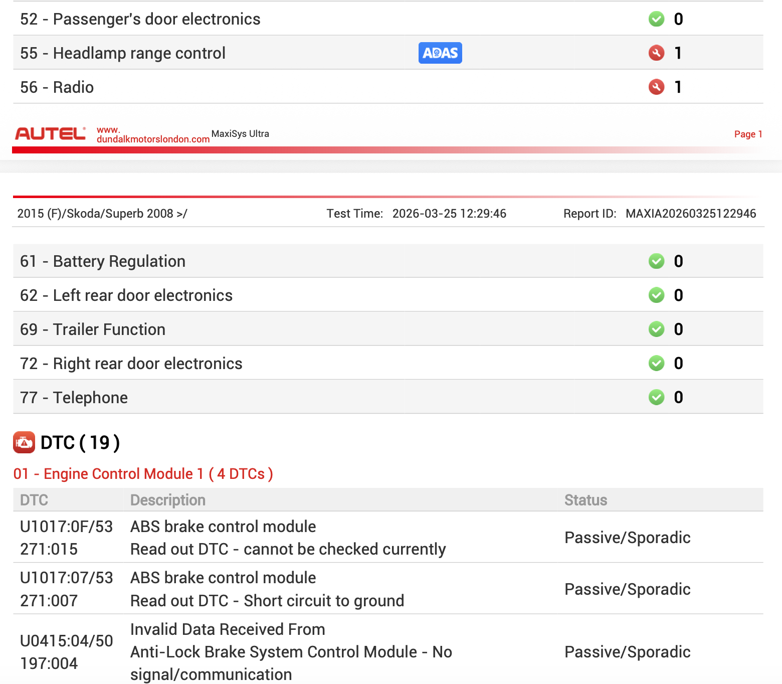

OK - Skoda Vehicle Diagnostic Report screen grabs attached. Obviously I've no idea how to interpret these but hopefully might give you a sense of the boat I'm in. And whether I'm in £1k replacement module territory. Many thanks.

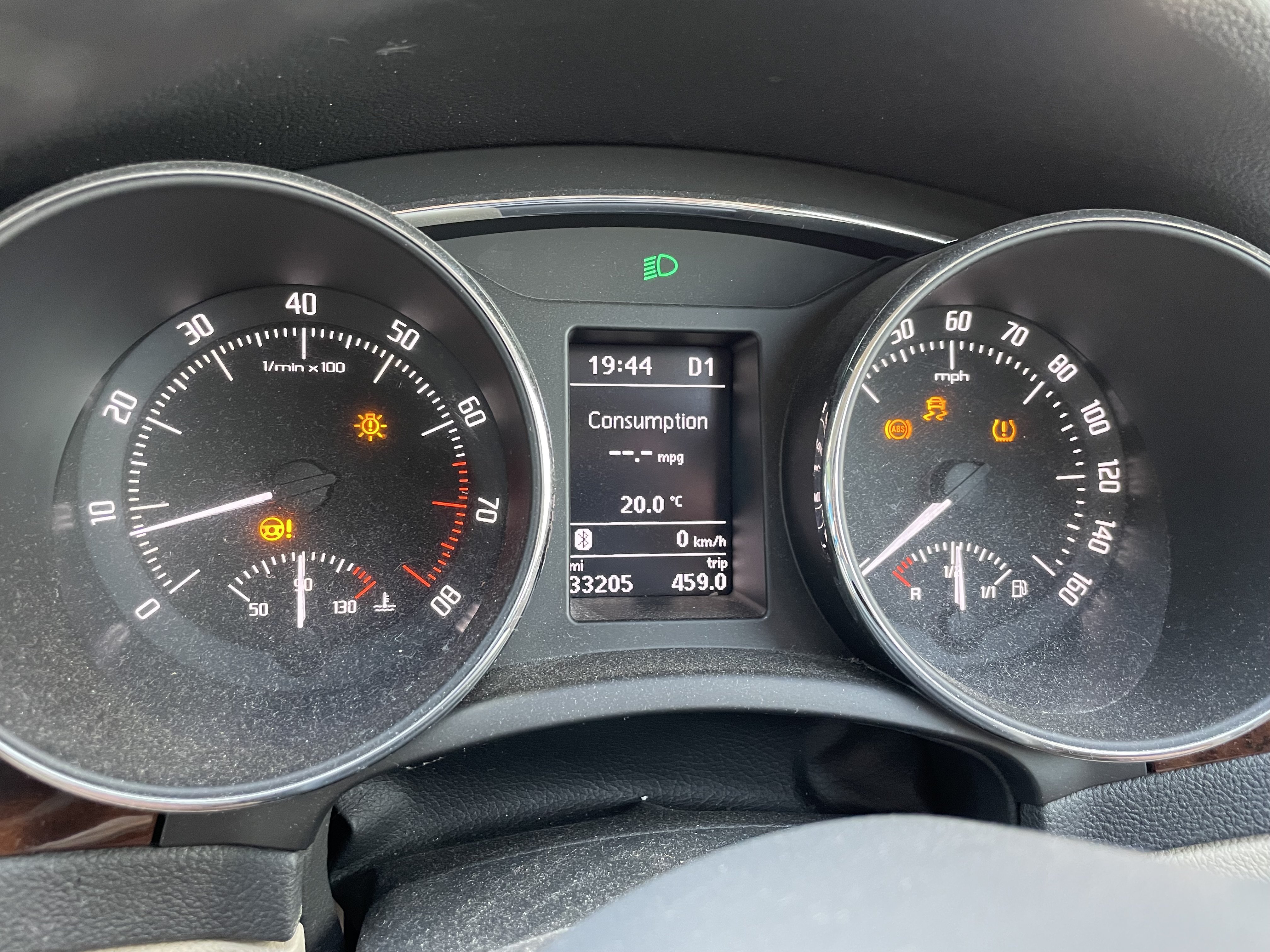

Thanks for the replies. I’ve seen all the error codes listed on garages A4 print out but need to take a photo. The speedometer stopped working today - the needle refusing to register any speed whilst on the motorway and the dash yelled ‘BRAKES!’ At me. The joys

I think they read them - will check tomorrow. But they said when they cleared them, all the fault codes were cleared and remained cleared. Until the warning lights all popped on again. Do the warning lights returning trigger fault codes again?

Only 35k miles on my lovely Superb Elegance TSI 1.8 estate. 2014. Had repeated issues with warning lights coming on dash. A garage can clear but then they come back on again after a couple of days. Current garage has a good diagnostics background and are saying the entire ABS module needs to be sent off - possibly with ABS filter as these can’t be separated (?). Then looking at @£500 for a new ABS module with @£400 labour. And then still can’t guarantee warning lights won’t reappear. They’ve cleared the fault lights multiple times, diagnostics then says no faults, and then fault lights back on again. A my wits end. Any advice? Or go ahead with the work? Just not sure what boat I’m in. Any thoughts much appreciated.
