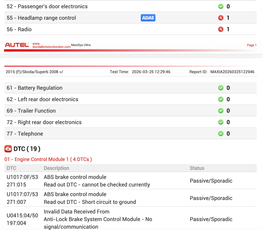

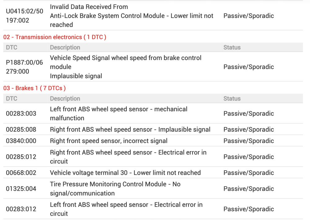

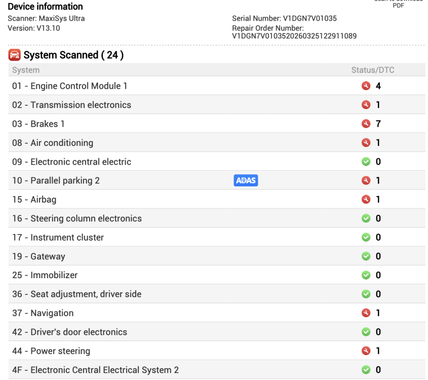

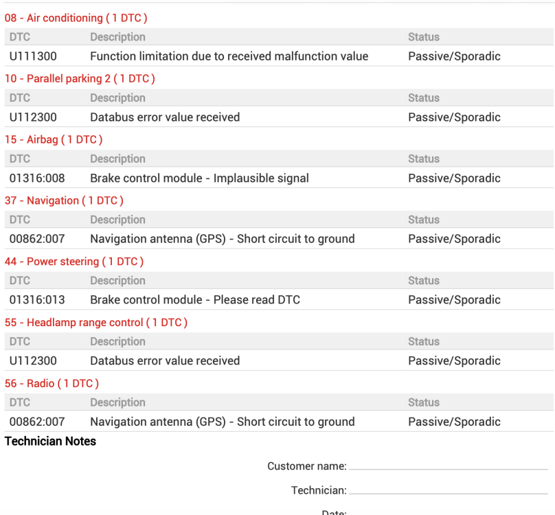

OK - Skoda Vehicle Diagnostic Report screen grabs attached. Obviously I've no idea how to interpret these but hopefully might give you a sense of the boat I'm in. And whether I'm in £1k replacement module territory. Many thanks.

The braking faults 0668 could be caused by a low power connection to ABS or bad earth but you seem to have a fair range of faults mainly electrical What is the condition and age of battery. Might be worth checking voltage with engine off. A low battery can cause all manner of problems. Also check the fuses in engine bay near battery for corrosion or looseness as well as earth points etc.

That's a lot of errors for one system. I'd be checking all fuses, then see if there's any corrosion in the ABS module plug, after that, I'd suspect damage to the wiring loom.

I'd suggest that you have your new battery tested - then have the flagged ABS wheel sensors checked.
I agree with ABS sensors including wiring to them . Theres something not right. It would perhaps explain tire pressure code, power steering and transmision code as well as the ABS errors. I would check all earths especially ABS and ECU and inspect wiring loom and connectors to ABS/ECU etc as well as relevant fuses and check if theres a relay involved.
