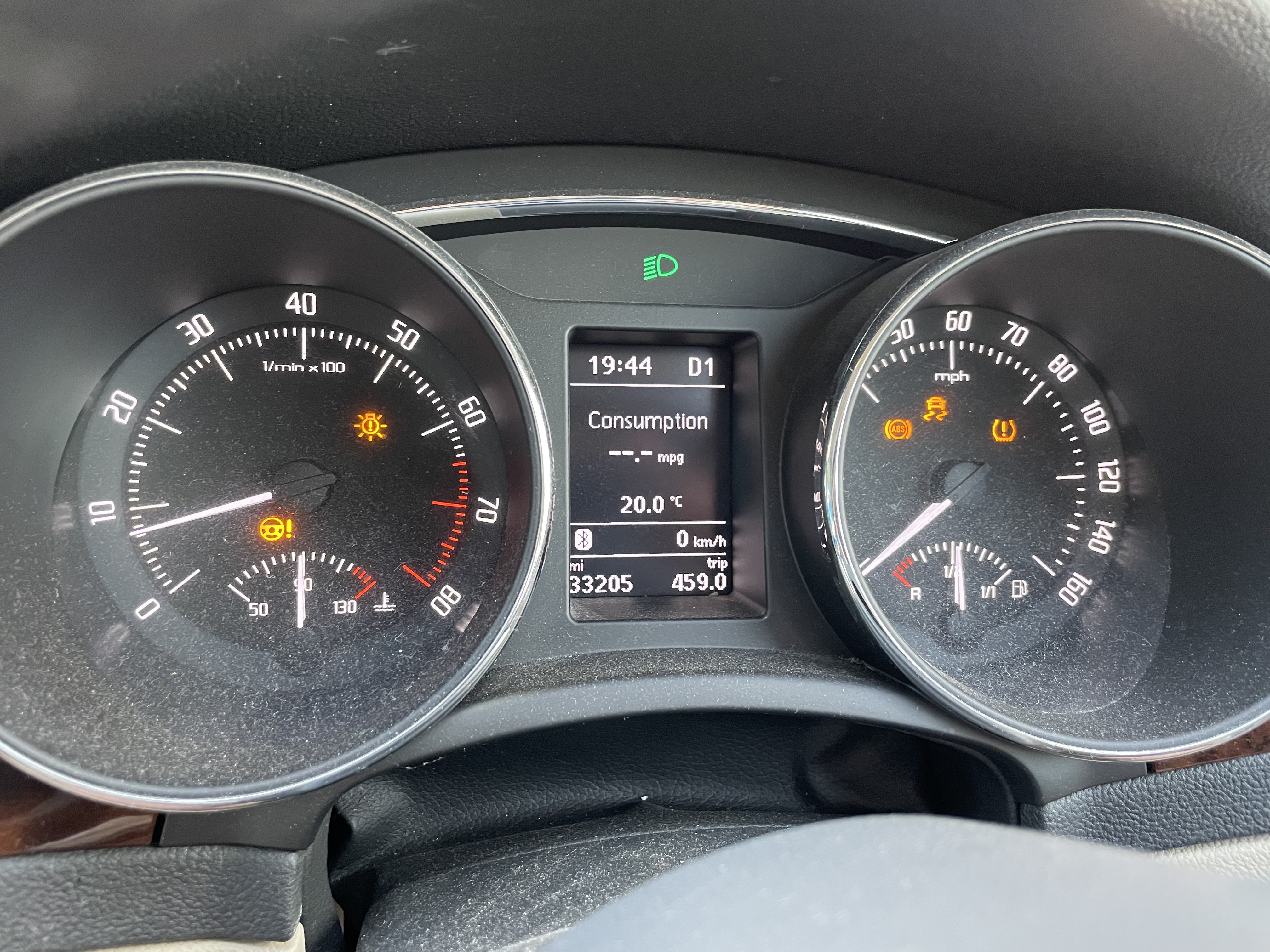

Have enjoyed my 2014 Superb 1.8 petrol estate Elegance for a couple of years but then erroneous warnings and lights started coming on - abs, light tracking, tyre pressure etc. I knew they were erroneous because tyres were def no losing pressure etc.
My wife got nervous and wanted me to have them checked out by the local garage before a long drive. Garage said they 'updated the computer' and 'updated bug fixes' but now these warnings come on MORE frequently. And I paid £300 for this 'service'!!
Wondering what the issue might be - or if more gravity to it then simply getting the garage to up their game? Should I suggest they use or pay for a particular update to their system?

The only way to know for sure, is for a diagnostic scan. A member with VCDS should be able to help you, there is a thread with a members map somewhere, I'll try to find a link.
All of those lights (apart from the bulb warning) are related to ABS sensor, so could be a sensor, wiring, ABS pump etc.
Get it scanned, and it will help you pinpoint what's at fault.
That is the only correct way to go. 👍
I also suspect there is a problem somewhere in the ABS circuit, and most likely also a broken bulb (which bulb it is can be found somewhere in the maxidot menu).

As others have said you will most likely have a problem with an ABS sensor and also a problem with one of the light bulbs which could well still be functioning but have an intermittent contact.
Actually on reflection since replacing a faulty LHR ABS sensor I have not had one single reoccurrence of what were frequent warnings for a rear tail light, coincidence?

It could be an ABS sensor with those lights. A duff battery if it has had a long service light will bring up lots of errors and dash lights too.
As above do a VCDS scan and it will pin point it right to which ABS sensor it is.

My money is on a wheel speed sensor. I've done three in the last week exact same lights (other than the bulb out that is) , two yeti's and a Transporter T6, but only way to be 100% sure is to scan it to see which one. THEN check wiring for open or short to positive/negative or each other. Clean the bearing seal tone ring (if it is that type) or the segmented ring of debris/rust. then change sensor. If you look in word 03 MVB's you can watch the four sensor wheel speeds and compare.
You could scope it if you have Picoscope or similar or just fire the parts cannon. Choice is yours.

I have the same interment issue effecting the Anti-Lock Brake System, Power Steering System, Electronic Stability Programme & Tyre Pressure Monitoring warning lights.
Sometimes its just one or two lights that come on and then sometimes its all of them. Not noticed steering getting stiffer or anything like that, checked type pressures and they are OK. I thought it could be battery related too, as the first time it occurred it was the day after towing my caravan for 2 hours. Had no issues towing it for nearly a year now, but on this occasion my son had noticed the traffic camera was still on a couple of hours after we arrived. With the caravan drawing charge, a number of gadgets also drawing charge, I thought we had run the battery down. However I gave the car a few good runs before towing the caravan home, disconnected everything so the only thing it was charging was the car battery and the fridge. The lights still came on a number of times during the 2 hour journey. The car isn't used a lot at times and can be left standing for a week or so, so thats not going to do the battery any good. Since then the stop start has kicked in a number of times, so I think that is a good indicator the battery is charged, but the lights still come on.
I’ll look into getting a VCDS diagnostic scan.

Try getting the abs sensors checked happened to mine twice
changed the dodgy sensor and a presto
should show up on diagnostic
exactly same warning lights came up
