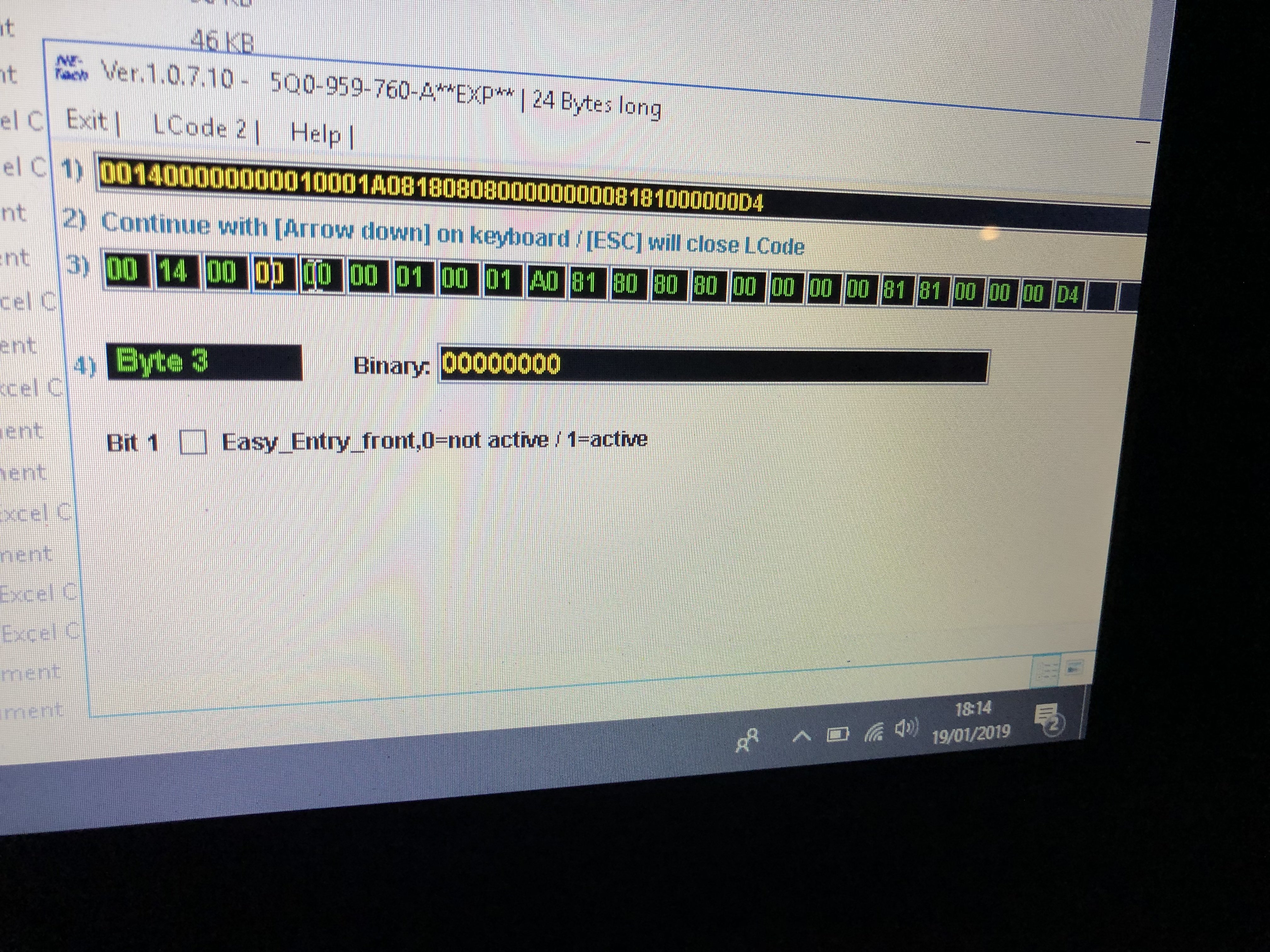

My car is vrs230, electric driver front seat  has memory buttons.
I managed to find via fiddling around with vcds and activate comfort entry /exit.
Drivers seat moves backward for easy exit when key removed from ignition.
Key in ignition - seat moves forward to set position.
Its in in the long coding under drivers seat. 97AEA1D6-77E3-443C-B46A-E83EC36B34B5.thumb.jpeg.c40582ff081d6b166941e025e4be0571.jpeg
Maybe help this might benefit others on the forum.

Hey thanks for the tip! Without wanting to hijack this thread my 2016 (MY2017) 230 has lost its coding for the memory seats (thinks it’s left hand driver and has kessy) and I might try and use your code as a reference point to try and get it back on. Mine does not have Kessy, is yours the same?
thanks!

Interesting - I have KESSY and activated this comfort entry and it always worked when ignition off but often would either not work when car was restarted or would move 80% of the way but enough to not be the correct position so I have now taken it off.
