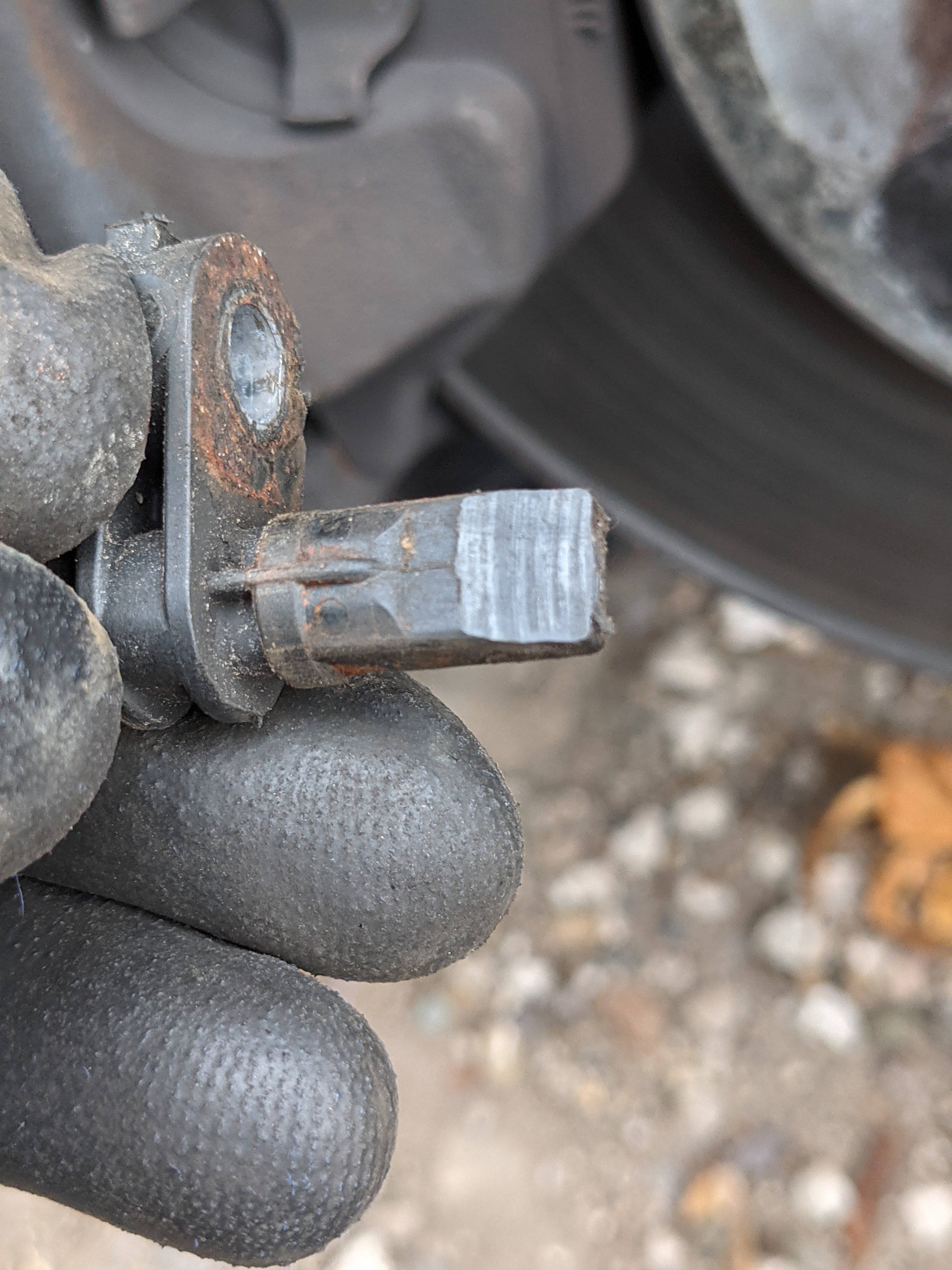

  5. Ahhh thank you. I reckon that's it then. Put a new ring on but I guess it didn't sit right? I had a bit of trouble finding a wheel bearing that fit anyhow. One from euro the splines didn't match up right
  6. Yeah I remember fighting to keep that centred when putting the driveshaft back in.
  7. Ah noo. Fair enough I did the wheel bearing 3 months ago? So that would fit. Did that myself but yeah would rather pay next time
  8. This is the old abs sensor. Looks worn down. Doesn't seem right
  9. @gcaseyI'm really hoping that's not my problem. Put in a brand new battery and no change. I did a wheel bearing in the front left a while ago and it came about after that so just put in a new abs sensor on that side. Plus the old one looked destroyed. No avail. Might need a proper diagnostics check I guess... I've got a obd2 reader but it tells me nothing on the subject. Ahh time to drop the gearbox I guess...

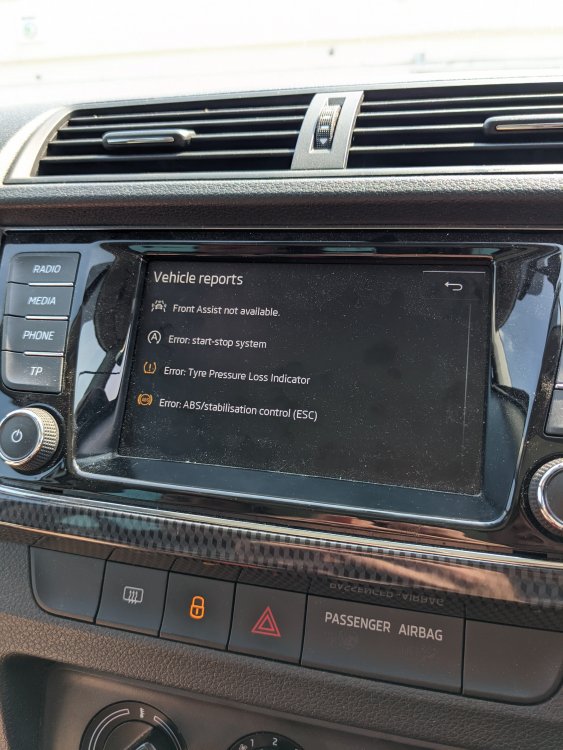

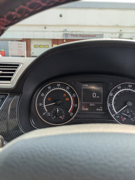

  12. Hello I have a 2016 fabia estate with the 90hp 1.2 tsi. Last night when pulling into a McDonald's I had all of these errors pop up. This was just after leaving the motorway and hitting some A roads coming home from work. I restarted many times and through the drivethrough too no avail. I started driving again about 10 minutes later (engine had been running the entire time) all the lights went off one by one and everything was fine. On a short drive this morning it all happened again whilest moving. And it didn't go away in the 10 mile drive home. Luckily no limp mode but has anyone had this issue before? The ECU felt very hot on the firewall so I thought that was it, but it is not as hot today as yesterday. Any suggestions would be appreciated thankyou
