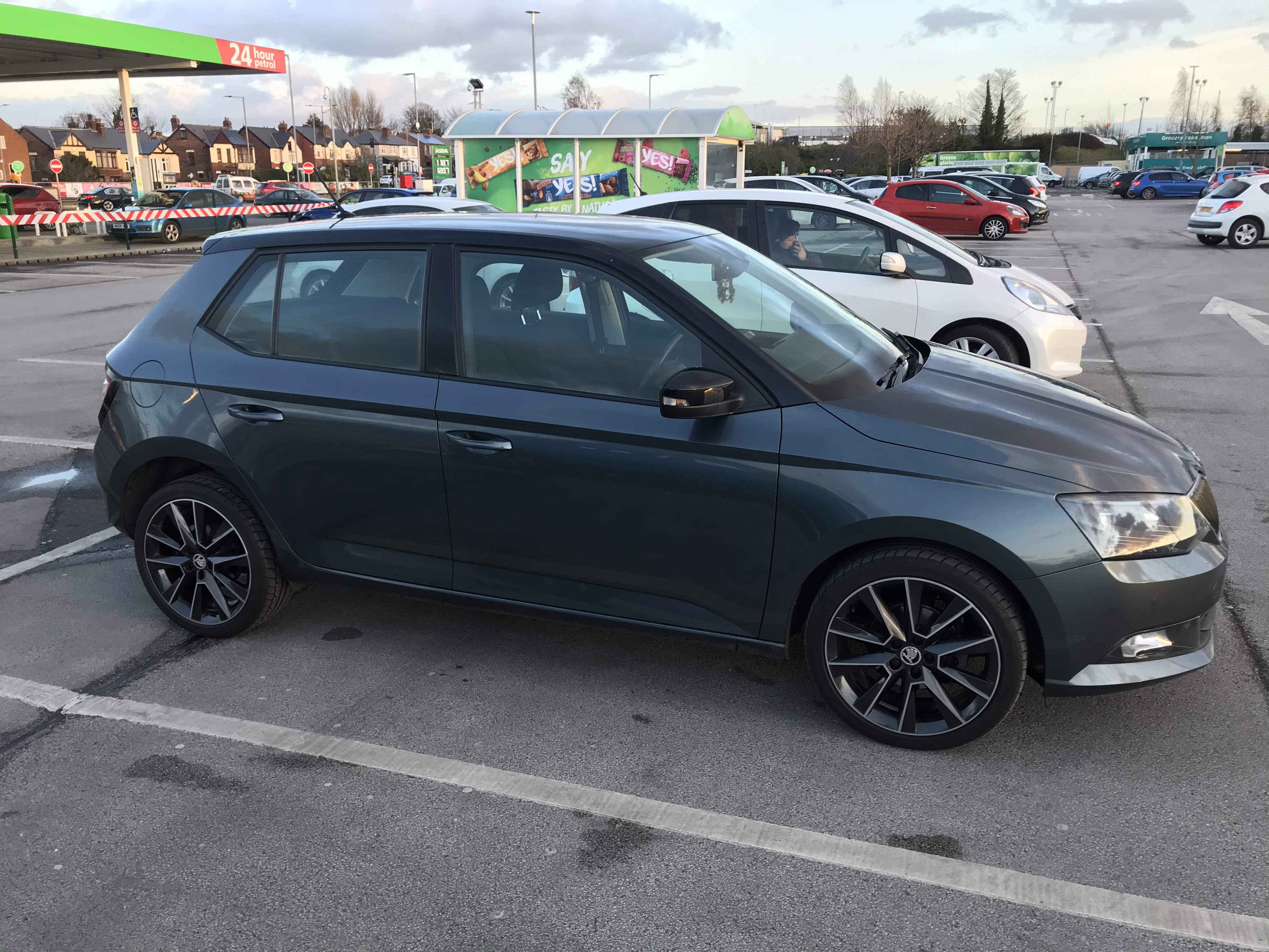

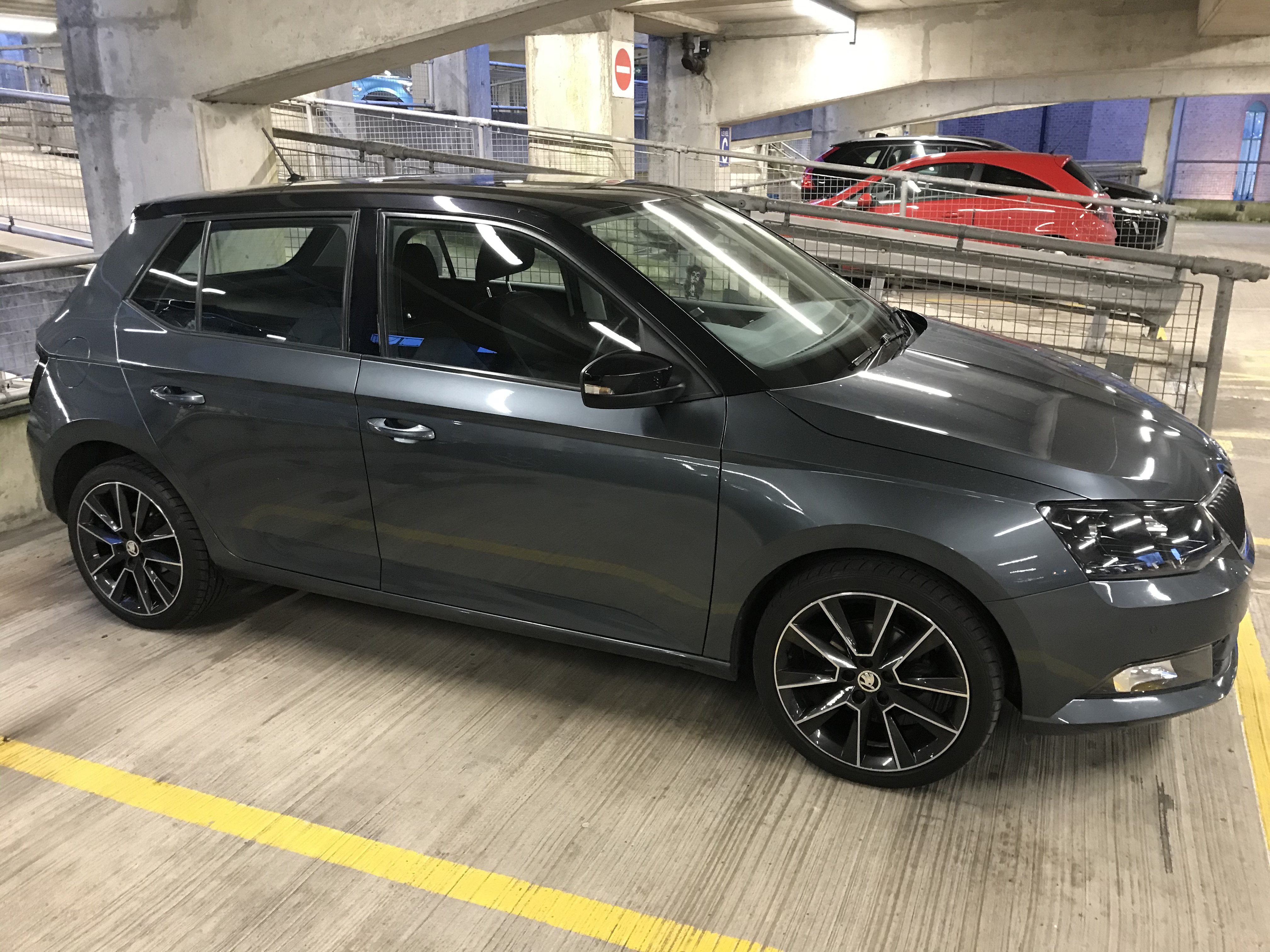

Here she is, bone stock.
Fabia SEL, 1.2 TSI, 90PS, 15 plate (MY16), with Colour Edition, Quartz Grey, 16" Antia wheels.

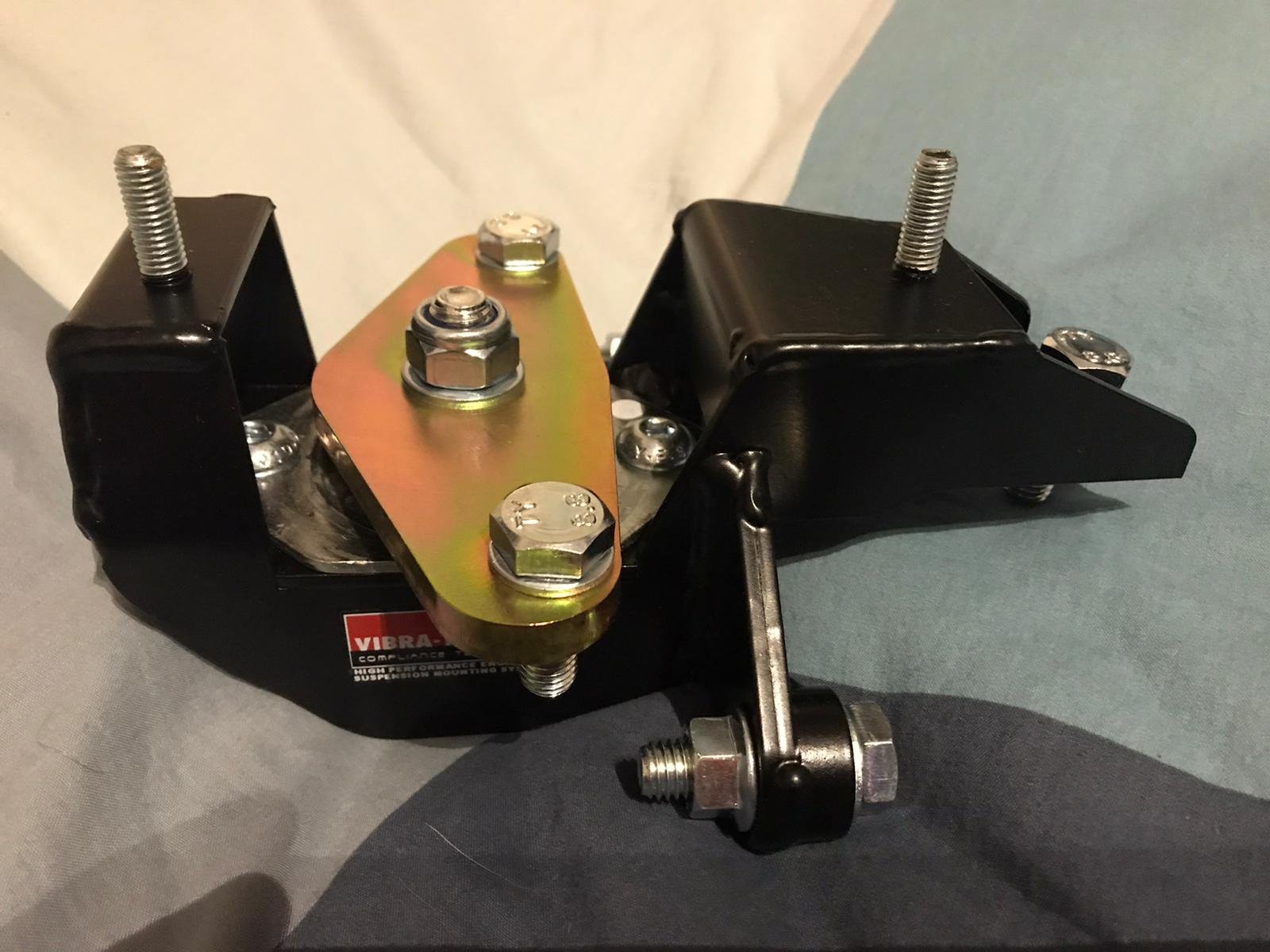

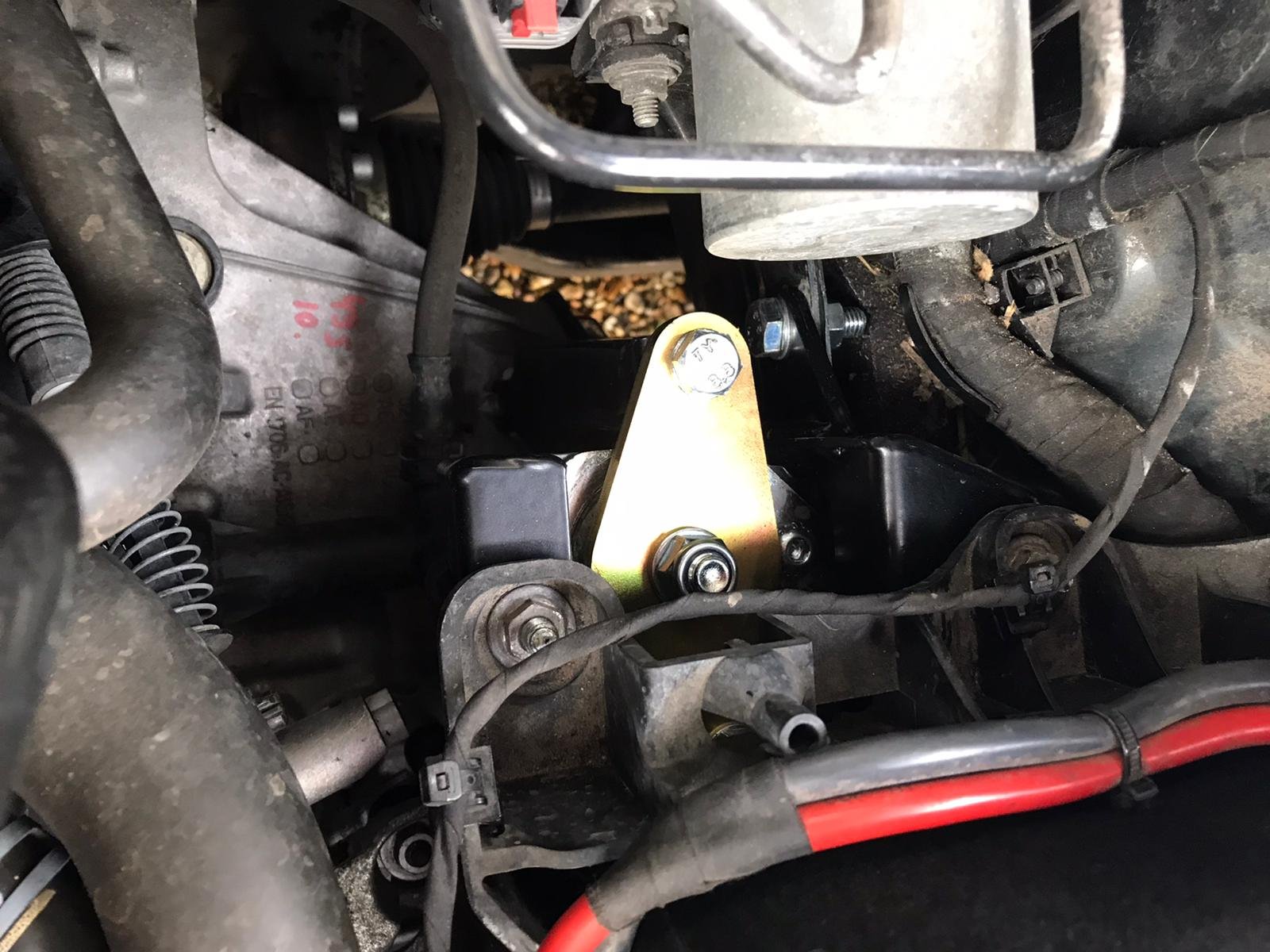

My first upgrade; Vibra Technics Engine Mounts
Hugely improved handling, no more engine slopping about! Car feels way more stable :D
Eliminates wheel hop in the wet, still hops a little in the dry if pushed REALLY hard, but that's probably due to leaking front shocks.

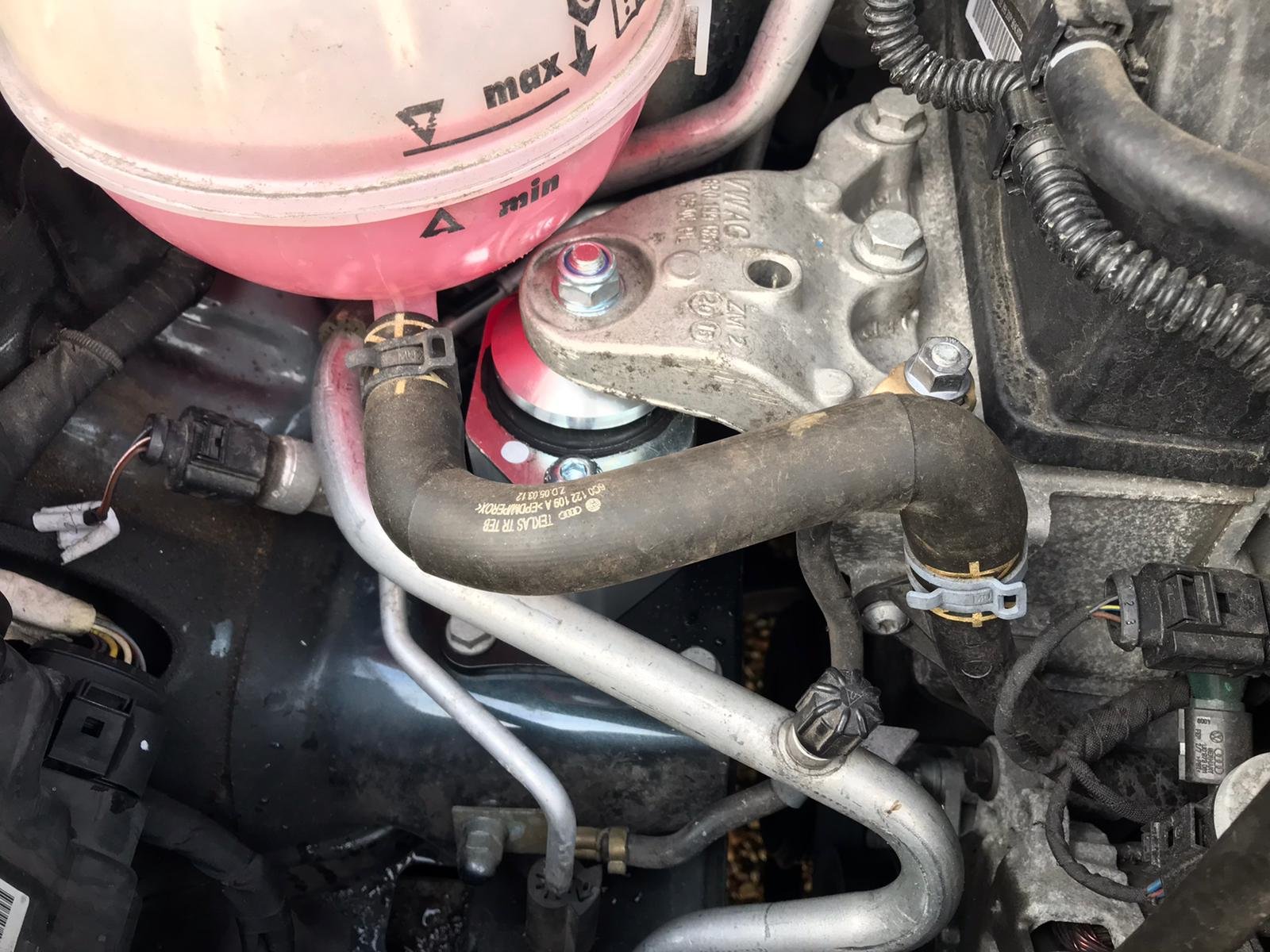

Right Front (goes near coolant reservoir)

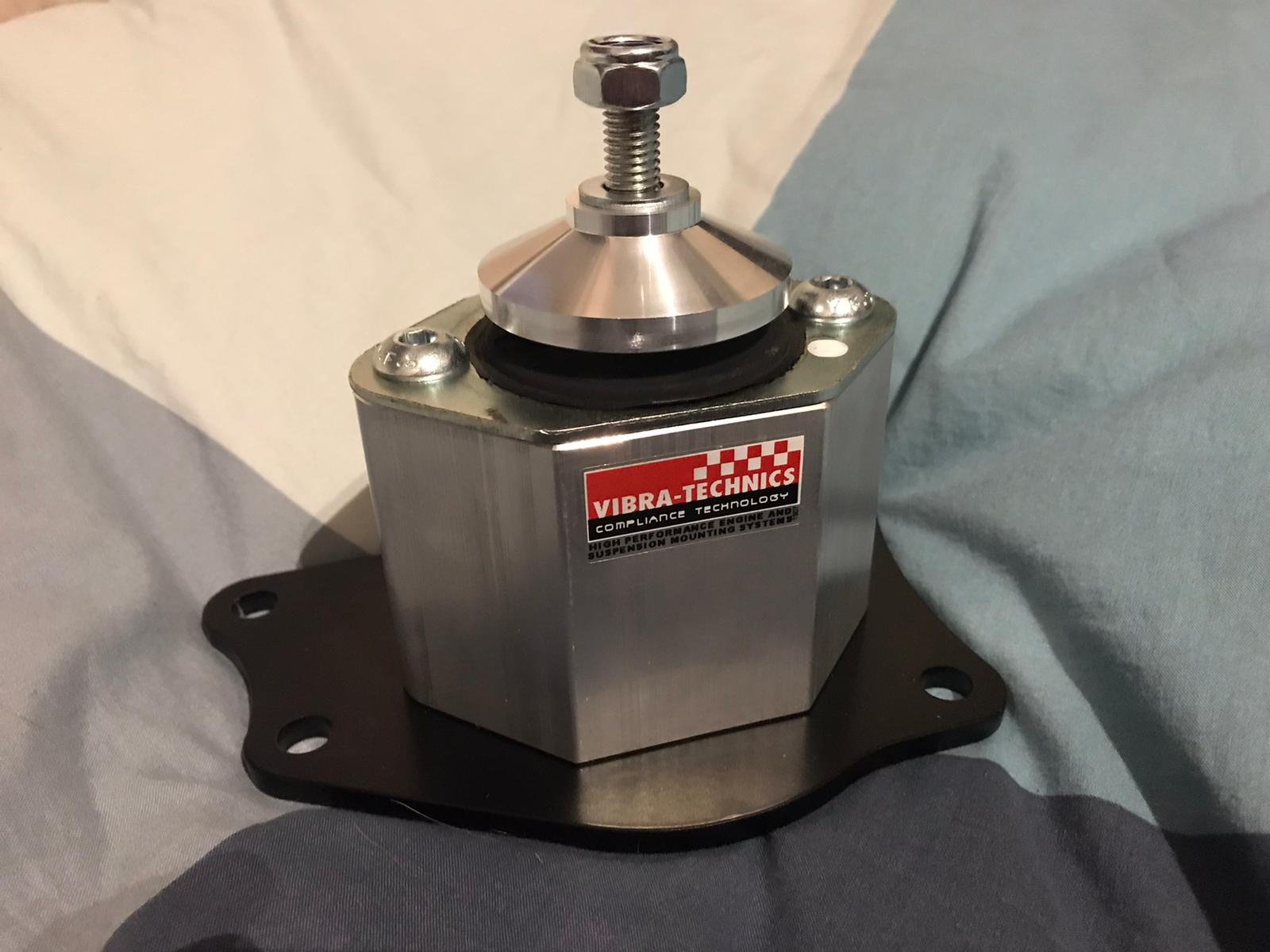

Gearbox mount, replaces the very soft OE mount, and even has studs to re-fit the battery holder!

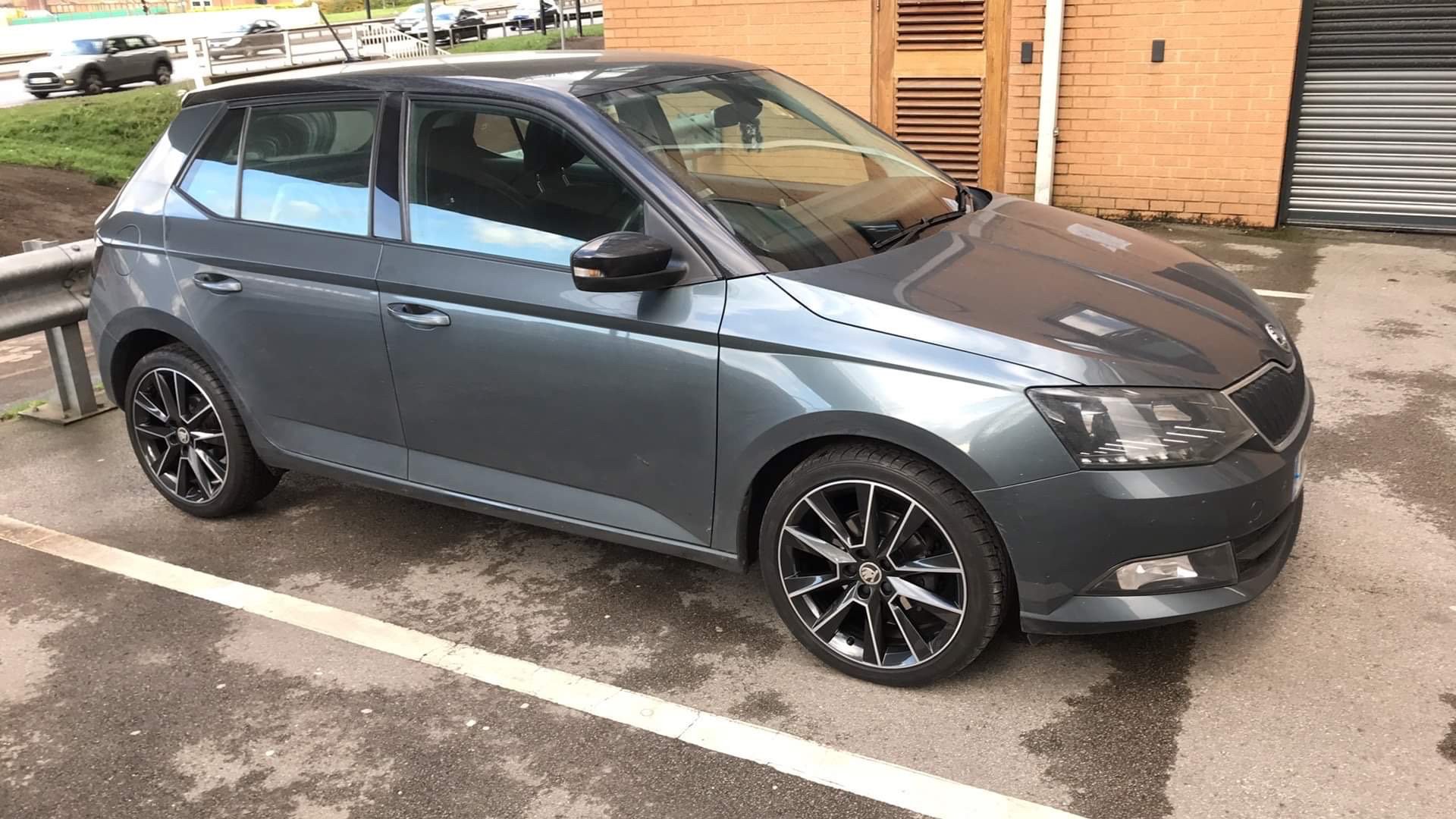

Managed to grab a full set of 17" Savio alloys, originally from a Skoda Rapid. They look pretty damn nice if I can say so myself!
Pre-wash;
Post Wash;

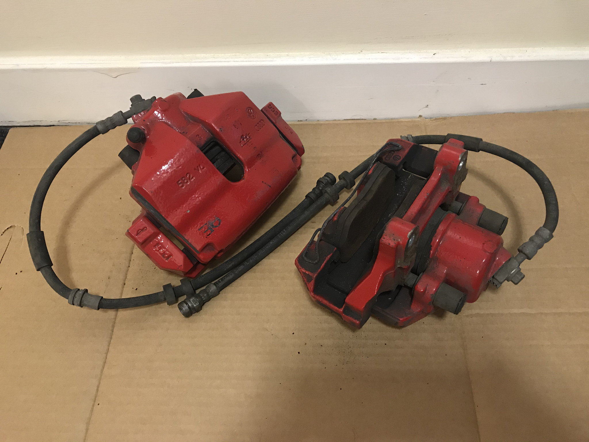

Anyway, here's the "new" brake calipers, they are in need of a really good scrub to get them cleaned up, and those rather nasty looking old pads pulled out of there.
Some tar remover and wheel cleaner should do a good job, from the parts i've given a quick rub with a damp cloth I think they'll come up great.

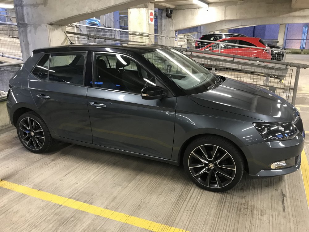

Random question but that car park. It’s not in Sheffield just off the parkway is it? Lol
15 minutes ago, mikey362 said:
Great plans will be watching this one move along 👍🏻
It just so happens that it is!
They all are somewhere along the parkway haha, I went around a few different places after having the wheels fitted yesterday, Tescos for some air in the tyres, Morrisons for car wash and a bit of food, Asda to get some stuff that's only at Asda, and lastly to that car park to get some a final nice picture :D
