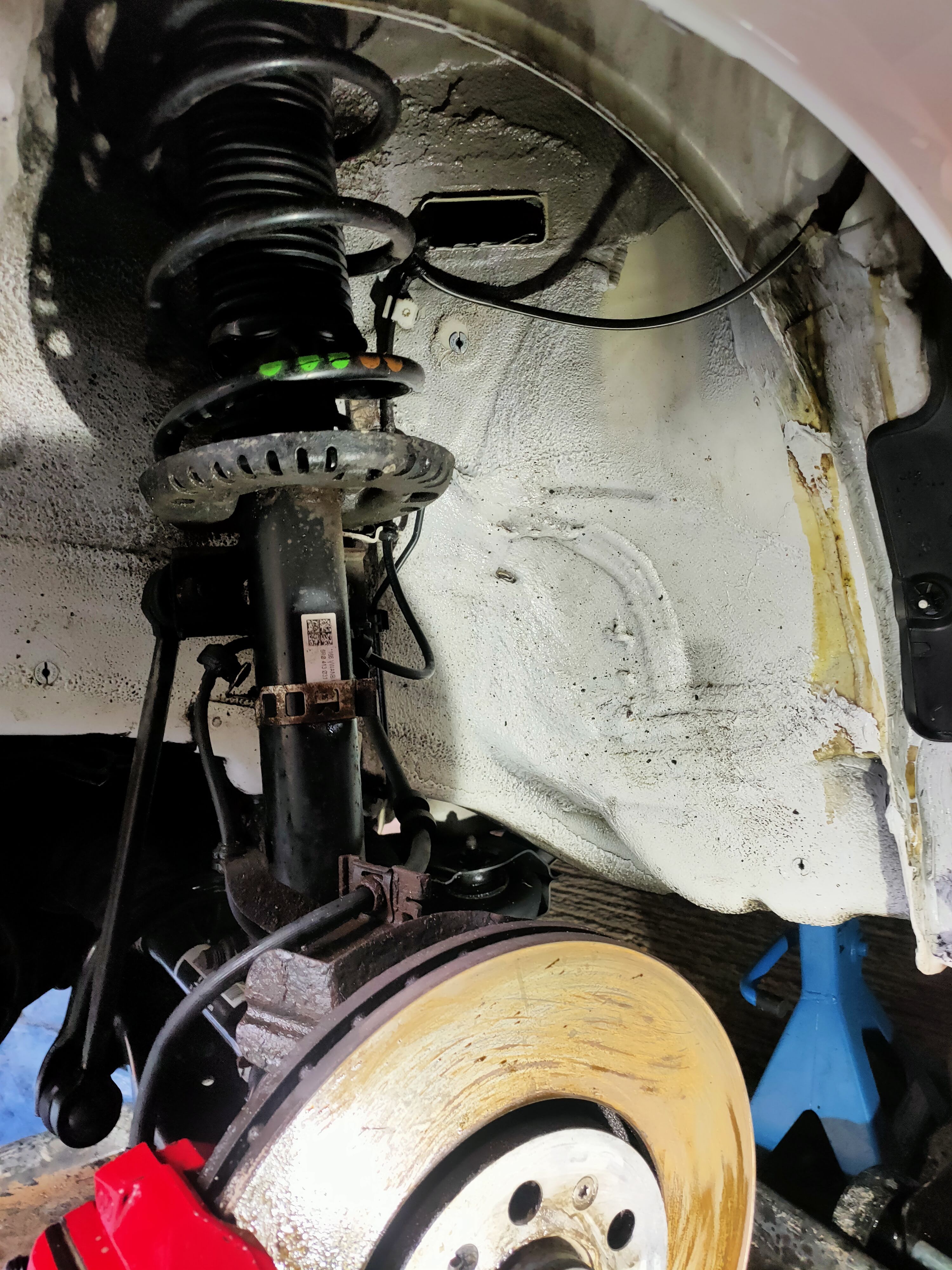

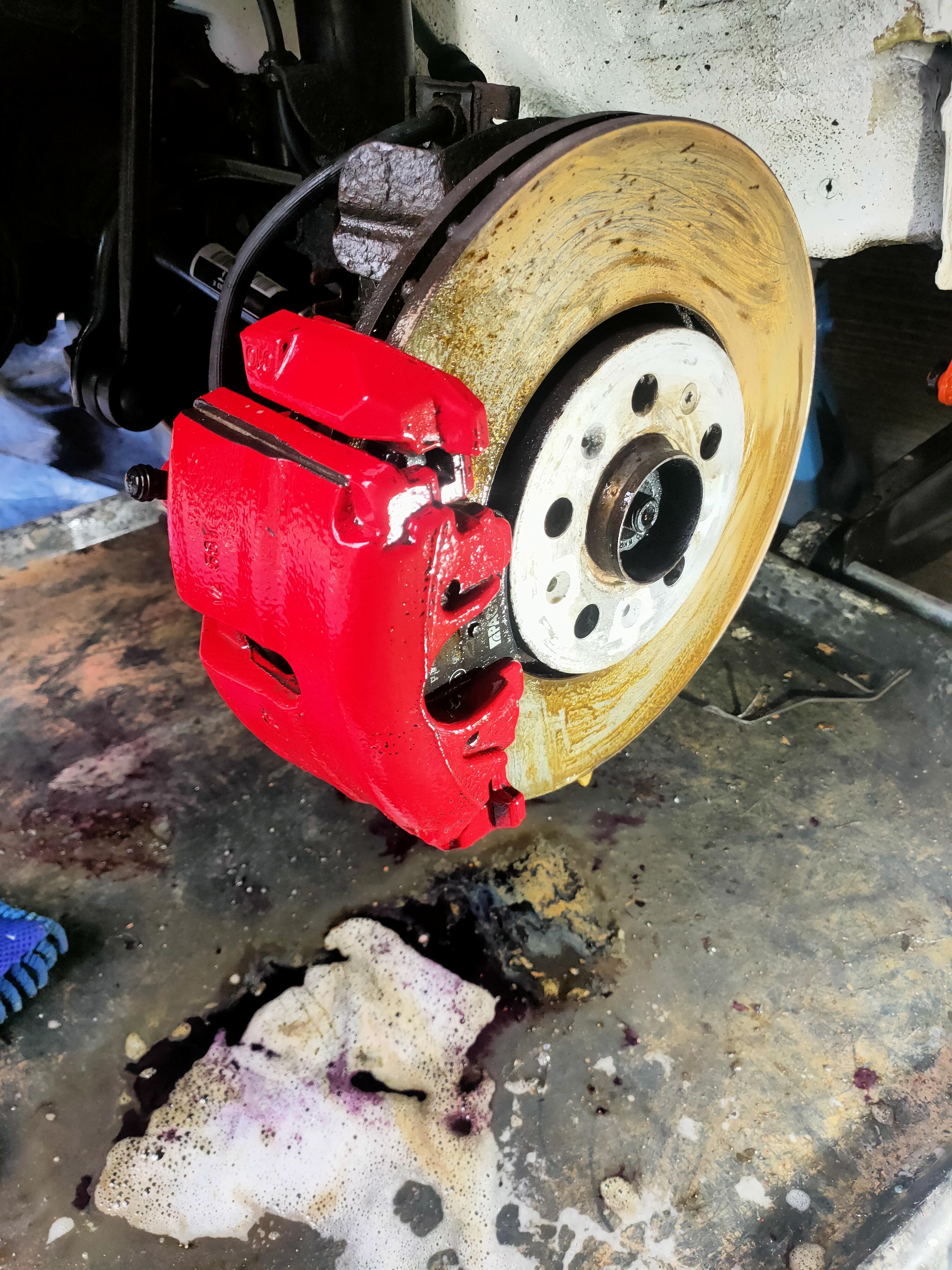

  1. Absolute novice detailer here... I had to take off the wheel to get the arch liner out so I gave the caliper a good clean...it was almost entirely black so probably rarely been cleaned in it's 11 years life. I've managed to get it to a pretty good state using detergent and then iron out and a very fine wire wool and a lot of time but it still not 100%. I used the iron out but I'm not convinced it actually does much more than any other cleaner...can anyone recommend a cleaner that will clean the calipers with like no effort at all Once I get them clean-ish I'm going to try waxing them with Finish Kare 1000p Hi-Temp sealant. While the arch liners are out I've give the arches a bit of a clean and I'm goint to clean the liners which are absolutely caked in bit chunky tar spots and similar.
