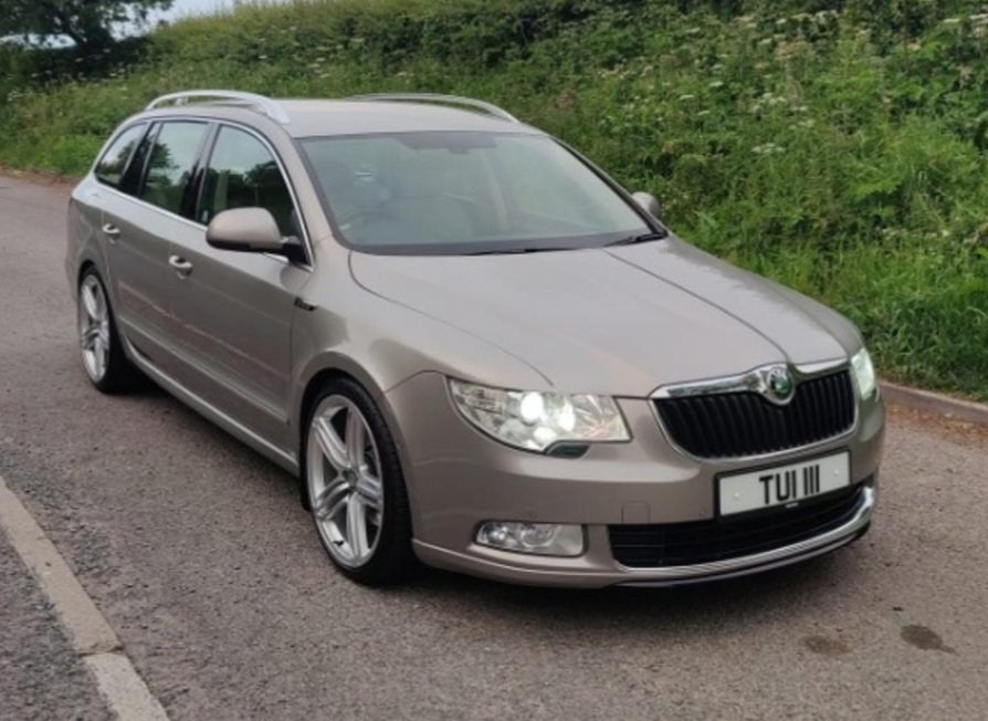

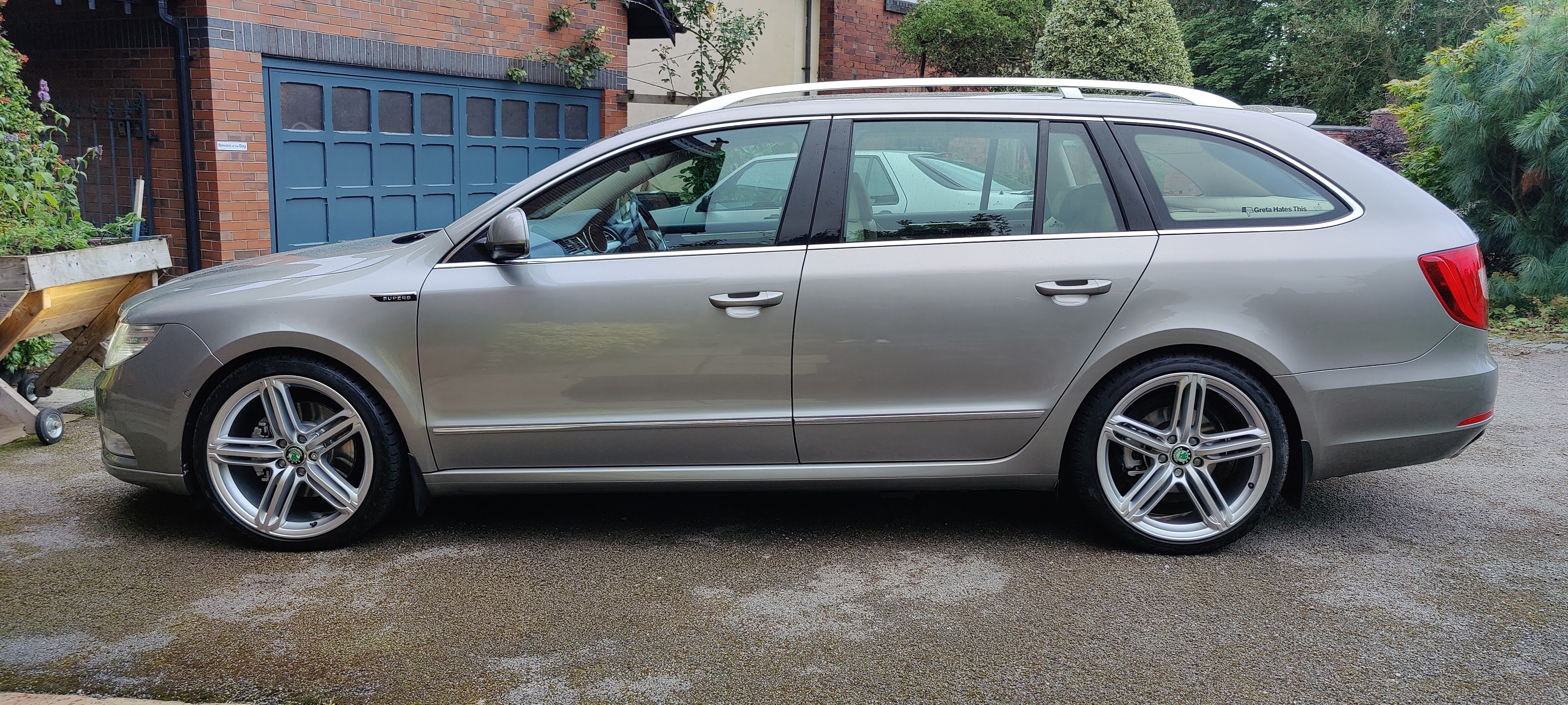

  16. Ok Guys, here is the finished thing - Genuine Audi Alloys, 8.5j x 19" with an ET48. Tyres are Uniroyal Rainsport 5 at 235/35/19 91Y XL, and the car has been lowered 35mm all round using the Bilstein B14 Coilover kit. All fitted by Demon Tweeks, who said that the fronts were very tight, but clear everything and are safe, and the rears had to have 5mm spacers and longer bolts. A 4 wheel alignment finished a 4hr job off. The ride is firmer, with none of the previous wallow, the car is smooth, planted and precise, the ride is no where near as hard as my Golf GTi. I'm delighted. I just need some centre caps!
