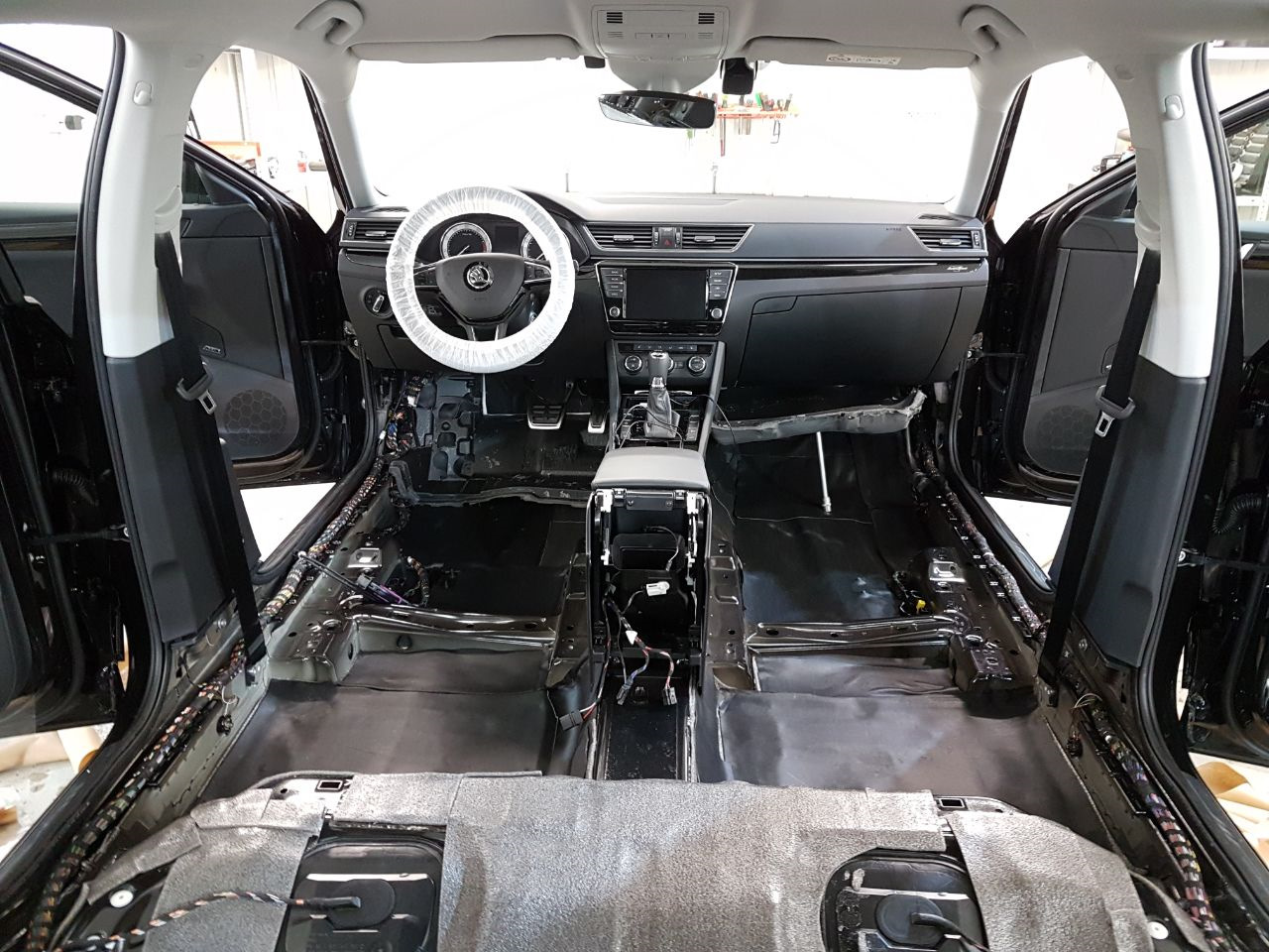

looking at the picture below from the internet our Russian friends were able to take the carpet out without fully disassembling the console. They just took the rear part of the console out. They must have cut these two narrow strip of carpet and underlay that I mentioned and that go over the console.
