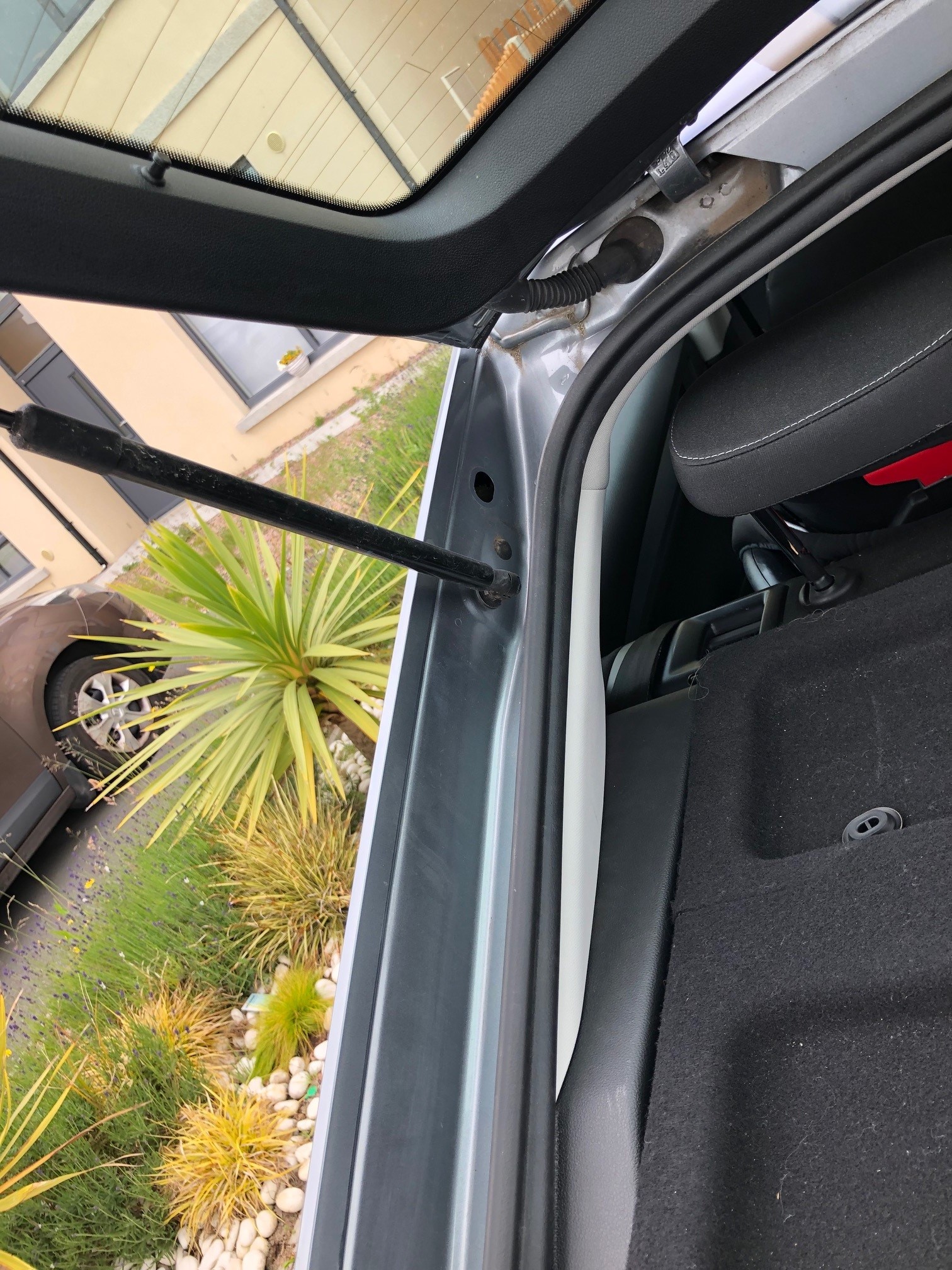

thanks I thought about this option but temporarily sticking butyl on the outside of the car makes no sense but to check if the resonance goes away. Which we know it will. As for the engine I would disagree, it pulls well enough and it's not loud at all. Majority of my remaining resonance comes from the tires and the floor. Now that I have sound deaden the front doors, the B pillar and the boot I can very clearly hear this. I have size 18 wide tires and they are just not a good idea in this car on coarse roads. I will do the floor with butyl and mass loaded vinyl, just waiting for the materials. But I guess those C pillar cavities do cause some noise at the back so why not do something about it.

it will most likely reveal holes for the trip clips only. I did pull it off btw when sound deadening the boot and the spaces on the sides.

haha for those who have never knocked on it from the outside, yes it is very, very resonant. Anyway do you know if there is anything inside or is it safe to spray the expanding foam in there? Just thinking that maybe it's a good idea to take out the trim from there just in case the clips are in the same channel...

would anyone have a clue what is inside the cavity behind this small hole under the tail gate? The hole is covered by a small rubber plug. I am working on sound deadening my car and this is a very resonant panel. Is it a good idea to spray self-expanding foam there to limit the sound and vibrations travelling? Is any water drained through it? I don't see any cables inside but would need to know that for sure.
