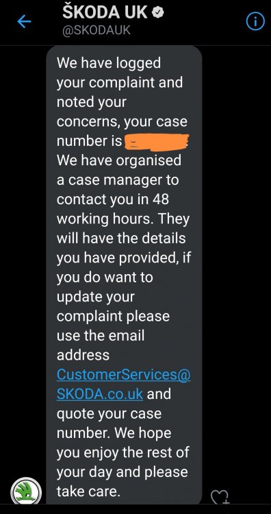

  2. If you look back at all my posts you will see previous stats. My display and processor were changed and all is now good. Don't settle for even one fault they are obliged to fix it. Just keep saying what doesn't work i kept presenting them with a list. And I badgered skoda uk on social media and a top manager rang me and open a dispute. Yes it took 12 months but it was always going to as the problem is across audi vw skoda platforms.

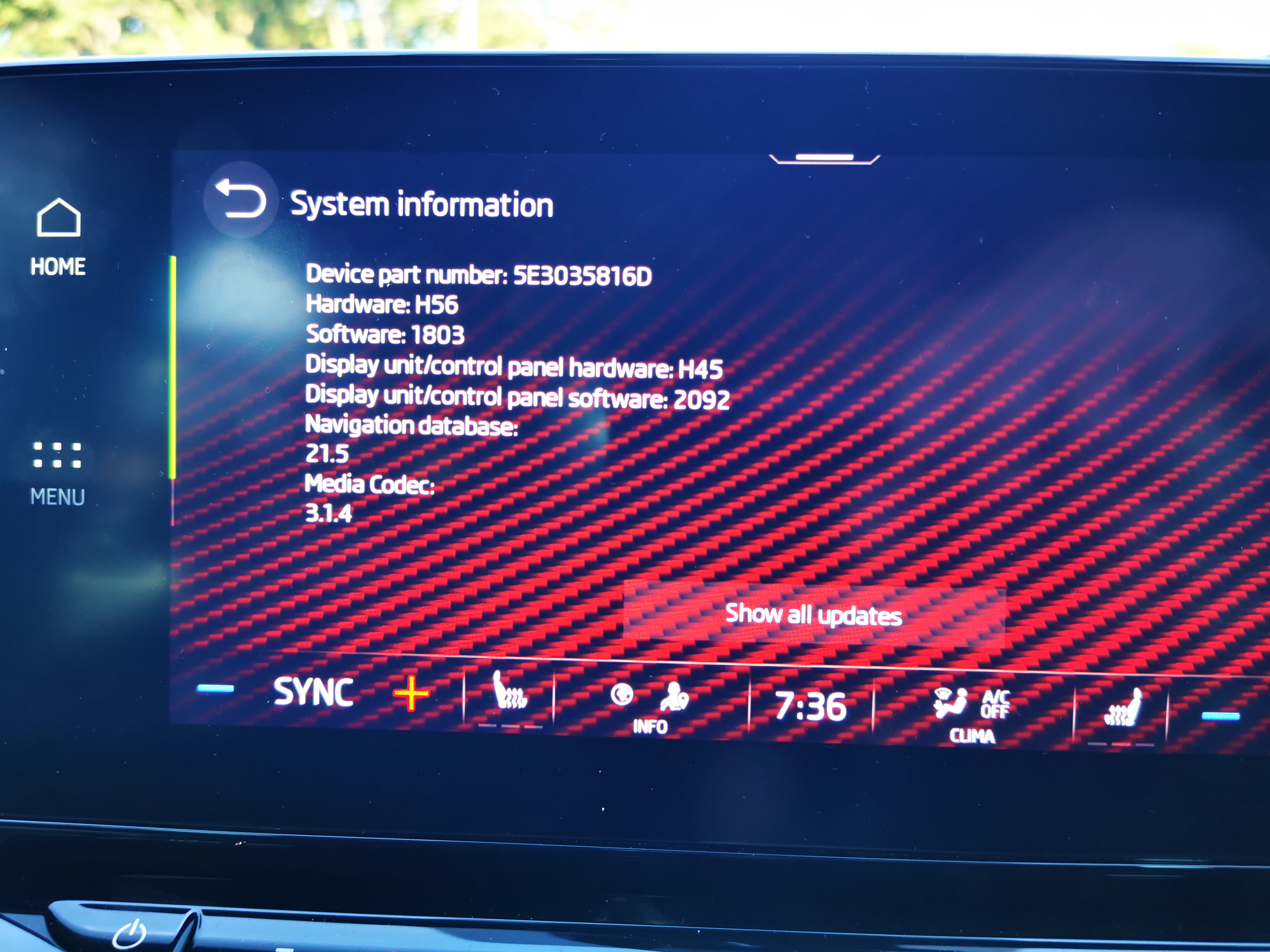

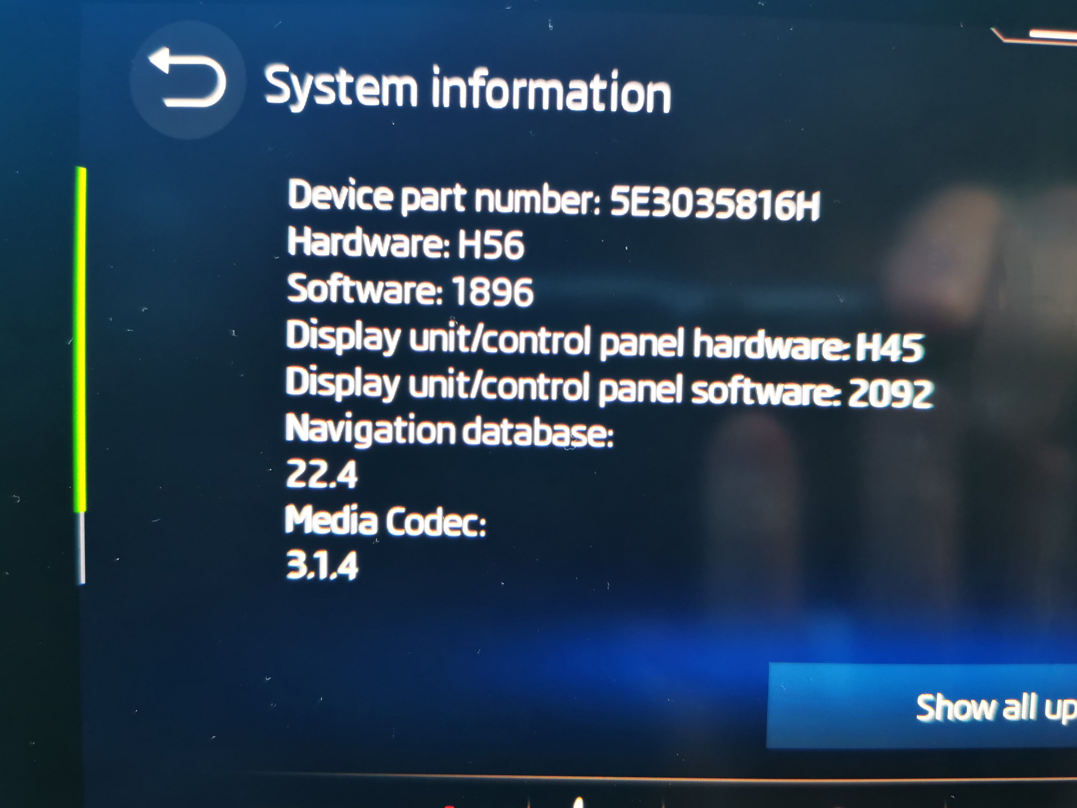

  3. So hi all here I am again to update you software wise. It is now 1year and 3weeks since I picked up my VRS. 9 workshop visits all of which failed to deliver a full working car software. See all my previous posts. Having posted and followed all peoples postings and given my issues, with my engineering head on it was my conclusion that without a new head unit and so a faster processor it would never be right. So I gave up trying to argue and resided to the fact of living with the crappy software. Then out of the blue a call from Skoda saying we have a fix... Mmm I said... Trust us they said. So dropped off at the dealers had coffee biscuits and a chat as I feel like I work there now! On my way in the courtesy car and await the call. Expected a come and pick up the next day.... But no wait.. 4 days later.. Hi its ready and all is good they say... Mmmm we will see I said. Eat my words I must now do! It's a miracle everything works as it should... Finally. What's the secret I ask. Oooh new head unit and processor they say. [see pic] loads up in 3seconds now and after 3 days trying to make it break I can't 😊 finally a working car. Only taken 12 months but.... Thankfully it ok now. So stick with it people keep giving Skoda hell and eventually it will be ok. 🤞👍

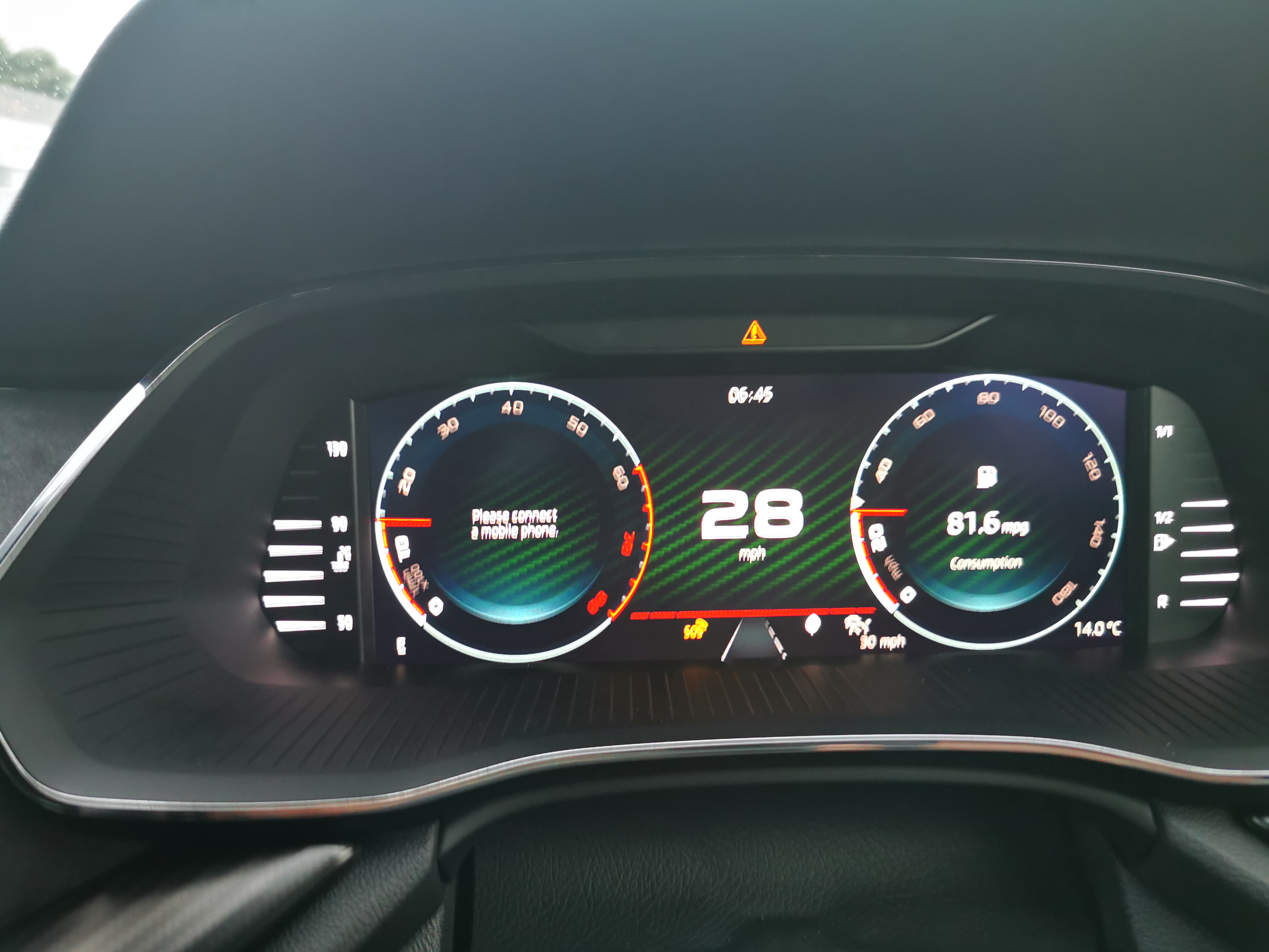

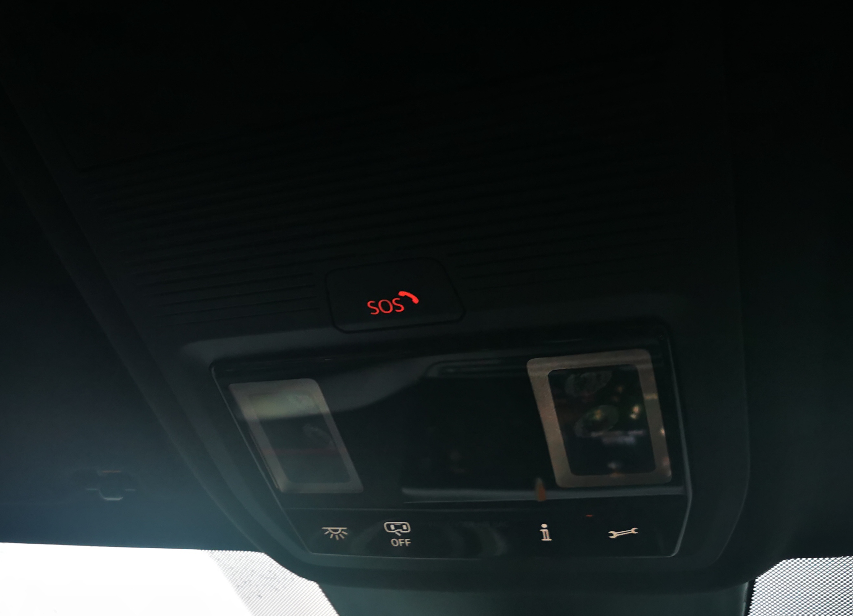

  9. And so it goes on.... Car still booked in for Monday. Skida uk case manager called again yesterday to say she had been in contact with Simpson skoda re all the issues. Ok thats fine talking the talk, but can they deliver? We will see next week. So still having the issues but this morning it went up a notch. 6am wife and myself on our way to work. Screen slow to load up. Nothing new there. But just learned to ignore it now! 15 mins in pop pop pop sound again. 15 seconds or so later SOS system fault on the dash. Which then cleared. 3seconds later random breaking which i canceled by pushing the accelerator. Lucky no traffic in front or behind at that time in the morning. 5 seconds after that SOS system starts to call the emergency service. Sos button goes red. Pushed button to cancel and no response. So i am connected and have to apologise to the person. They then terminate the call and it dials again! This time it let me reset... Thankfully. Have reported this to my dealer and Skoda Uk. Think i will be giving them one shot at this next week. Here's living in hope for a fix otherwise the VRS is going back to them. Keep you u updated people 😢 To be continued.......

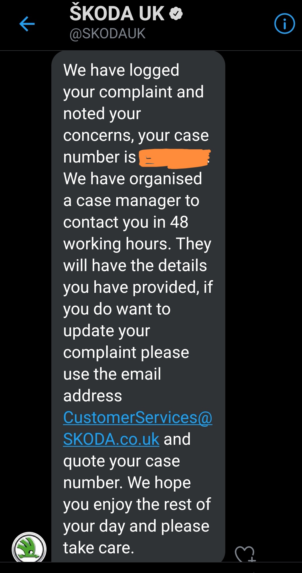

  10. So to update after complaint to skoda uk. Was contacted by my case manager last night. And she wanted to know all the details of my software issues. So i updated her with the whole story and sent files pictures over as well. Needless to say skoda will not confirm or deny known softwsre issues. But thats fine. As i stressed the main concern is the autonomous breaking. Since the last dealer update. Popping noises from the dash as well. There is a post on the forum where it was captured on a dash cam, so i know its the same issue as i have. So from here skoda uk will be working with my dealer i am told,and i should get a call early next week with an update. Which i will let you all know of.

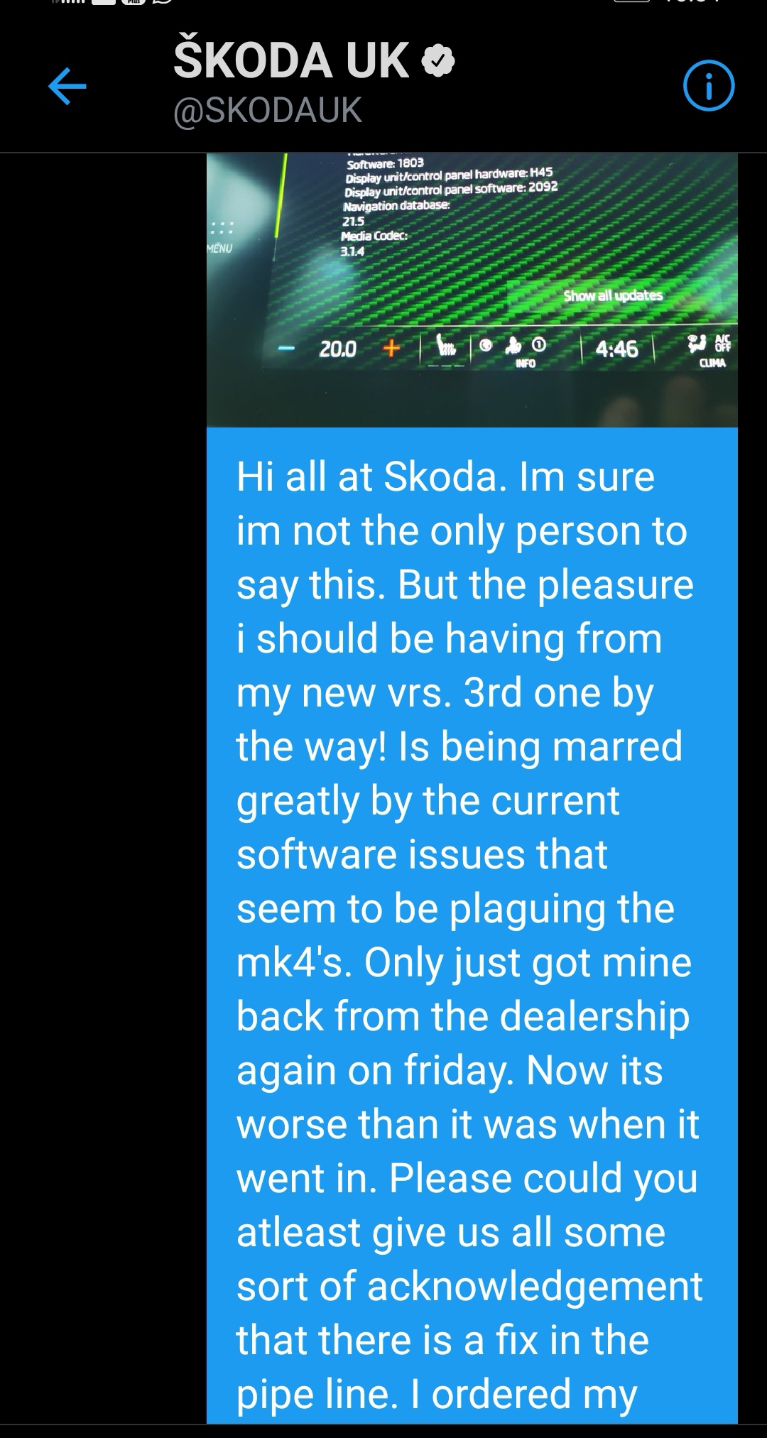

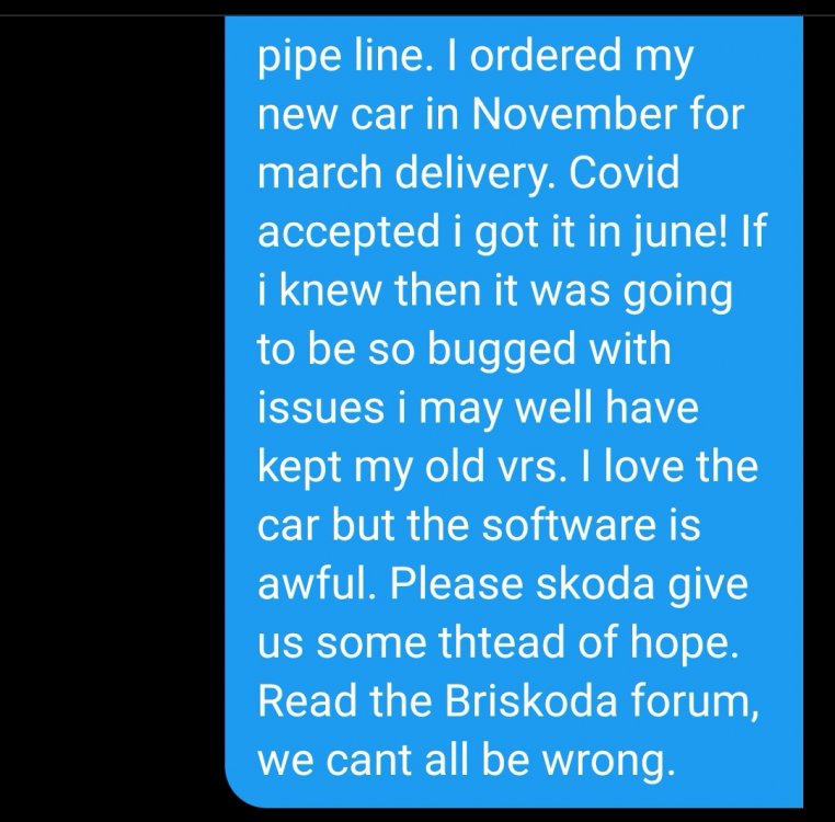

  11. Well here we are now on Thursday nearly a whole week since it was in the dealers. And still worse than wen it went in. Oh and now im getting the clicking and popping issue noted in other posts on the site. So add that to the long list. But got an email asking how i am enjoying my new car from Skoda... It said you can direct message us on twitter....! So I did.. Best someone there hates me now? They got the lot. But i must say they kept up the contact back and forth for all my issues and details. So just waiting for my case manager to call. More people should do this as it may help us all with a fix.

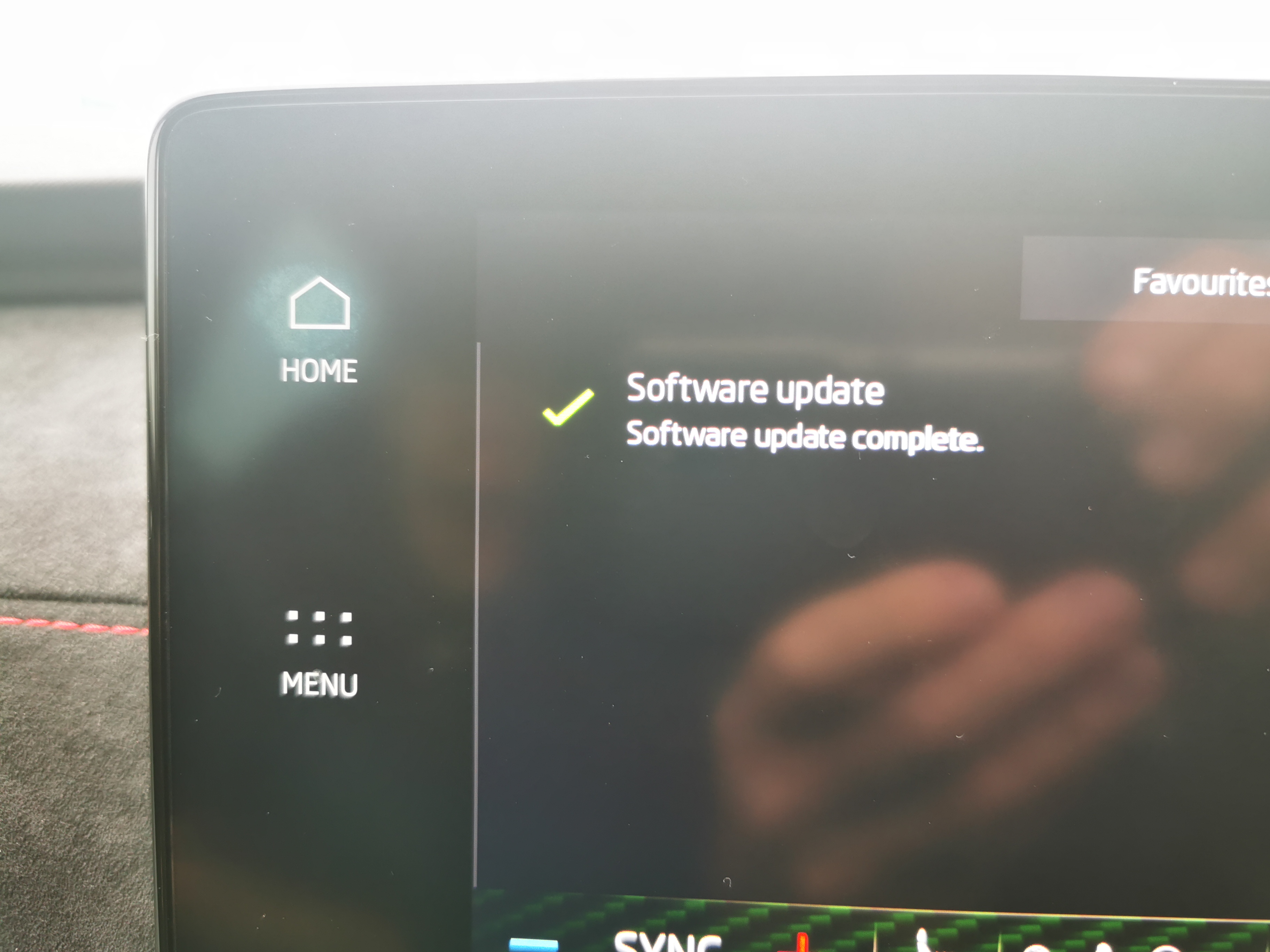

  12. So the continuing sofware saga. Friday all day the car was in skoda Preston for a supposed known software fix. See pics of worksheet and sofware info. Which by the way has not changed since i received the car. So after the weekend of driving i can now report that the software is now worse than when it went in 😬😭 day two after picking it up it was stuck on sofware updating for the 20 min journey i was making. Then said complete at next start up. From this point.... I am now getting the Sos popping noise that other people have reported. So overall it was a waist of a day in the dealership. Am ringing this morning to see what they say.... Keep you posted 😤

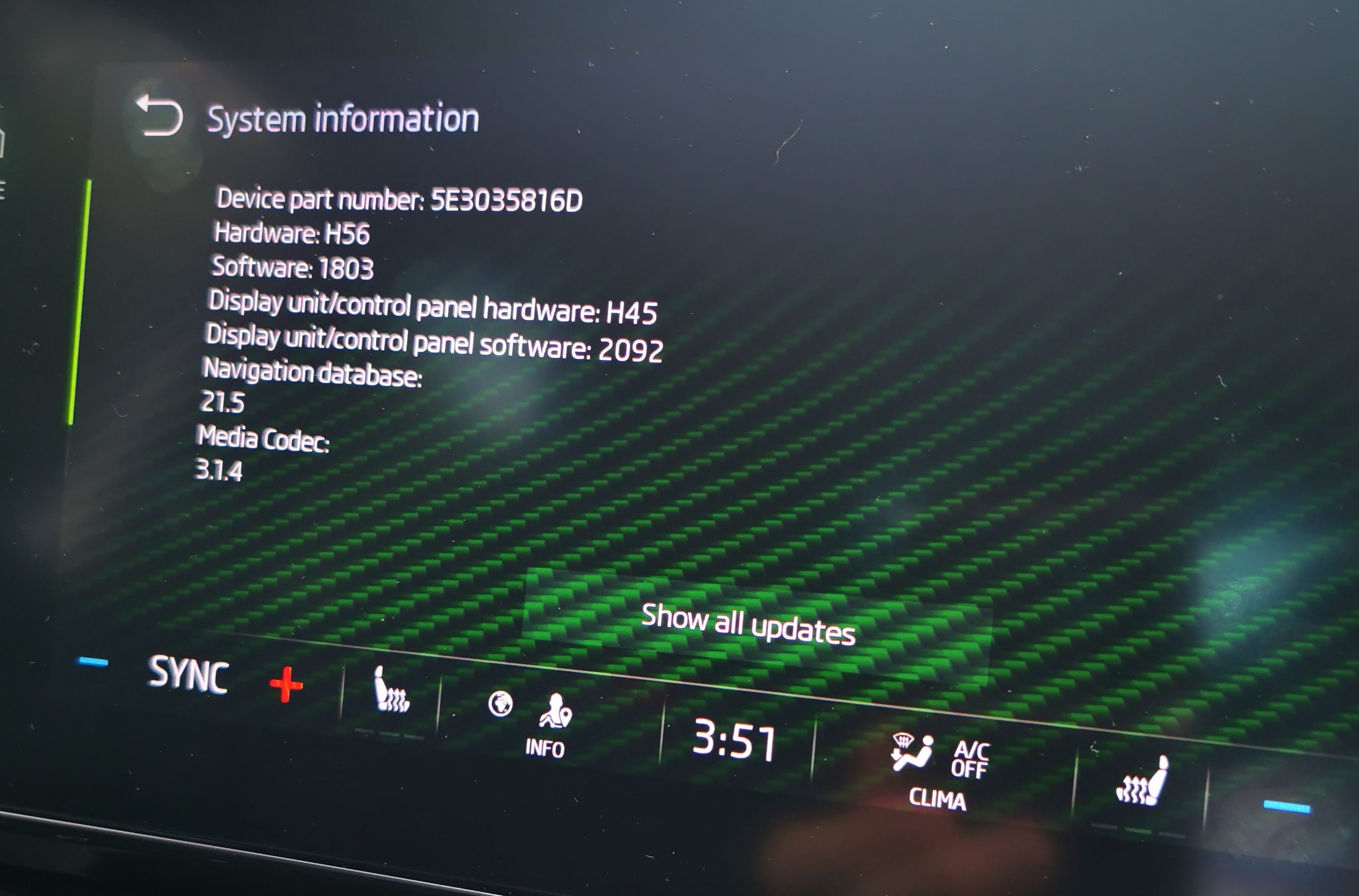

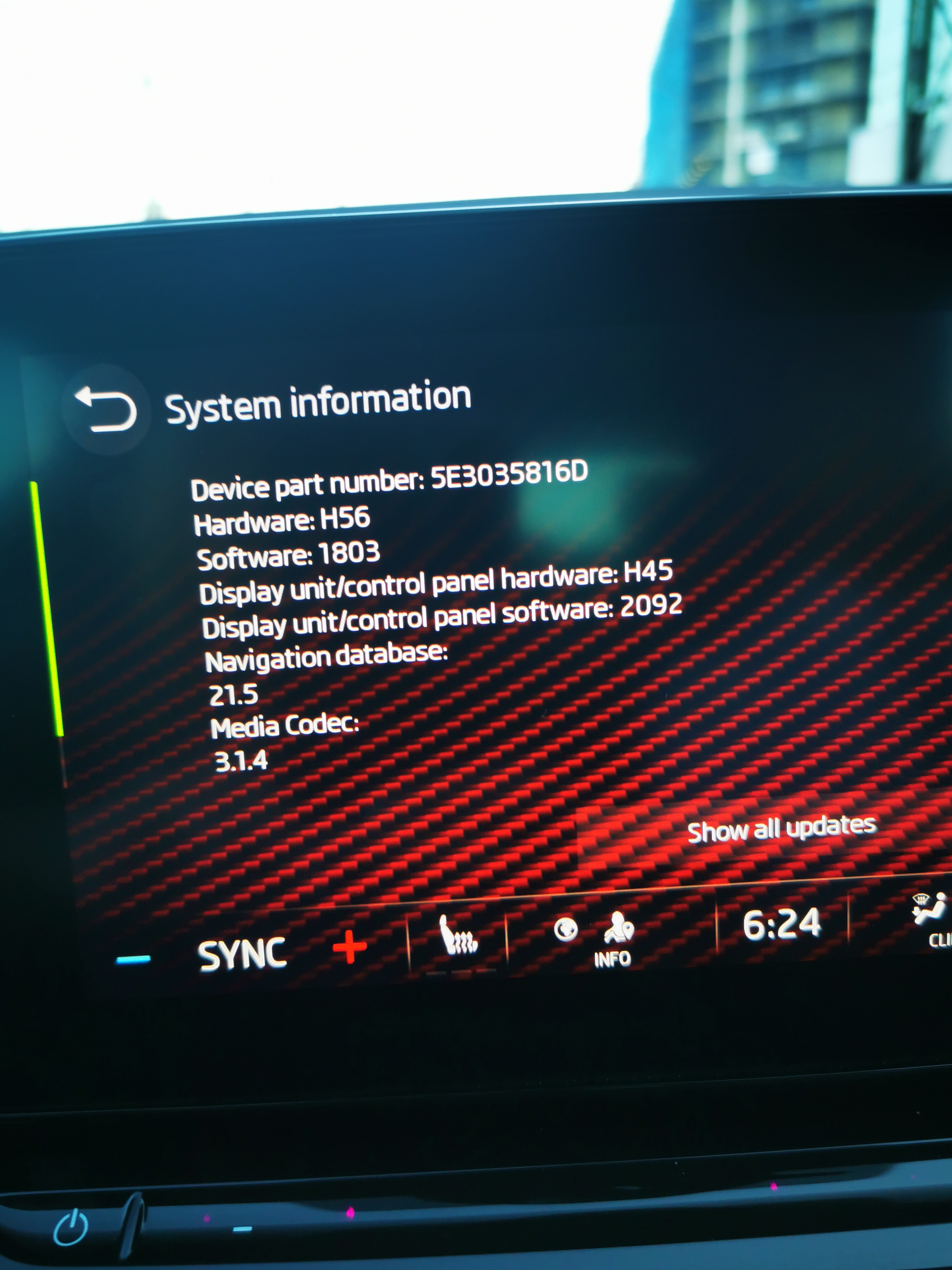

  14. Well as i posted some time ago. I have had software issues that came and went away for a while. But now they are back and becoming annoying. So its into my local dealer Simpson Skoda Preston this Friday and we will see what the outcome will be? This is my current software as we stand today. See pic att... Now i await the fix or not? But will report back when I know more.
  15. To be honest mate. I seem to be getting off very lightly with it all. Hence why its not going back to my dealer for just the sync function not remembering. But they do seem to know about all the issues that are about. But i called them to ask again about the latest version number and they confirmed at this time it is 1803 goodluck with your issues 🤞
