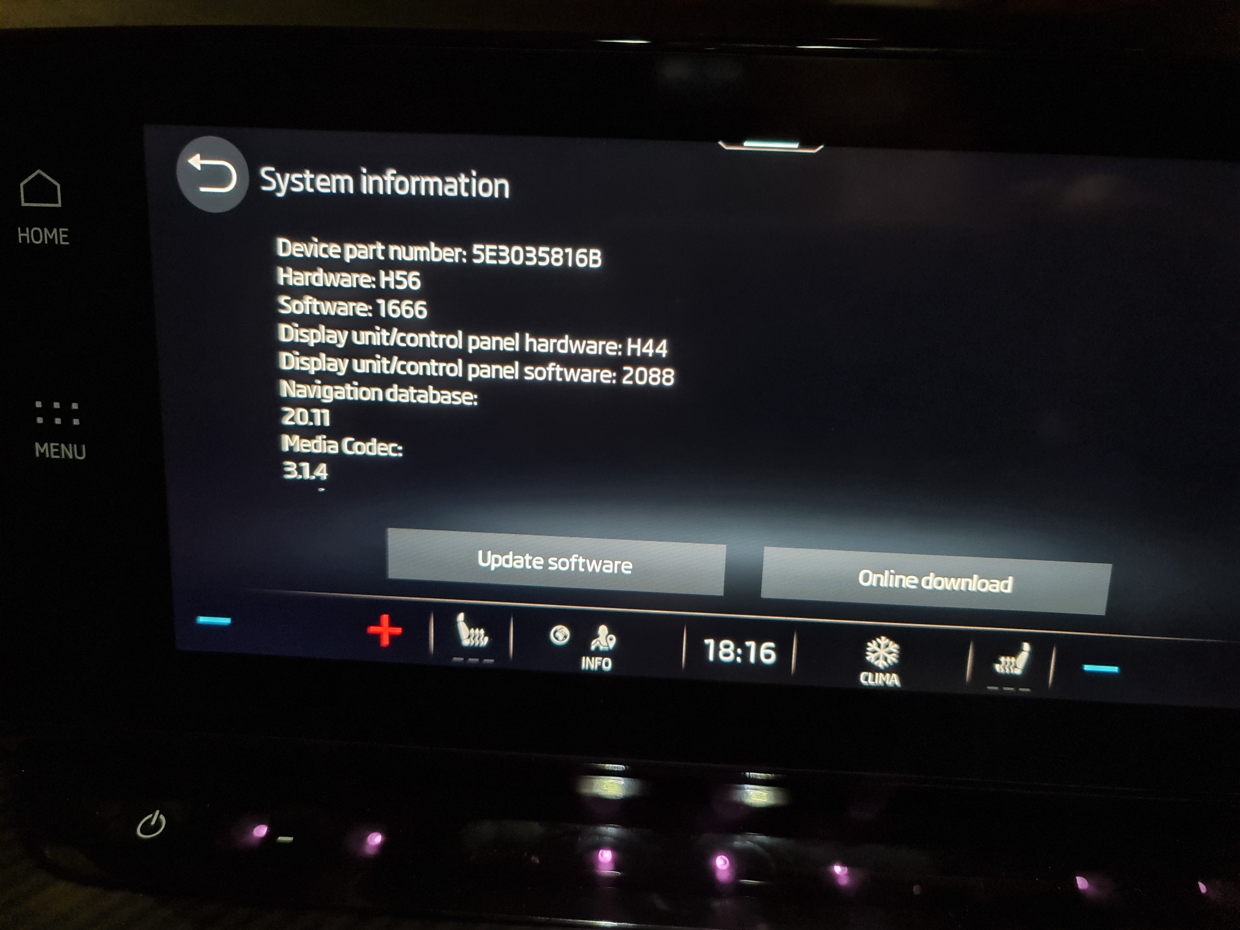

My one week old SE Tech model does the same. It just stays on Searching for Updates with all other options greyed out in the background even if left for say 20 minutes. The only way to get out of it is to stop the ignition and open the door!  Maybe removing a fuse or two will reset things?!
Currently the Software version is 1666
Display unit/Control Panel Software is on 2088
Anyone have anything more up to date?

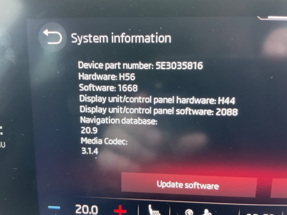

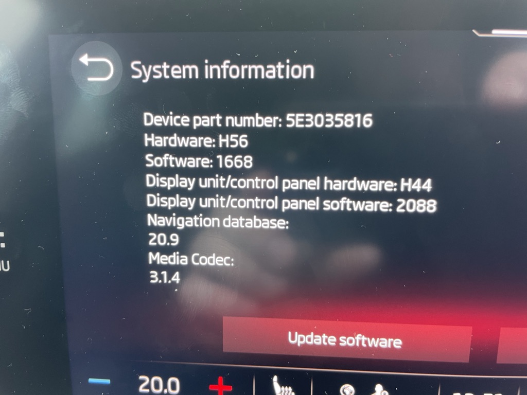

Ok, here is my software info
Seems I'm on software 1666 and others 1688. Will see if I can find anything else out

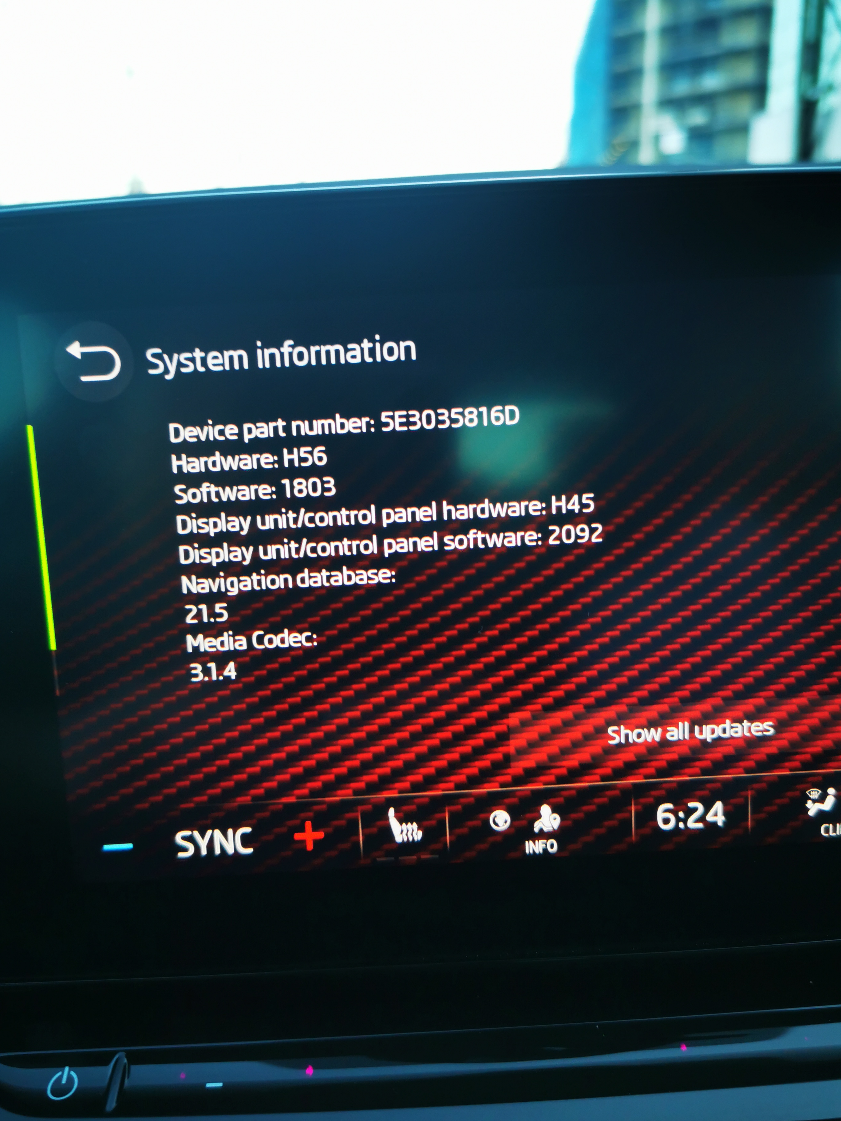

My 21 plate vrs has just updated itself to 1803. Had major issues from delivery 3 weeks ago. Loads of gremlins in the system. Had it booked in but over a few days it has sorted it's self out. Everything is fine apart from the sync control in the clima settings. It will not remember it when i set it on sync and leave the car. My dealer service says it should remember this. But i will live with it for now, till its first service i think. Eveything else is good when you work out the short cuts and set the screen up to your liking. Just takes a bit of getting used to.

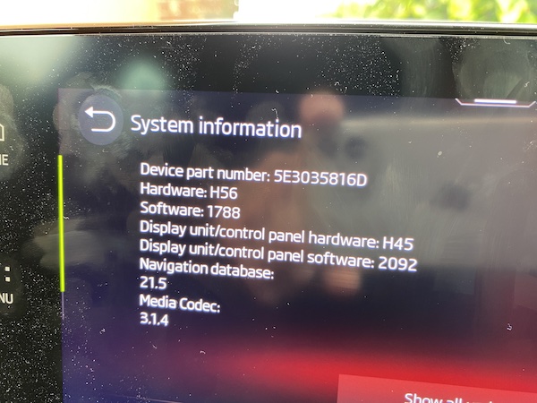

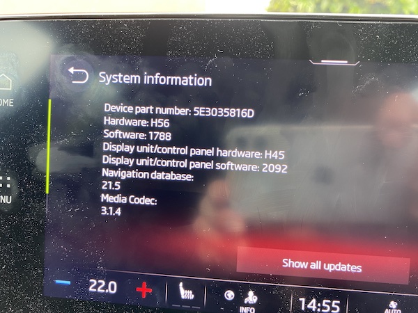

Hmm - well mine (also a 21 plate vrs) has just been to the dealer today, supposedly for a software update - I specifically asked them to update every component that could be updated.  I'm attaching my before and after System information summaries.  Spot the difference if you can!
I'm rather surprised yours has done an OTA update to 1803 - your hardware appears to be identical to mine and I've applied all the updates I've been offered, but I'm still on 1788.
