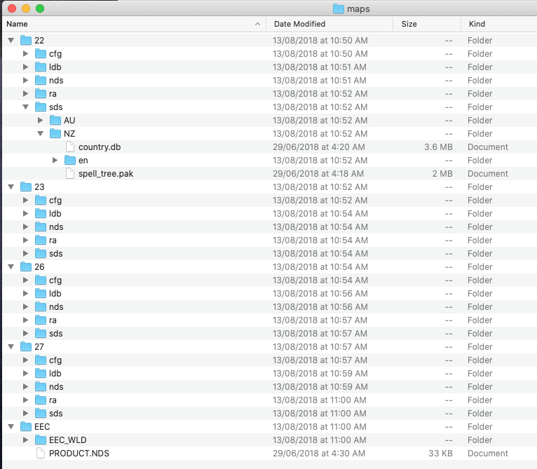

SD card for different part of the world.
Thanks everyone. Just thinking ahead if all else fails, if I took it to the dealer would Skoda be able to re-code the head unit with the appropriate FeC?
Hmmmm. Just went to the update portal and entered my VIN and the program only gives a number of different European maps as download options. Maybe I need to get Skoda NZ to enter my VIN in the local database?
Thank you. I will give that a try.
Thanks for that. Will I be able to do that using my Mac or will I have to use a pc?
Hi All. Relatively new to Skoda ownership, unless you count owning an S110L for a while back in the 70s. Have just taken delivery of a 2019 Octavia MKIII vRS 245. It is an ex-UK car that has very recently been imported to New Zealand. VIN TMBBU7NE1K0044635. Not sure if anyone can help re how to get the nav going in the new part of the world. Car originally had a European SD card (5L0 051 236AH). Got a new SD card from Skoda NZ (5L0 051 236 BD) for “World”. When I load the SD card I get the following messages: “Reading SD Card” and “The source contains the navigation database” However, when I try the Nav program I get “Navigation database unavailable” Anyone have any ideas before I trot off to the dealer? Thanks.
