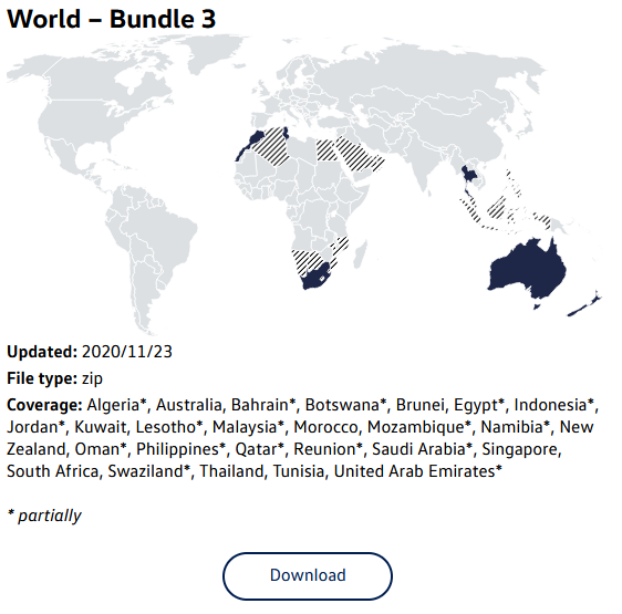

... or visit the VW map update website (the VW and Skoda maps are identical) https://app-connect.volkswagen.com/mapupdates/download/#download
Select Golf from 2017, then Discover Media (VW name for Amundsen), and download World - Bundle 3

Try and get a refund. You don't need that card. Do as PetrolDave suggested. Download the VW World map for free - it's exactly the same as the Skoda map - and use it on your existing card. You shouldn't have to pay for a new map as your current sd card is quite sufficient. Unfortunately, it won't work though until we find out if the car or unit needs any re-coding.
