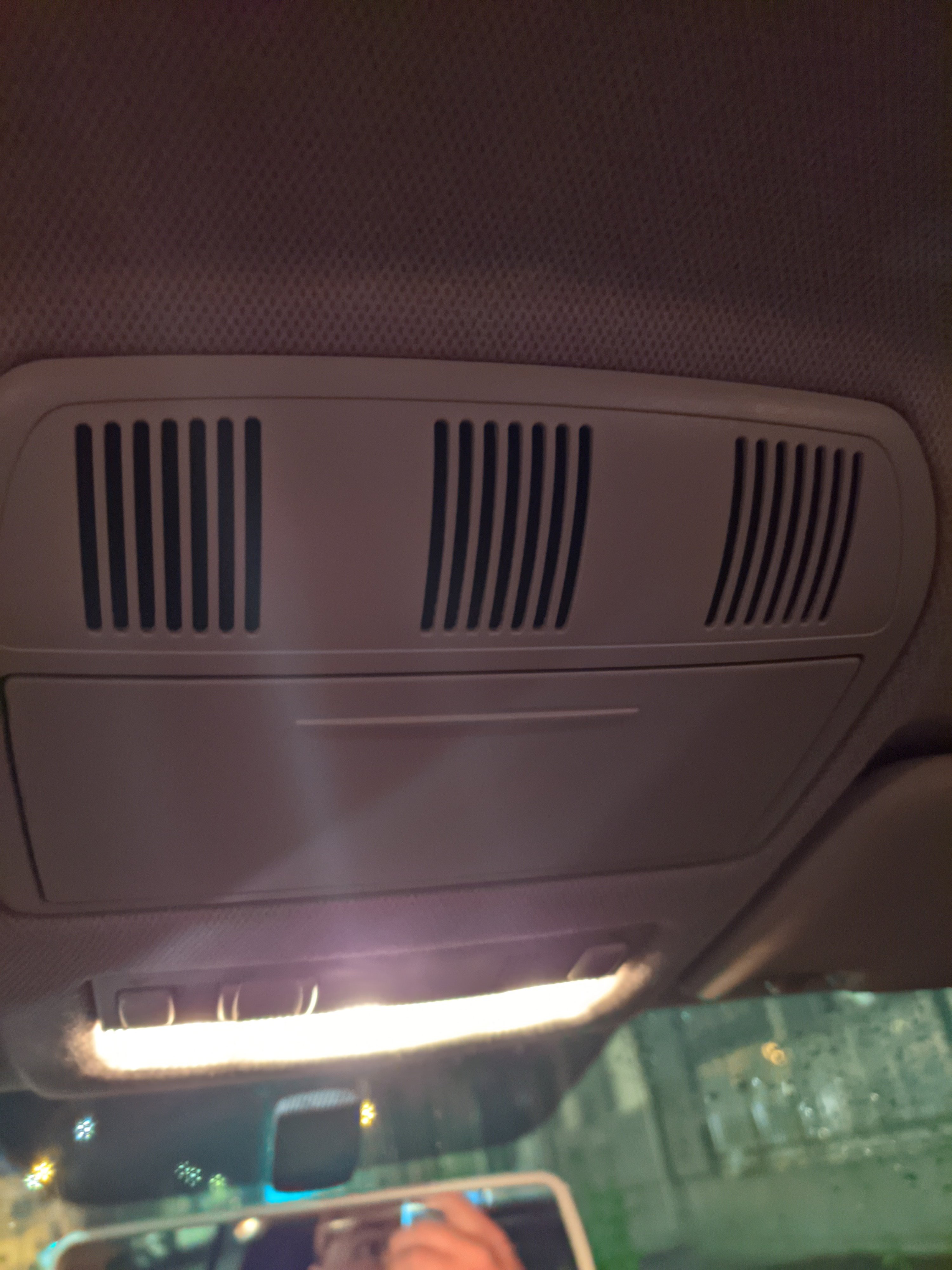

Škoda Fabia III 2016 some kind of bars near the sunglass compartment
I don't have that button. I checked both sides of the car.
@JGrindelWhen I left the window opened, I locked my car and tried waving my hand inside the car, but the alarm didn't go off. It also didn't go off as I opened the door from the inside while the car has been locked via the keyfob. Could it be that my alarm system is broken or something?

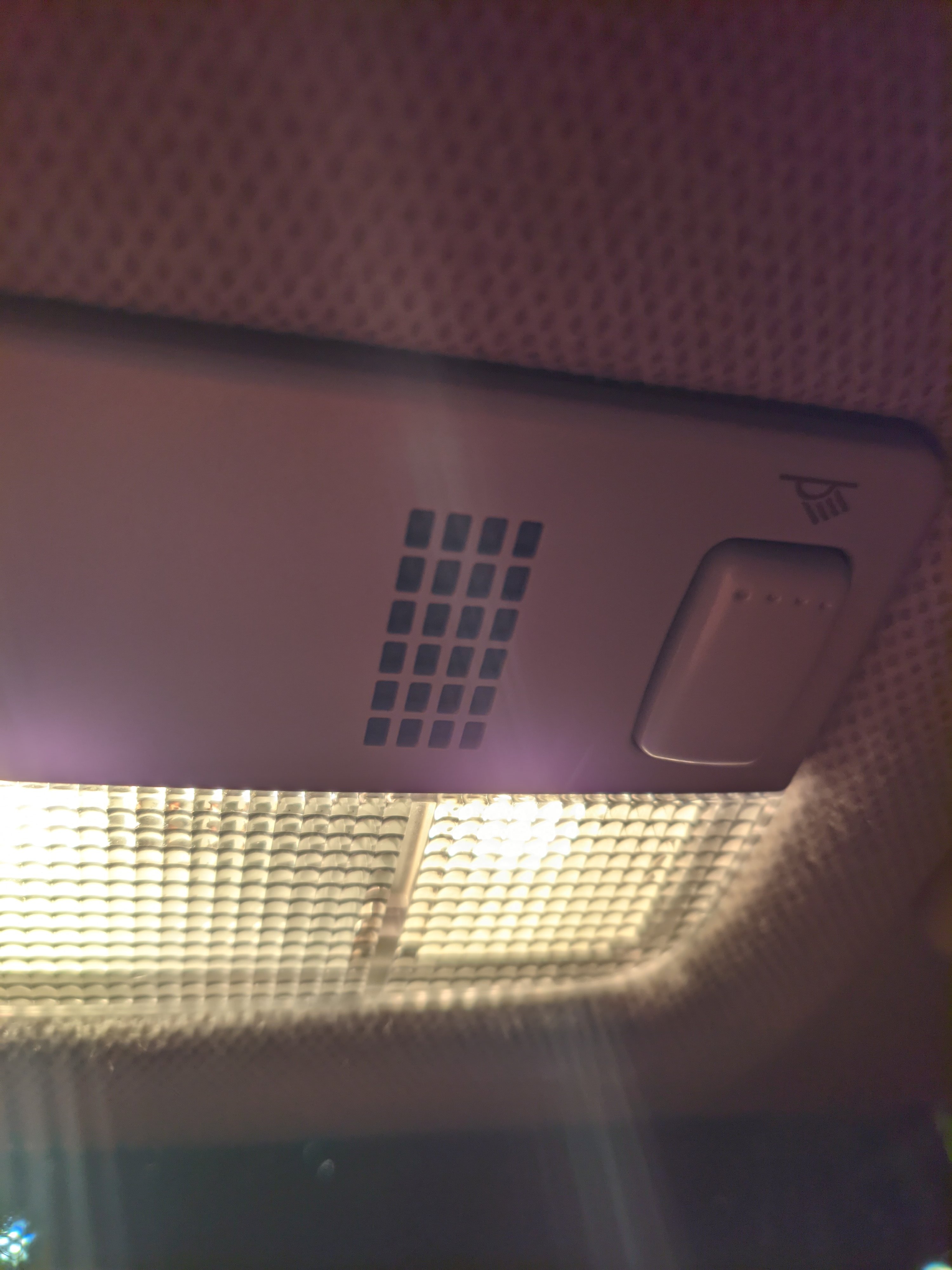

Hi, What are these bars, or whatever that is near the sunglass compartment on my Fabia 2016. Estate? I tried searching online, but can't find any info on what that may be. Thanks!
