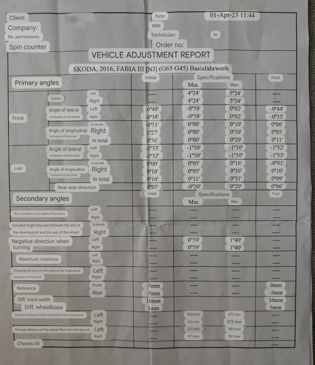

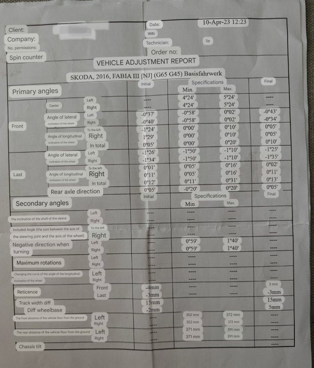

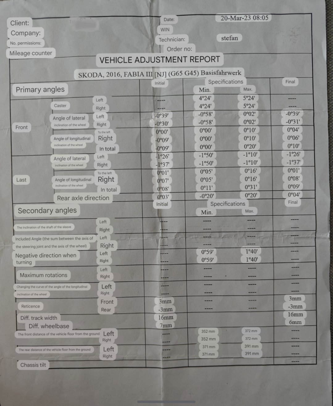

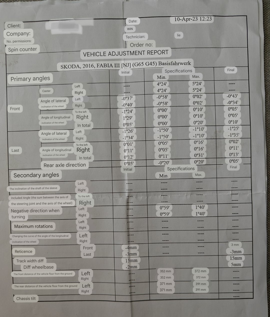

  1. It is a left drive car (I'm from Serbia), I have it since 2021, I noticed the right pull about a year ago when I had my first alignment. The first shop was a real mechanic shop, and the second one was a tyre shop.
  2. I have from the first three alignments, they are in Serbian, so I translated them using Google translate, hope it makes sense. 😅 The fourth alignment was done a week before I bought new tyres. All four tires where the same, with the correct pressures, yes. And the lower front arm and rear bushes should be good.
  3. Yeah, front wheel alignment only. Didn't have any work involving dropping the subframes.
  4. I didn't think that that could be the issue, but now that you mentioned it, during a bit heavier braking (going down from 130 km/h to 60 km/h), I think the steering wheel was pulled to the center for a brief moment, and returned slightly left when I stopped braking, but I will have to test that again (if that is an indication of a brake caliper issue).
  5. Hi, I had alignment done to my 2016 Škoda Fabia 4 times, because the car was pulling to the right, and no change. I went to 2 different mechanics, both said that the steering components looked fine, and did the alignments. Last week I changed all four tyres, and the pull still remains... What could I do next to resolve the issue? Thanks!

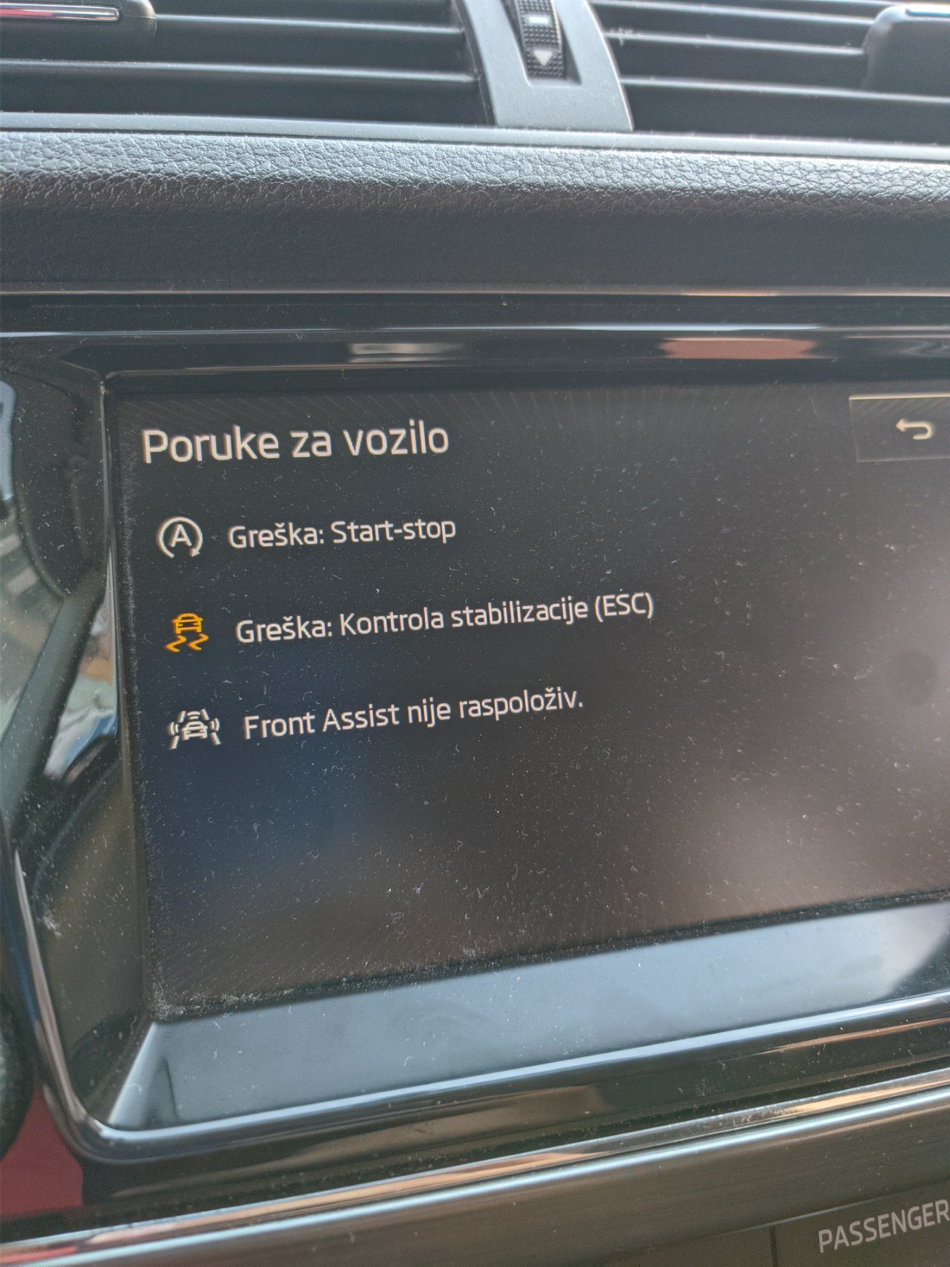

  13. Hi, Today I started my car, it struggled a little bit, but it started and errors just started popping up (Start-Stop system failure, ESC failure, Front Assist unavailable), and the car was idling at 1.1k RPMs, I was unable to add revs. The car is driven every day, it was not cold outside. Start-Stop wasn't working for quite a while, it was constantly giving me a message that the car power demand is too high or something like that, but it didn't bother me. Also, for about 1-2 months, upon starting the car, the message that Front Assist is not available was popping up, not every time, but it happened every other startup, and I ignored it because Front Assist was functional after that, and the message would clear itself (tested it by driving a little bit closer to my friend on the highway, and it displayed the following distance warning symbol), so I didn't think much of it. Today is the first time that this had happened, I didn't leave any lights on or anything during the night, so I don't know if the battery could be the issue. I "fixed" the problem after letting it idle for about a minute, then I restarted the car, and it was all normal, except for the Start-Stop system failure message that stayed. I attached an image and a video showing the problem. Thanks! 0-02-05-8905bbdd0c54a6a3b10b15cea90f862c64360fdba1e853d62efd0e92610a30e4_97d91b1771b4b387.mp4
