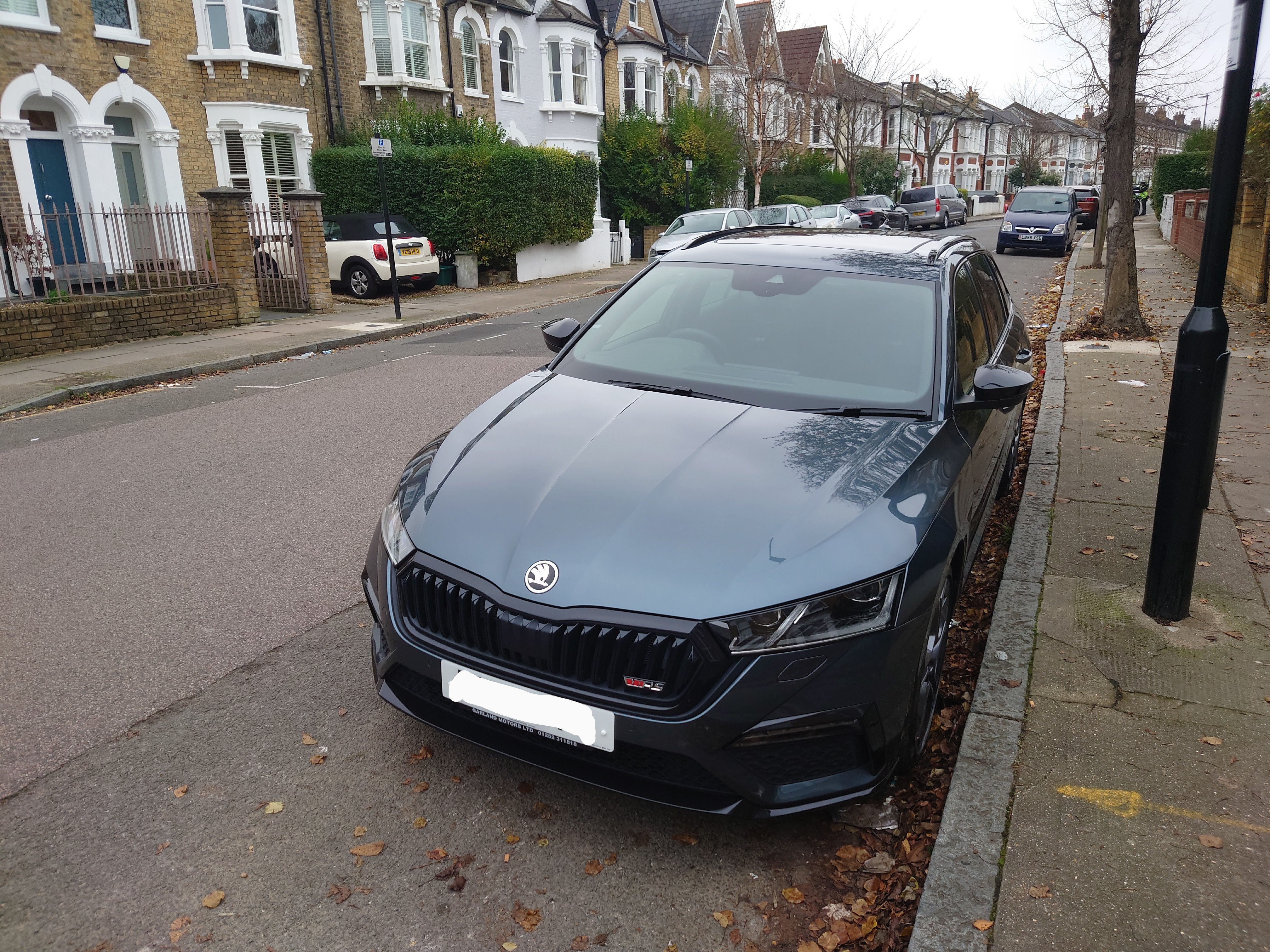

  11. As promised here's the photo. Delivered this morning by Rebecca from Garland. I hope everyone gets theirs ASAP.
  12. Forgot to say, I also bought mine from Garland Aldershot, via Carwow. Rebecca has been good with the updates.
