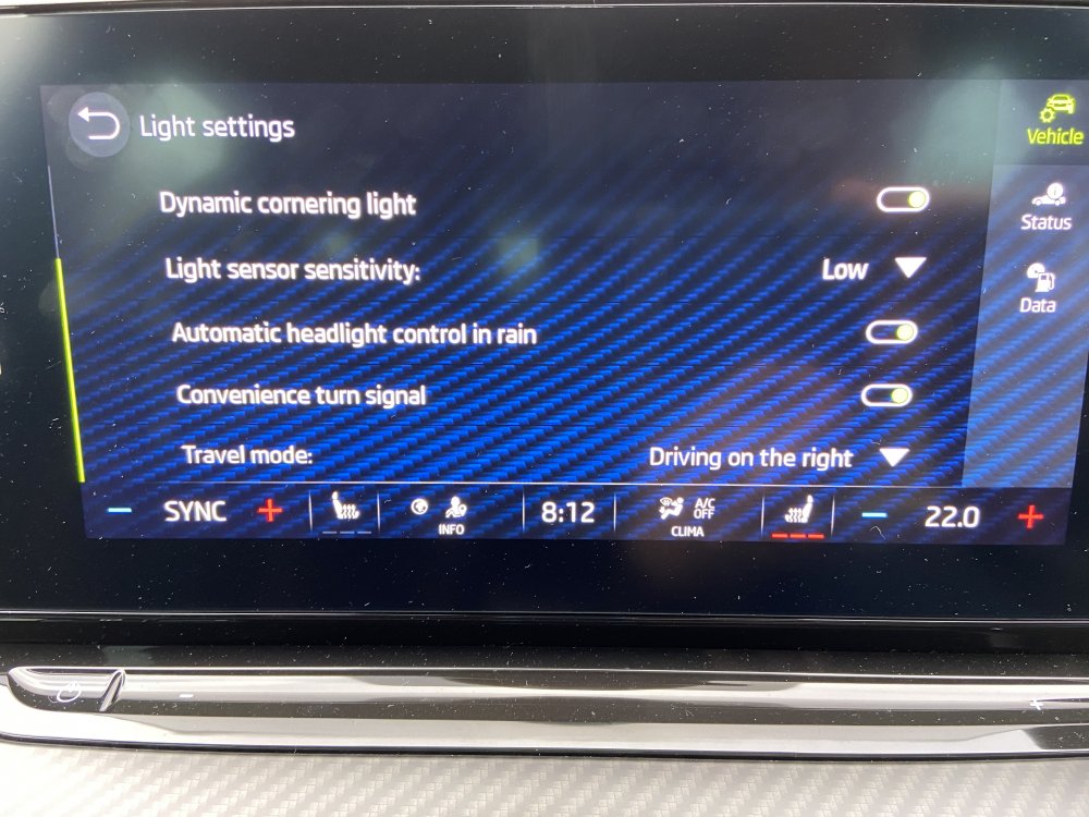

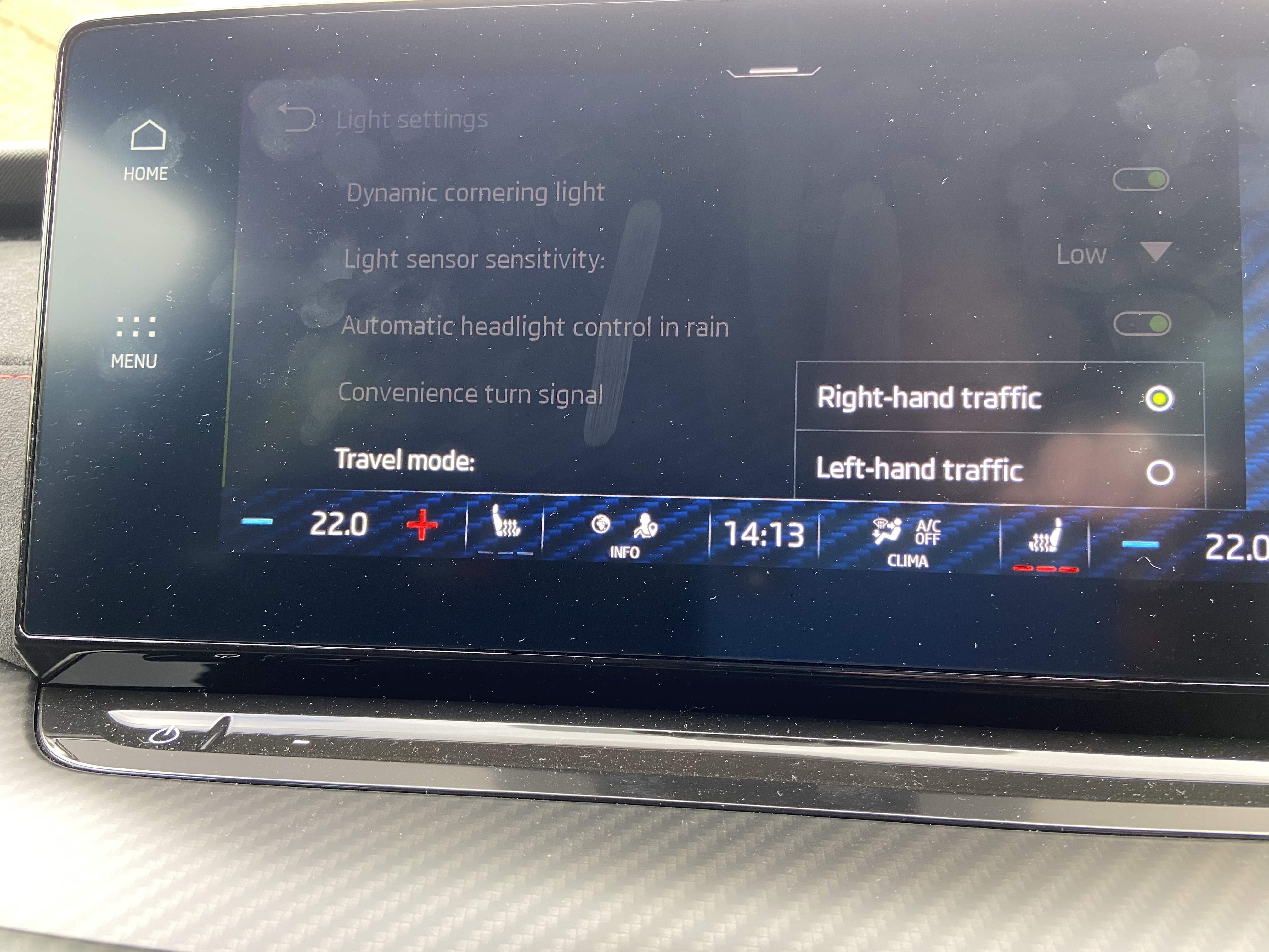

A few times now I have flicked through the settings to find that on Travel Mode it is on ‘Driving on the right’. I change it to ‘driving on the left’ and then forget about it for a while. Every time I have another look it is back to ‘Driving on the right’. Am I doing something wrong?? I’m in Ireland and we definitely drive on the left.

I’ve just had another look and it has changed itself back to Right hand traffic from this morning.

Mine has this option and is stuck on right hand, and cannot be changed to left hand.

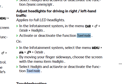

Yes. This option applies only to full Matrix LED lights.

Maybe I said it too fast. I assumed "full LED" applies to MATRIX LED lights. Could be I'm wrong.
No I believe you're right, and I'm wondering myself with future drives on the continent whether the standard LED setup means I have to buy deflectors as there is no mention in the manual about where they are to be placed on the headlights.

Think you were right - reading through the section of the manual again it makes sense that Full LED lights are the Matrix headlights. On my first few readings I assumed there was a non-LED headlight version - but there is no mention of Matrix in the manual.
