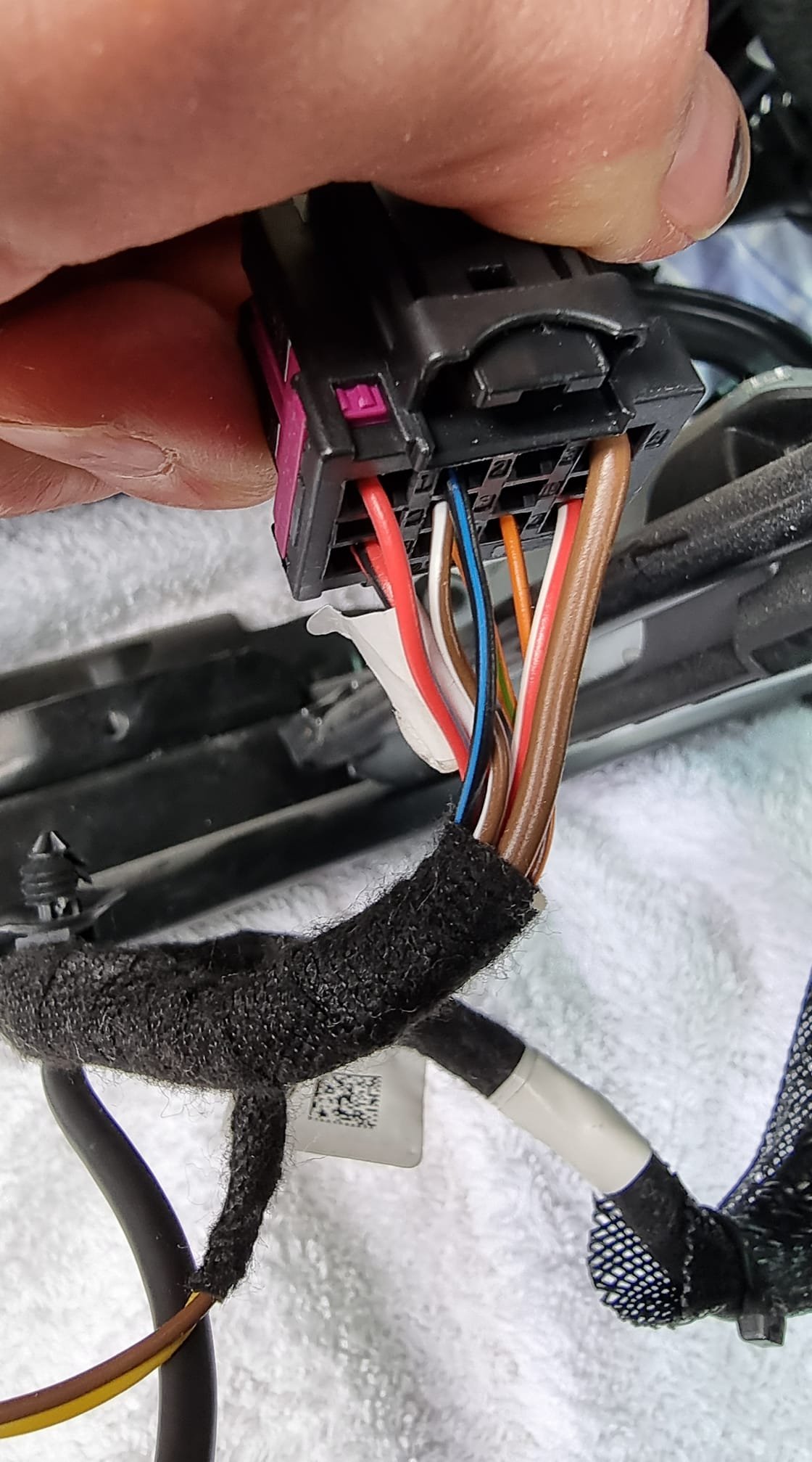

  2. Can anyone decode the wiring out of my sportline front seat. I think the BROWN in 12v mains. But i wonder where the neg is.

  12. My Karoq seat was unpowered but uses the same three connectors and the power and earths wires correspond for the new seat but no power yet.

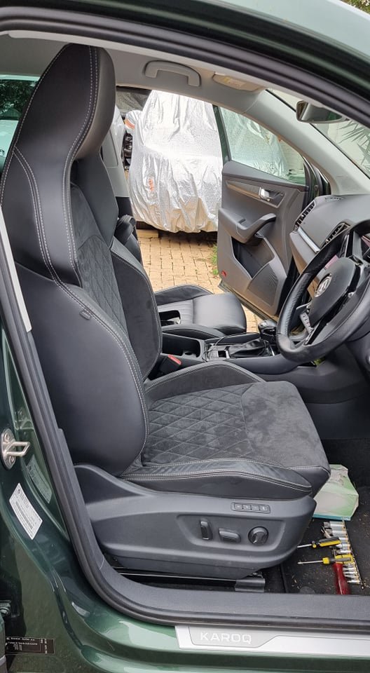

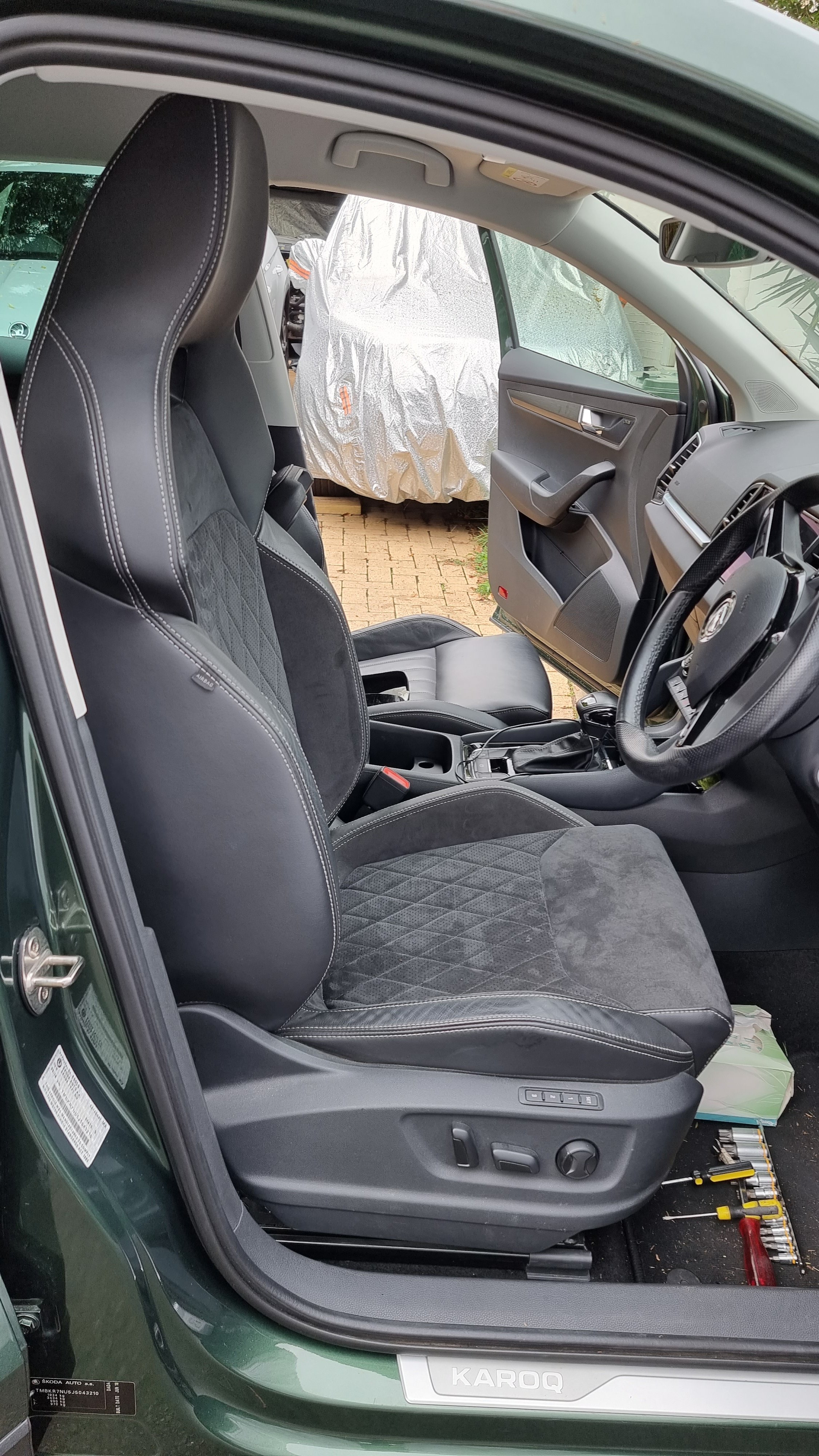

  13. Hi, (Im sticking a powered Kodiaq drivers seat and passenger seat into my Karoq) Would anyone know the exact fuses type, size and rating for fuse #45 in the right hand glove box fusebox. I'll still need coding for the memory function on the seat, but Im hoping I just need to pop the fuse into the correct position for basic powers functions for now!
