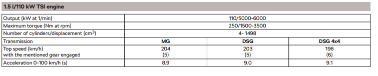

What I can see is this for my Engine in teh manual:

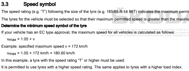

I can further see this calculation in the Wheels and Tyres Workshop manual PDF:
So by my reckoning for my car (1.5TSi DSG) Vmax is 1.05 x 203Kmh = 213.15
Maximum speeds for the ratings (in Kmh) are:
H = 210
V = 240
W = 270
So that would say that V or W are fine.  Like I said - I just can't find the document that shows the accepted tyres.

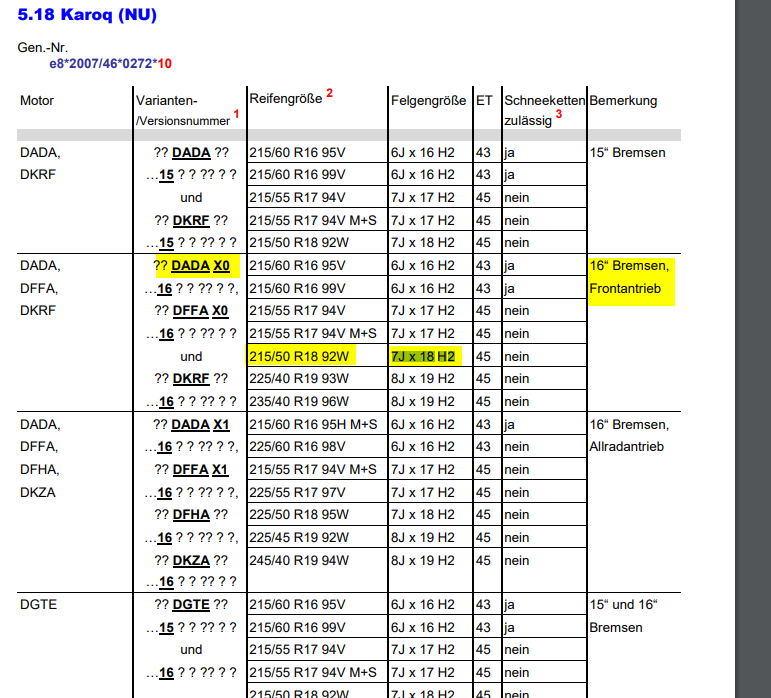

I have my Type Approval Number (E8*2007/46*0272*10) but can't see a way to actually look at that either  - there seems to be no database that one can look at.
I guess I will have to email Skoda UK and ask them if V is approved for use based on my findings above and see what they email back to me.  I guess I could also ask them for a printout of the vehicle type approval.

Okay so for anyone who's interested 🙂
You can search for your car's type approval document by googling the type approval number on your V5. It is in German but can be translated.
For the karoq with 18" Alloys (7J/18/H2)
I have found the type approval document and for my variant (ACDADAX0 - also obtained from your V5 Document) and 7J/18/H2 the speed rating in the type approval says "W" so "W" it will need to be!!
This is the type approval: https://az749841.vo.msecnd.net/sitesdede/alv1/aa547632-9b71-4e0e-8383-c3d830d45035/Serienreifen_Skoda_2020_02.97fa7a1abca18d92b2053b4faaa80588.pdf
It covers a load of models and years!!
My car is on page 351!!

Interestingly - it also says "Schneeketten Zulassig  NO" which by the letter of the law you are not allowed to use snow chains on these tyres / rims and if you do I assume you would be invalidating your insurance.
