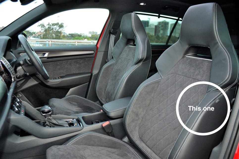

No, its deployed, and I can just have the seat trim fixed.
;Thanks for the explanation, did any of the other airbags deploy also the seatbelt pre-tensioners?
What type of impact triggered it or them?

I have acquired the two seats from a wrecker to go into my Karoq so I'm only dealing with the one passenger seat deploy. the drivers seat did not deploy. I now have a UK dealer i am dealing with and all I need now is to get these powered seats, well... powered and working in my non powered seat 2018 Karoq.

Here's a shot of the new drivers seat in position  (was just making sure it fit before purchasing the seats yesterday.)
Fits the same and even uses the same connectors. Awesome!
