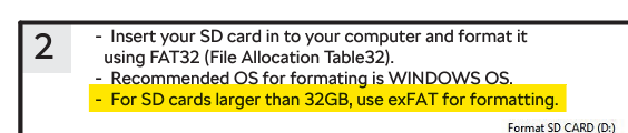

  3. It should be MIB2. As per below it seems that SD larger are acceptable. What is the difference between a Skoda branded cars and my new SD?
  4. Hi everybody. Few days ago I downloaded the latest updated map file from official Skoda site. To avoid to modify the original SD card I also bought a new one (Kingston Micro SD 64 GB). Then I followed the instructions available on official site (format the SD card and copy the new file). When I insert the new SD in my Skoda the result is an error message " Error SD - no file map found". But if I compare the original one with my new SD, the files are exactly the same. Of course when I replace the original one all works properly. Somebody knows what is the problem? Thanks
